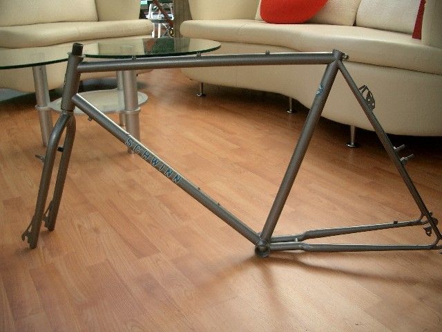

http://forums.mtbr.com/vintage-retro...set-69338.html
I forgot that I asked this question on mtbr several years ago. This thread addresses the welded mountain bike frame set from 1983, but no more information about the lugs and fork.
The frame set pictured on mtbr has different decals than both mine and the one in kingsting's catalogue page above. This could mean that there was quite a bit of variation in the particular frameset.

I forgot that I asked this question on mtbr several years ago. This addresses the welded mountain bike frame set from 1983, but no more information about the lugs and fork.
Schwinn did a lot of goofy things in the post-Chicago/pre-bankruptcy era. Paint and decal variations were common, especially when dealing with a bike model that came out of two different plants. Sometimes, you weren't sure what you were getting until you opened the box.

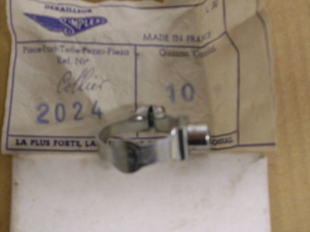

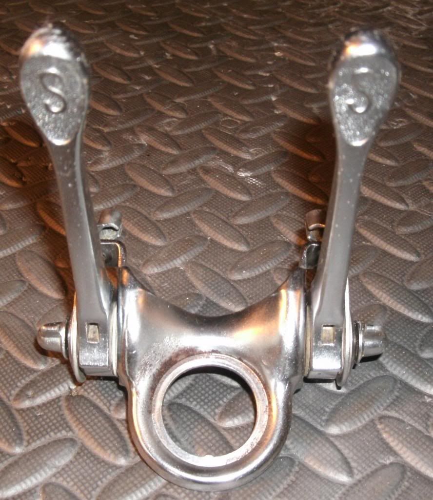

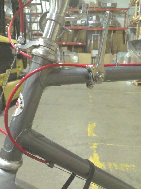

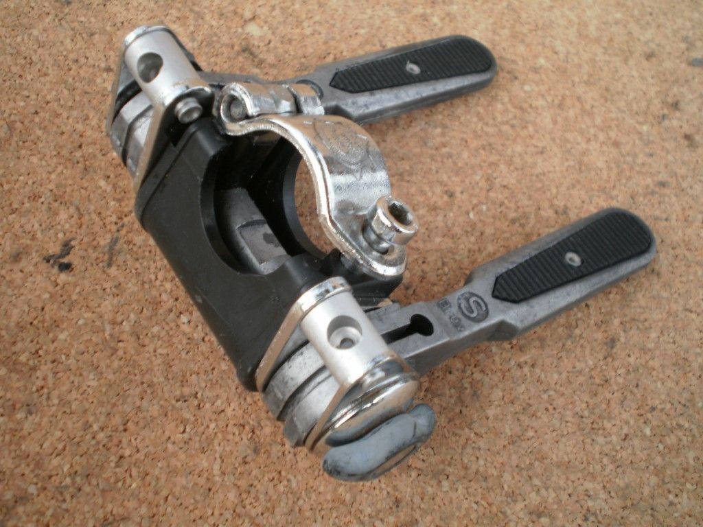

The lever actuated bottom bracket generator is complete.
I took a lever from this Schwinn Varsity stem shifter:
A pair of side plates and cable stop from these Simplex stem shifters:
Added some Shimano shims and spacers:
After some drilling and filing, attached everything to a Simplex single lever clamp:
and ended up with this abonination of a lever assembly:
A cable runs from the top tube to the remaining downtube stop, continues to the the BB guide before ending at a clamp on the swing arm of the generator:
Pull the lever back...
...to disengage the generator:
In reality, only one set of levers and plates needed to be cannibalized. Because this is a Schwinn and I liked the looks of the Varsity levers, I wanted to find a way to incorporate them into the build. I wish I could switch the DuraAce lever for a Varsity, but that is well beyond my abilities to machine things with a file, drill and vise. It least that part is Shimano controlling Shimano - if things like that matter. :-)

It pays to know how to fix things. These lights and generator came in $45 box of parts from eBay. The lights needed to be rewired and their internal mounting brackets needed new rivets. The stiff generator needed to be taken apart, oiled and put back together. After that, everything worked the way it is supposed to and none of it rattles.
(Also note the NOS Schwinn feather decals on the downtube. These likely would have been white originally, but I preferred red.)
Replacement LED lights and a voltage regulator from Nicelight are on the way for all three lights. If the claims are true, the new bulbs will drop right in and work with with the generator.
I have my eye on a French fender mounted taillight rather than the side mounted Union. This will fit better once the panniers get added.

The lugs on that frame look look a lot like a Schwinn High Plains frame we have at the Newark Bike Project.
Paramount1973 is offline
Old 12-31-12, 11:39 PM
jjvw
MFA
jjvw's Avatar
Join Date: Apr 2006
Location: Denver
Posts: 1,186
Bikes: 1973 Italvega Nouvo Record; 1965 Hercules; 1982-83 Schwinn Mystery MTB
How do the decals, downtube cable guides and the headbadge compare? Does it use a 21.1mm BMX stem rather than a standard 22mm? Japanese or Taiwanese made? All of these details separate mine from the '84 and after mountain bikes, including the High Plains. However, several of these later bikes look very similar. My thought is that those frames might have been modeled after the one I have (specifically the bare frame/fork offered in 1983 with all its apparent variations) - though I don't pretend to have a prototype.
