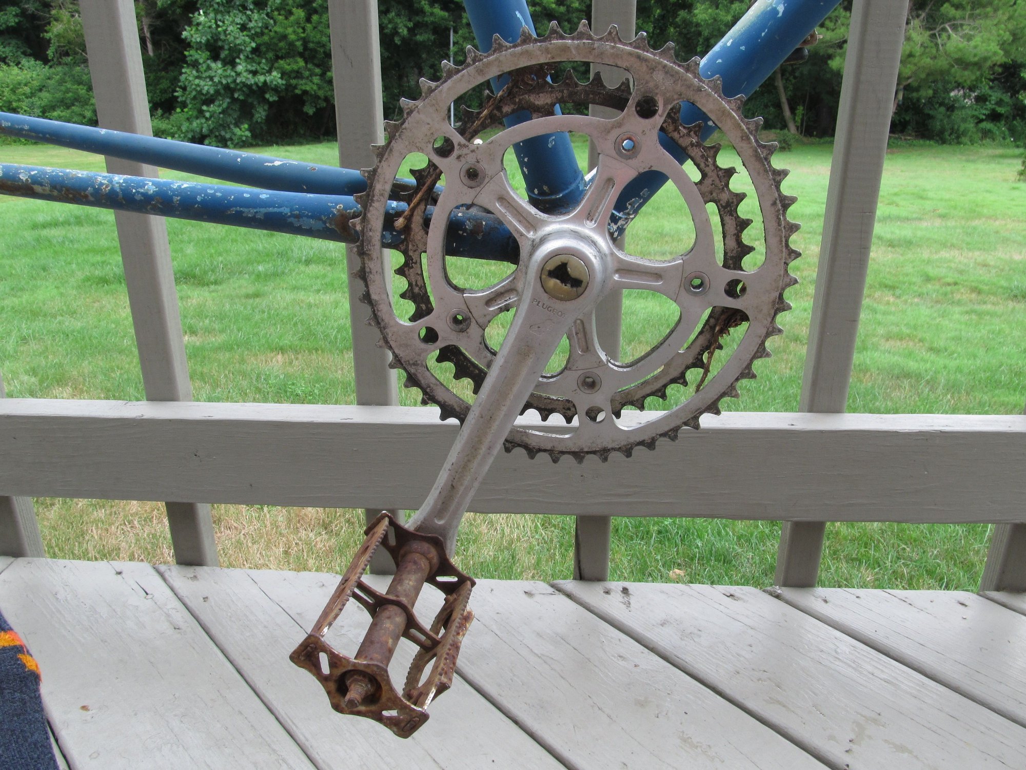

Sad state Peugeot; Anything salvageable?
Found this sadly dishonored junkyard Peugeot and felt compelled to give its' last respects here where might be appreciated for what it once was. Appears to be an early 80's, and some of the details makes me wonder if this was a higher end "P" model? Anyway, I'd lover to hear any comments , guesses of the model, and suggestions of what to do with it. Is anything salvageable? It's been fun just reading and researching Peugeot.

More pics in memory of...

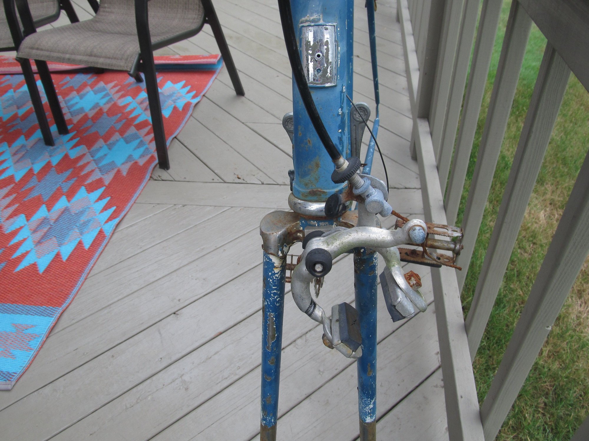

So sad...

Sure, crankset and stem are both sellable, as is bottom bracket if it is OK. Of course, it has stuck stem written all over it. Saddle may be sellable too (low price). Some people rebuild them. Seat post may be stuck too, if not, put in your parts bin or donate. I'd save the shift levers too.
You will probably have to cut out the stripped dust caps.
Since I keep a rust bath going for small parts, I'd save the headset too.
Rescuing those parts will not only bring you some $$, but you will be helping someone out with their bike restoration. Parts live on to provide value to others. Win/win.
Got to love the knot on the end of the shift cable......

Reference point, I got over $200 out of parts on this old UO8 with a large crack on the steer tube. Still have the early Mafac brakes which have value too. I bought it mainly for the non-original Belt leather saddle, which is now on my Sekai Professional 4000.
Bike was in the scrap pile when I found it.
1963 Peugeot UO8 by wrk101, on Flickr

Looks restoreable to me - But you're certainly looking at a repaint - And a fair bit of parts scrounging
That's IF you can get it all apart OK - Stem, seatpost, etc.
The chrome socks will clean up pretty nicely with an oxalic acid bath ...........

I have never seen the front brake adjuster used in the back like this. Clever, if you are absolutely in a pinch. But not clever if you have any time to source the right part. If the seat post and stem come out, the frame doesn't look too bad if you are up for painting it or selling it.

Appears as if it may have begun life as a manner of PFN10.
1980 U.S. market brochure page -
The machine's stamped steel pedals appear below the balance of the cycle. They look to be replacements. Specification is Atom 440.

The saddle is missing the shackle clip and bolt, but you can get those from Niagara cycle supply and other vendors. I'm not sure anyone would be able to get the replacement bolt back into the saddle without further damage to the leather, though. Pretty easy to put new leather on the frame, of course.
Is the frame bent? It looks like the bike had a head-on crash that bent the fork and cracked the frame paint at the usual spot, but I don't see frame damage.

+1. And I'd be tempted to see if I could save that frame set if it were my size. Peugeots of that era tend to be rather nice.

Pfn10 ?
The machine's stamped steel pedals appear below the balance of the cycle. They look to be replacements. Specification is Atom 440. -----
+1 too Early 80's
I was going to call PSV-10 or something like that, with a replacement fork
The fork crown threw me. I thought that it was a replacement from the early 70's until you posted the picture.
Worth stripping and cleaning up. It's on a par with the older PR-10 models. Vitus 172 butted main tubes, same wall thicknesses as Reynolds 531 used on most production bikes: 1.0mm x 0.7mm. About the same after brazing strength too.
@rhm on closer examination, the fork is bent at the base of the steerer and maybe the crown too. The frame looks OK.
Steerer should be replaced if the crown is OK because Peogeot (and Motobecane) used cheap straight gage tubes with a split sleeve brazed into the bottom for reinforcement. Wouldn't recommend straightening it.

Fork looks bent.
I'd at least make an attempt at saving that frame. I bet you can do it.

Crank arms look about 15 degrees off. What's up with that?
The left one is Atlantic Time Zone.

Wow, thanks for all the feedback, you guys are inspiring! Yes, fork is bent (too bad because that crown is too cool) & there's a rust hole on non-drive stay. Frame & head tube doesn't appear to be bent but I'll know more as I proceed. Non-drive crank inside square is rounded so that's toast. Somebody drilled and screwed a bolt to try holding it to the BB, lol.
I'm going to use this as a learning experience and relive my youth. Had a couple decent race bikes in my younger days, collected dust, took up too much space, gave them away to a young kid who shown appreciation for what they were. And here I am now full circle looking to put together an old lightweight steel machine to ride again.
So far, took the bars off, pulled the cranks and bb came out no problem packed full of grease inside. Started chipping off the respray paint to reveal the cool original blue color trying to see of the PEUGEOT lettering was left on. We'll see. It'll be fun!
