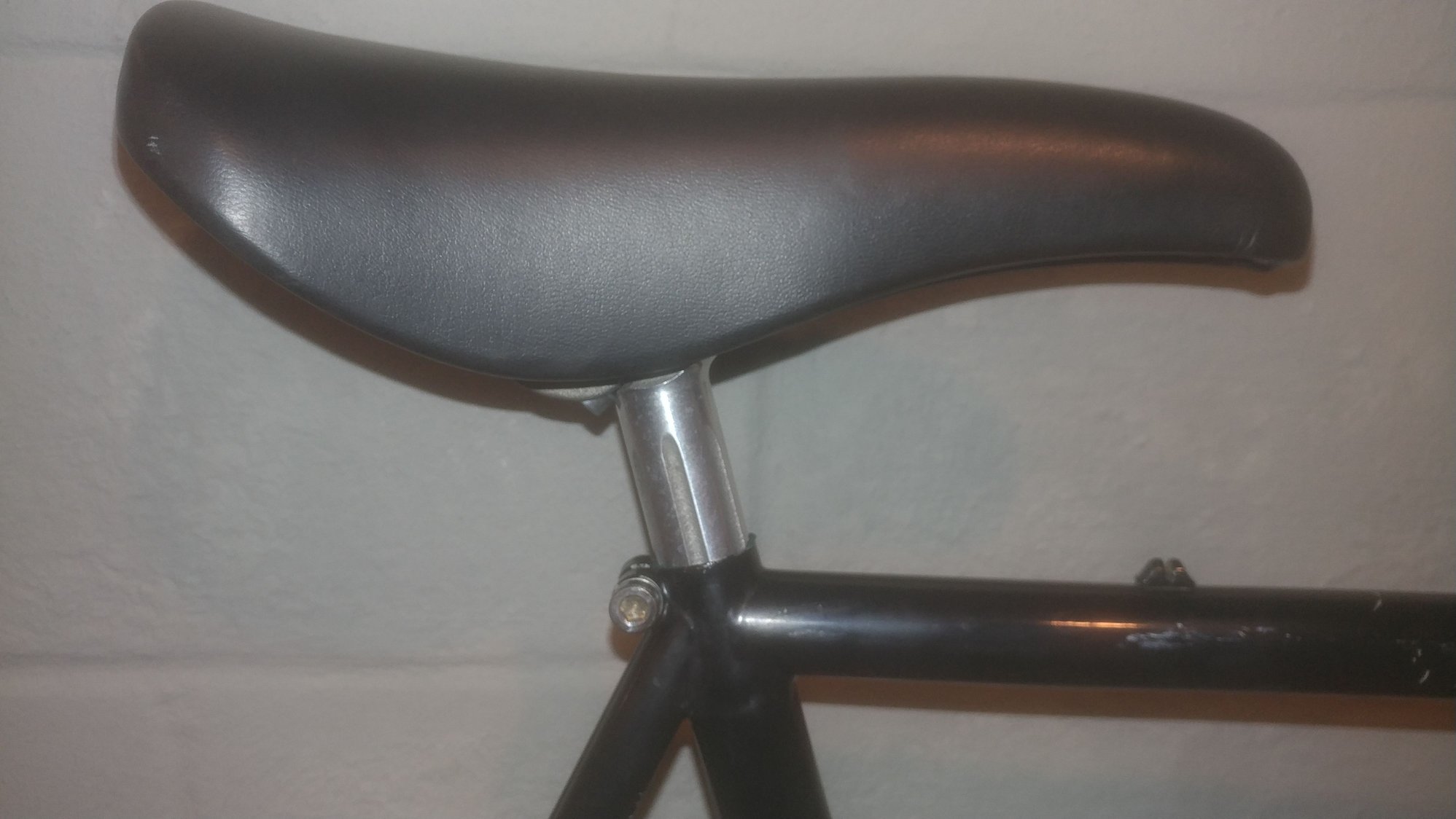

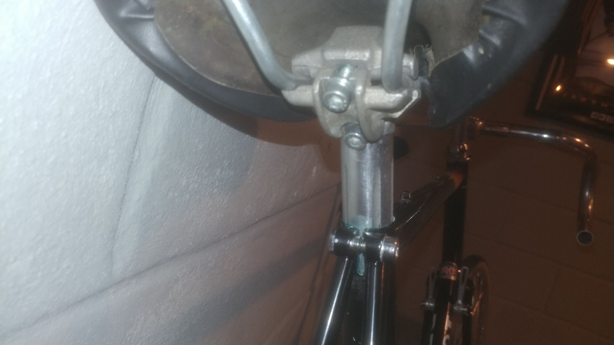

Pretty sure that I have a 25mm seat post. Will check id OP is interested.

Thank you for the offer @randyjawa - I've just checked the frame though, and it's a 24mm fit, not a 25.

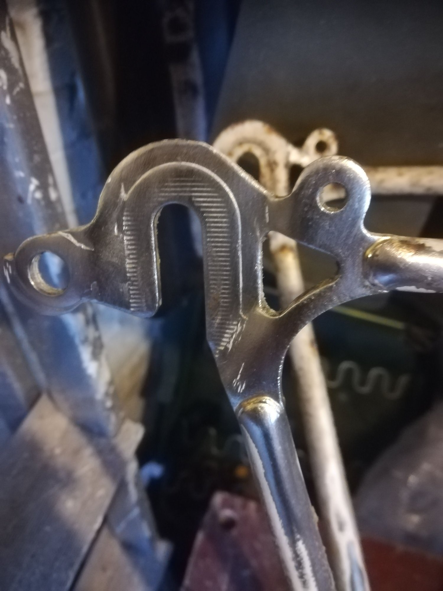

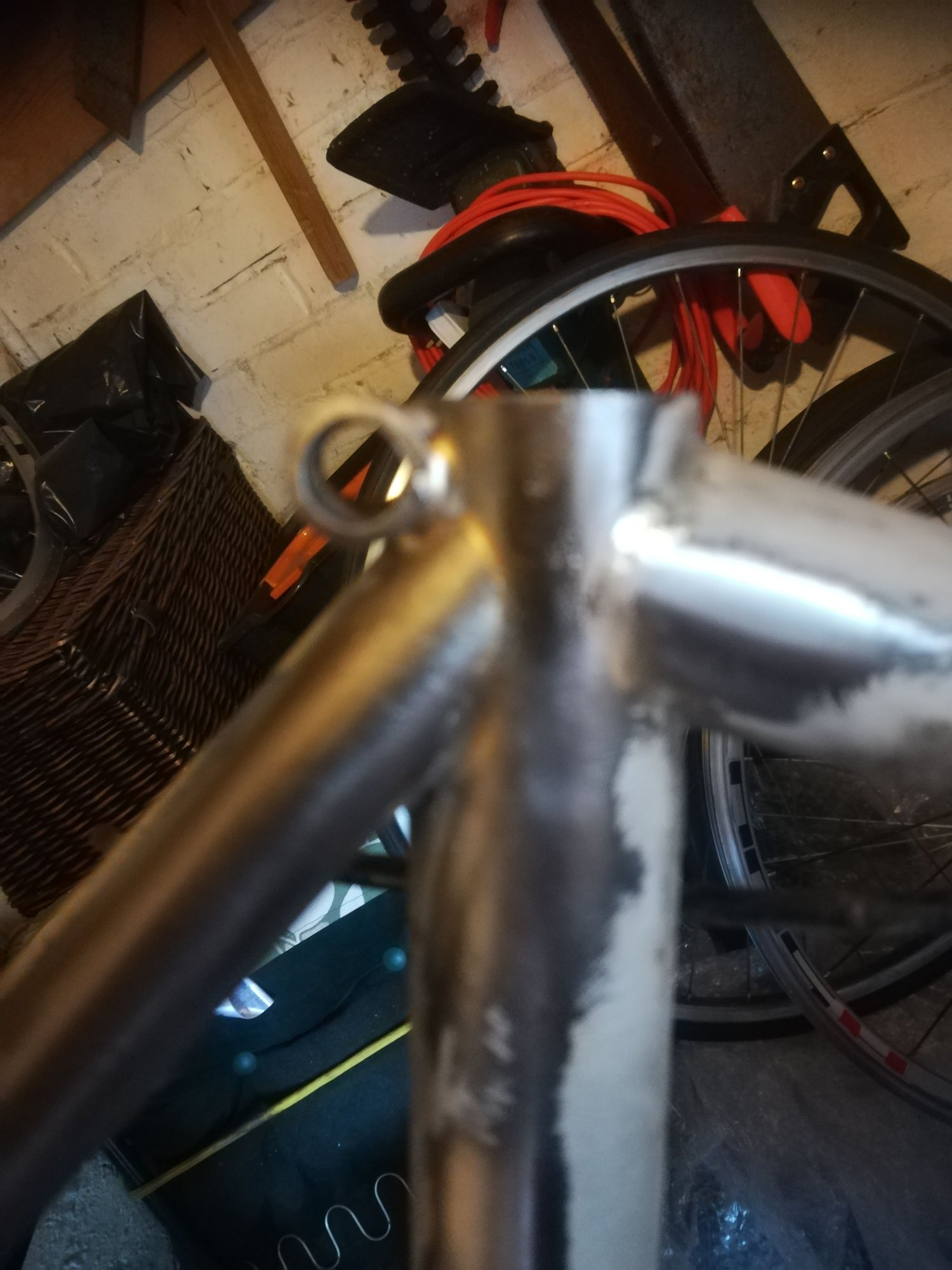

Just a quick update on this, as I've finally finished the BSA and made room to start on the ANC Peugeot.
Strip down of components was easy; nothing seized or rusted in place, although the seatpost clamp bolt was bent.
So I started stripping the paint. Three applications of paint stripper over the last week has just softened the decals, and not touched the paint. Hot air gun has done exactly nowt apart from lifting what was left of the decals. Sandpaper isn't achieving anything. This morning I resorted to a wire brush attachment on the electric drill. Finally shifting the paint with that - after a morning's work I'm seeing bare metal.
What did Peugeot coat this in? I've done a fair bit of paint stripping and restoration in my time, on cars and bikes, and have never seen paint as stubborn to removal as this.
Anyhow, just a few "progress thus far" pictures.
Is it powder - coated . That stuff is difficult to wir brush off and rust has a nasty habit of migrating under the coating without disturbing the top coat.
Looks like the original paint, not thick enough for powder coat, and it isn't coming off in flakes like powder coat does. Spent most of yesterday on it with the drill / wire brush attachment, and I reckon I'm about halfway now.
