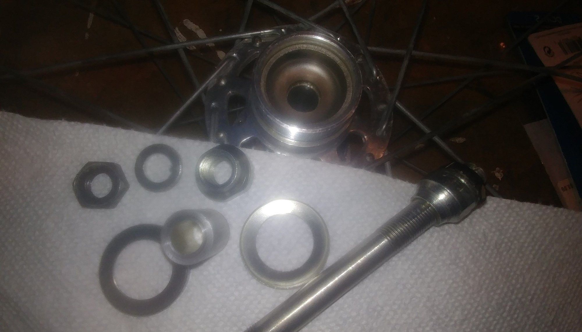

I picked up a donor bike that has Sunshine 5345 36 hole hubs with 27-1/4 rims. I'd like to give wheel-building a go, and I was thinking these hubs would be a good candidate for lacing to 700 rims. I need some guidance on rim options given the quality of the hubs and my beginner experience. The cups & cones look to be in very good shape.
I only have one decent C&V wheelset circa '81 Sunshine ProAm/Ukai 700x25c, so ,it would nice to have another option. Cost isn't an issue within reason and I haven't got a preference to vintage versus new rims. I'm wondering if maybe a wider rim for bigger tires would be good in case I want a setup for riding stone paths. I'm 90% a road rider. 190lbs.

Given the cost of spokes and new rims, I would really look into finding nicer hubs first. Those Sunshine 5345 hubs were their low end, commodity hub used for cheap Japanese bikes. Their cones aren't that durable (Sadly, a trait shared with the Pro Am hubs), and the cups are just pressed steel (not too smooth.) This is in contrast to the Pro Am hubs you have, which were their top of the line, Campagnolo Record knockoffs. If you want to stay Japanese, another set of Pro Am, or even better first generation Dura Ace aren't too spendy, and would make for a much nicer finished wheelset. ( I love the Pro Am hubs, but the Dura Ace hubs are a little better machined, plus the cones don't seem to pit as easily.)
As for spokes, Dan's Comp - a BMX mailorder outfit is hard to beat. They sell cut and threaded to length Sapim double butted stainless spokes + nipples for about .60c each. They usually ship within a day or two, and I haven't had a problem out of maybe 500 spokes over the years. Here is the link: Dans Comp - Sapim spokes

... Those Sunshine 5345 hubs were their low end, commodity hub used for cheap Japanese bikes. Their cones aren't that durable (Sadly, a trait shared with the Pro Am hubs), and the cups are just pressed steel (not too smooth.) This is in contrast to the Pro Am hubs you have, which were their top of the line, Campagnolo Record knockoffs...
To be clear, 5345 was the Sunshine JIS code. It is not a model number. You can find it on any Sunshine hub from a certain period (late 70's-80's).
The large flange hubs in OP's photo are pretty nice, in my opinion. They definitely made cheaper ones.

I just salvaged a pair of wheels with those hubs as they are my favorite inexpensive hubs. Thousands of miles on a similar set and the cups and cones still look great and run tight and smooth. Good luck with your build!
