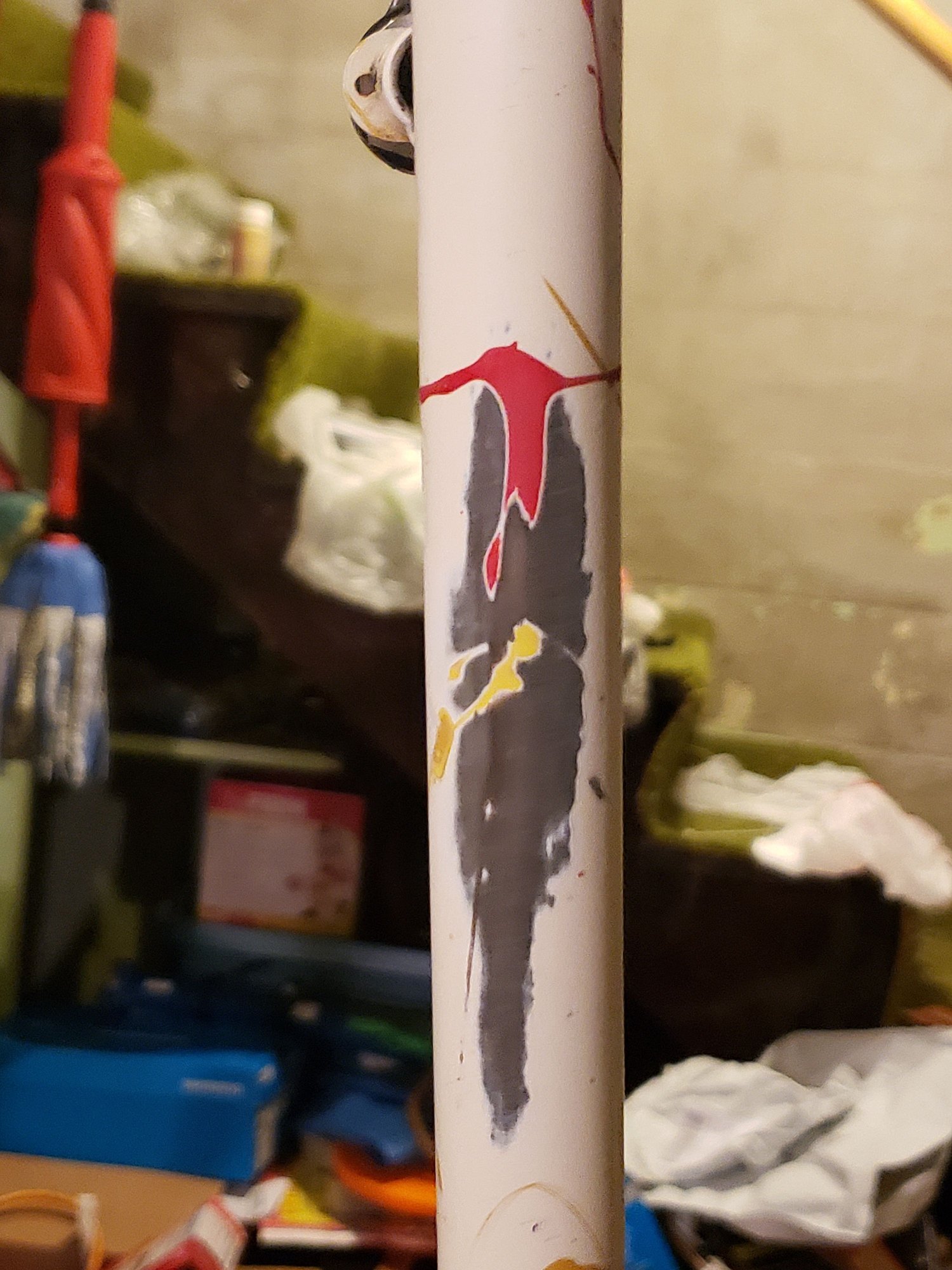

Old 08-29-19, 06:51 AM
Unca_Sam
The dropped
Unca_Sam's Avatar
Location: Columbus, OH
Posts: 1,651
Quoted: 1206 Post(s)
Liked 570 Times in 406 Posts
Surprise!
After touch up application, before polishing.
Chain suck damage after primer. Using a body filler would make it look nicer.
Isopropyl removed paint here...
Interesting issue while degreasing before touch up. 91% isopropyl dissolved the paint here! A quick Google search says that isopropyl removes latex paint. In other words, this area was repainted with a gloss latex to match. The red splat had separated from the fork, so I picked it off since I'm painting anyway a little wet sanding then a wipe with the alcohol and there goes the paint!

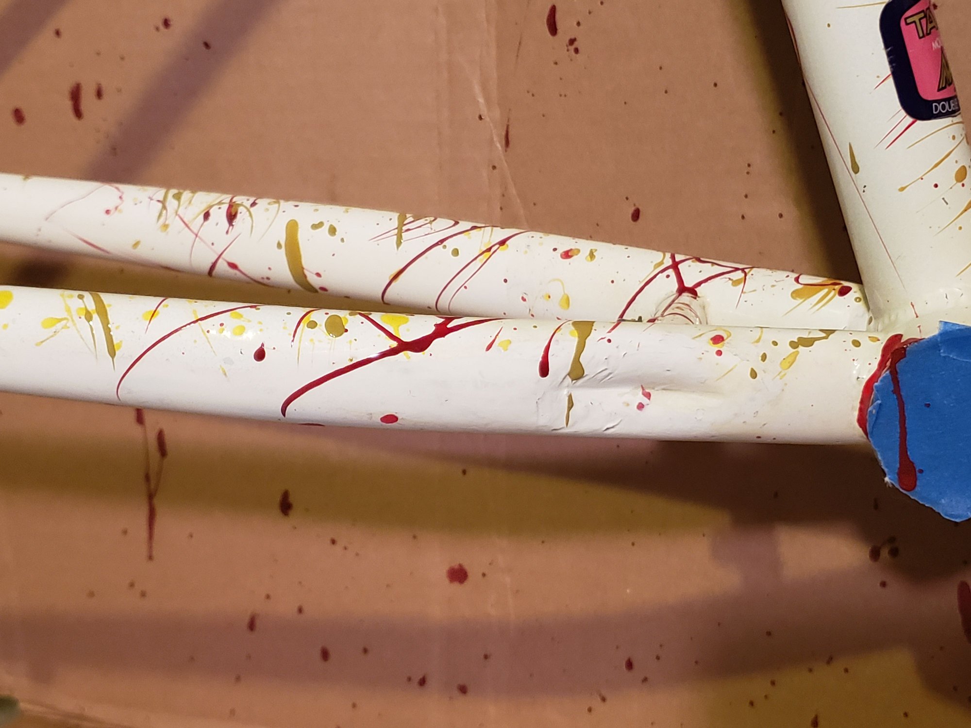

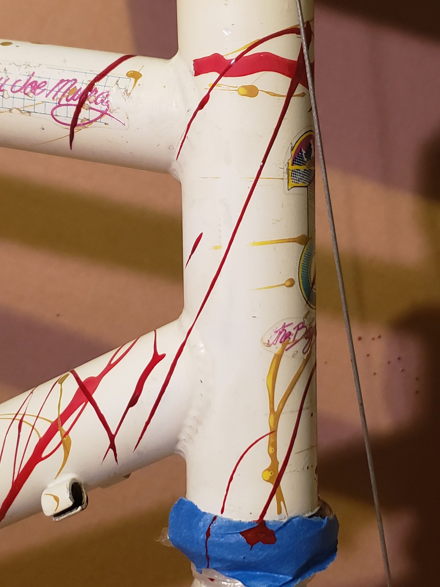

Old 09-02-19, 04:17 PM
Unca_Sam
The dropped
Unca_Sam's Avatar
Posts: 1,651
Finish!
I never thought I'd learn basic bodywork to fix a bike's paint job.
Head tube after last leveling
Ready for splatter
Fork paint repair, right side.
Unfilled finished chainstay.
Final to come!

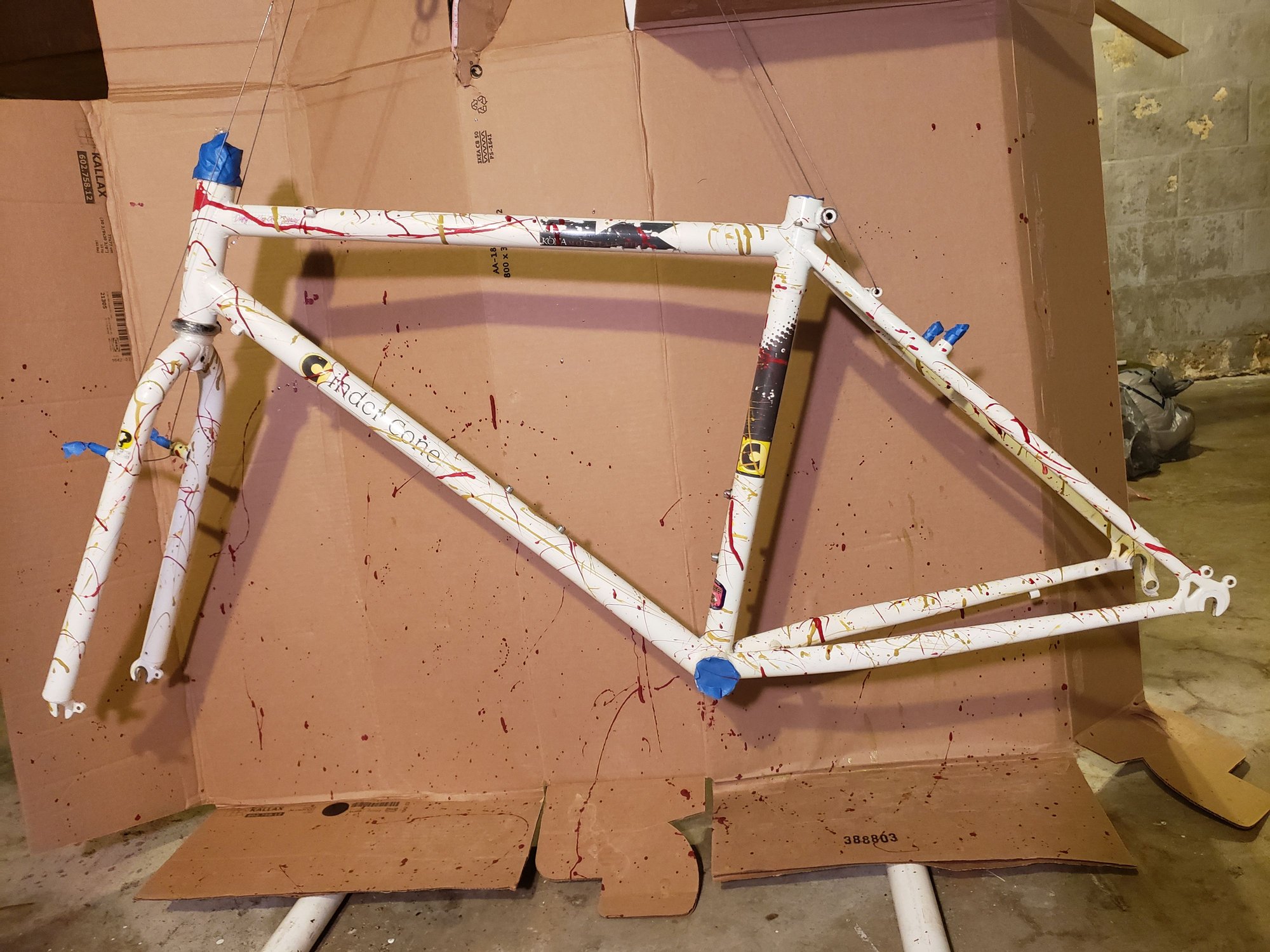

Not perfect
This will be the final post for this paint repair with pictures. I'm happy with the results .
Left side total
Inside right rear dropout. Some thin touch up on seat stay and chain stay. I was prone to leaving brush marks there.
Fork rear. Primer over previous splatter paint, though it blends alright. Wet sanding that out would go through the paint next to it even with a backer block.
Right side head tube. Best representation of progress overall.
Down tube damage. Splatter hides well. 😉
This should hide the damage well behind the chainrings.
Overall, the finish on this bike is good enough for a rider. I will make my own chips and scratches, and I'll know how to fix them.
