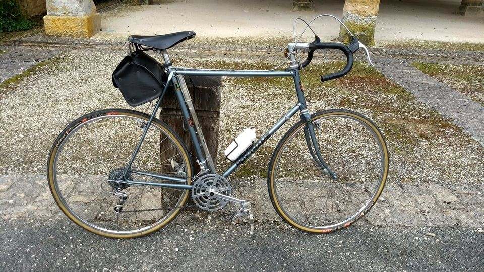

It happened to me only once, on this Roy Thame:
Since its quick release system consists of disengaging the brakes, I decided to true the wheel using the multi-tool I had with me, and switch my riding style to 'limp home mode'. Rode it like that for another few days without any problems.
Last year I bought some of these at a swap meet. NOS 'first aid spokes'. Haven't tried them yet.
