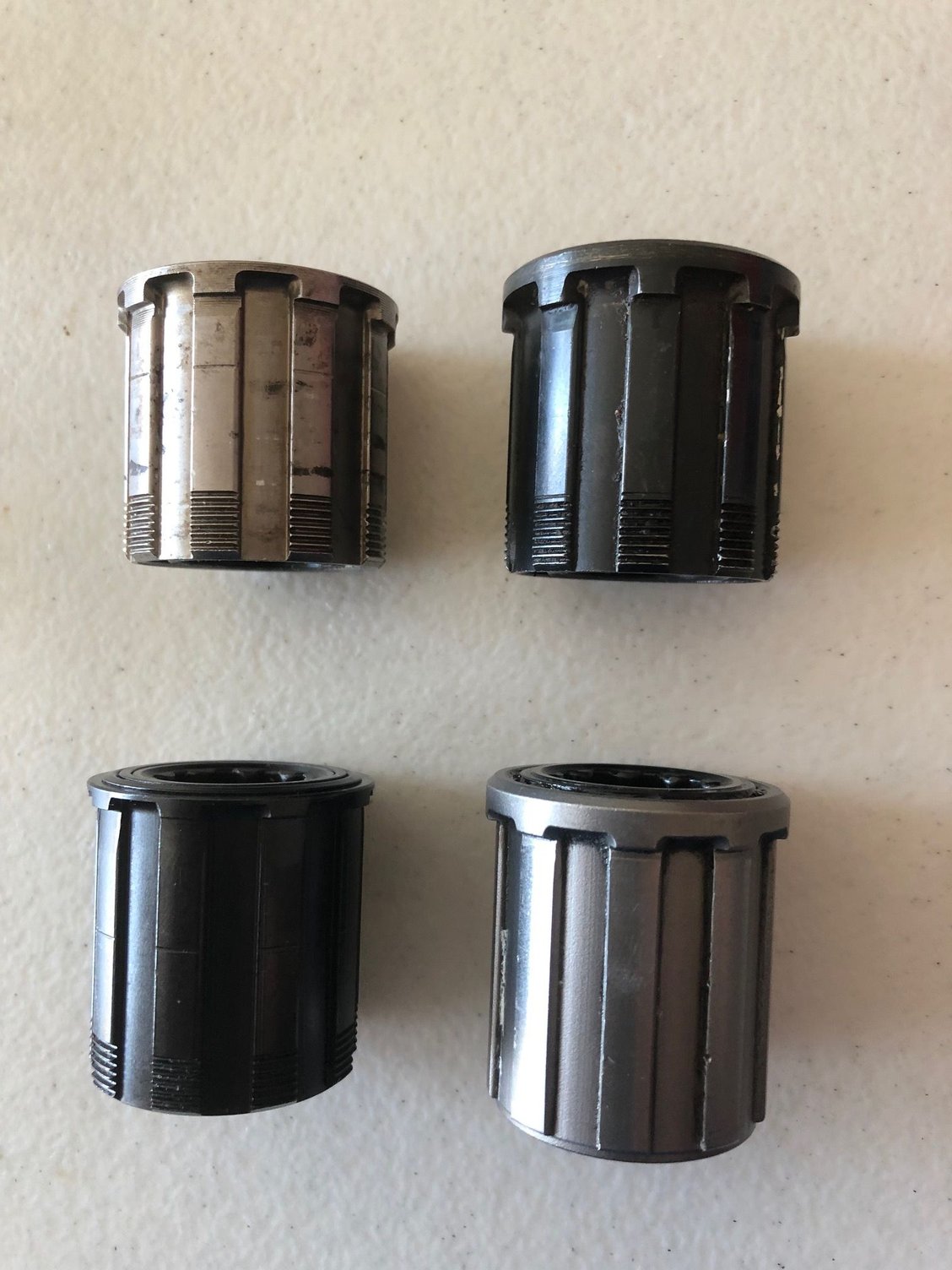

I know of 3 three late 80's and 90's freehub body attach styles (excluding Dura Ace). I've seen a flush, a shallow, and a deep shoulder recess. You need to remove your STX freehub body and take a look at the freehub shoulder and freehub body.
Here is a pic of the shallow and deep shoulder recess. The left is a shallow with a square shoulder edge. The right is a a deep with a beveled edge. I've swapped 7 to 8 and 9 to 7. You do need to find the correct DS cones for the freehub body.
Shallow (square) and deep (beveled) freehub bodies...

I'm no expert on swapping freehub bodies, but I've done a few.

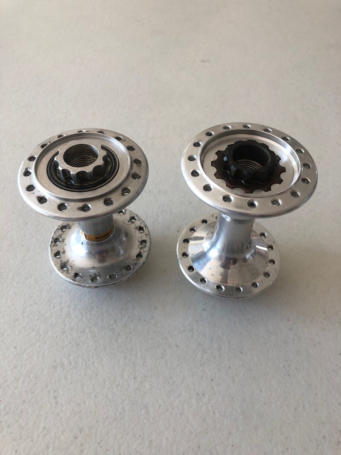

The cheap 8sp RM-30 is on the right; on left is a 7 eg LX or 105 etc.

You can find an appropriate 8sp fh body but best price I see is $25-$30. I accidentally bought the new RM-30 on $10 price without looking closely.
