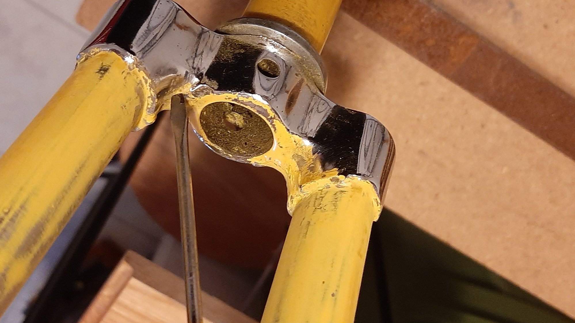

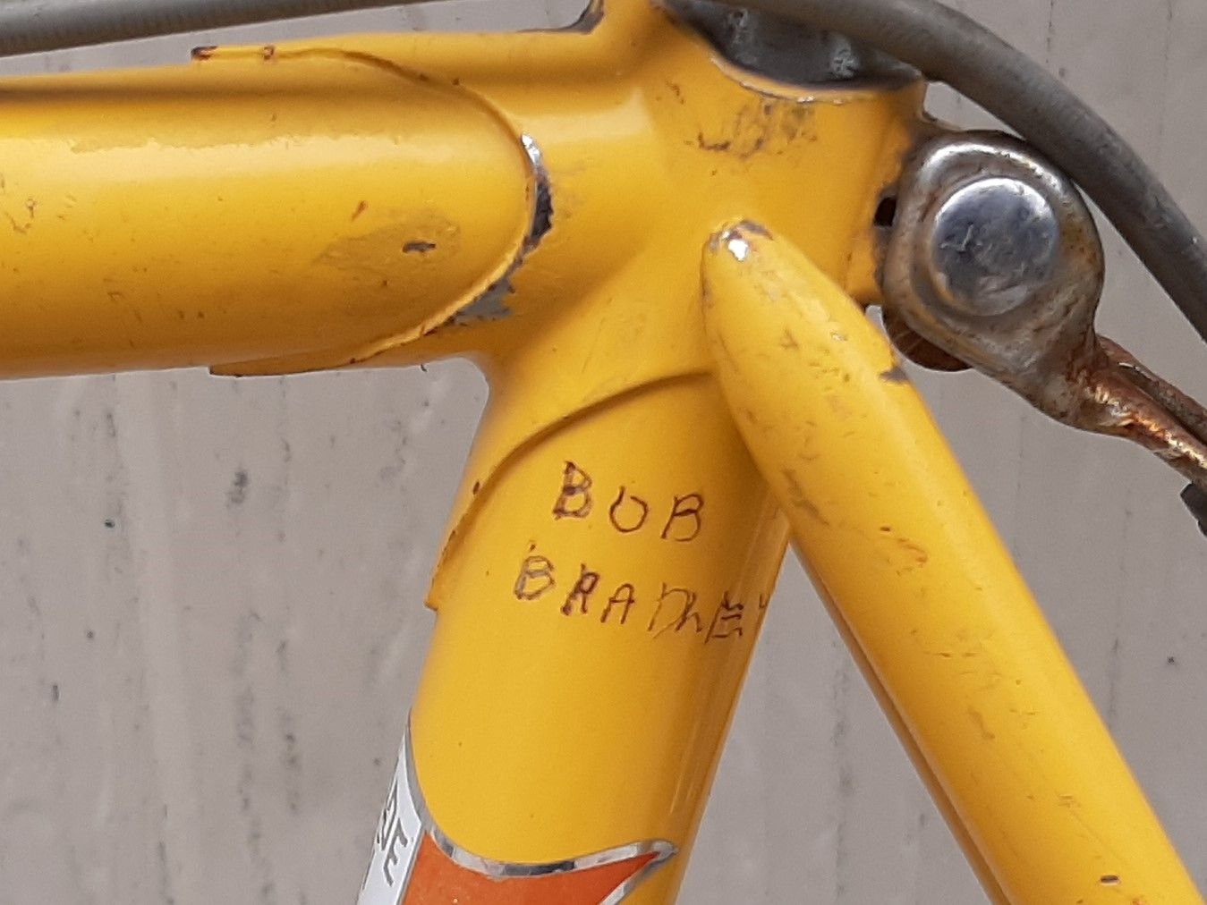

For flaws like that seat lug you can use a safe-back jeweller's file. The real cut-steel ones do a better job than the diamond-dust ones - they cut faster and leave a smoother finish (modulo skill, of course).

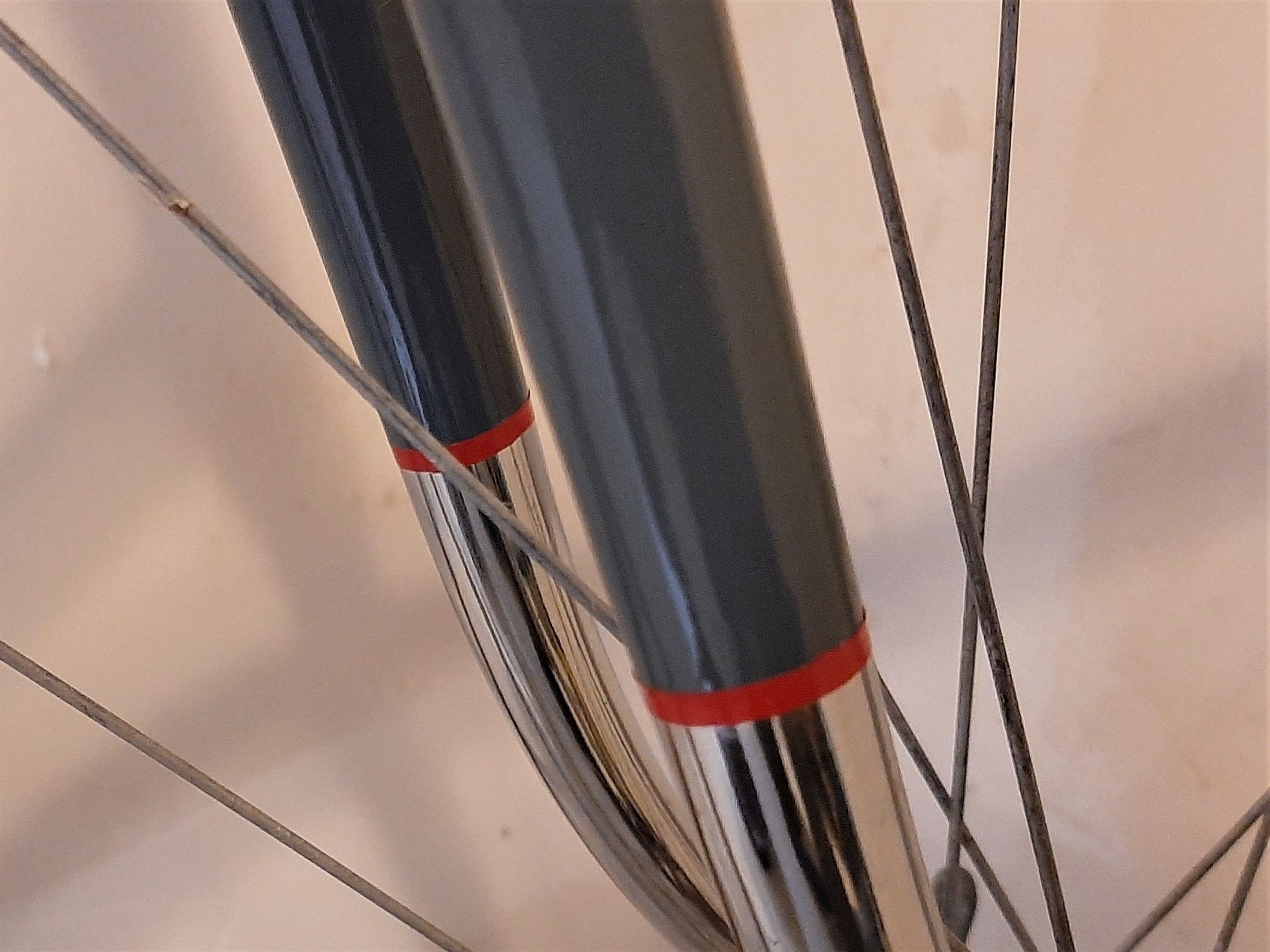

Randy, two thoughts.
The gray n red approach looks great but, it seems the red needs to be somewhere on the rest of the frame too. Maybe red lug lining on the seat lug or BB shell. My Crescent has a single line pin stripe down each seat stay. Hmmmm.

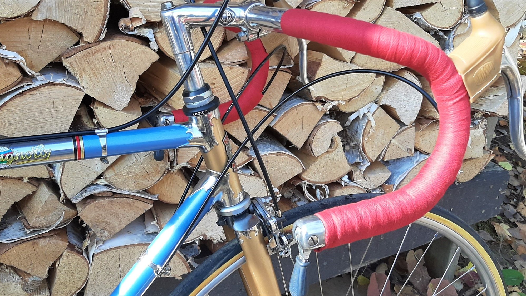

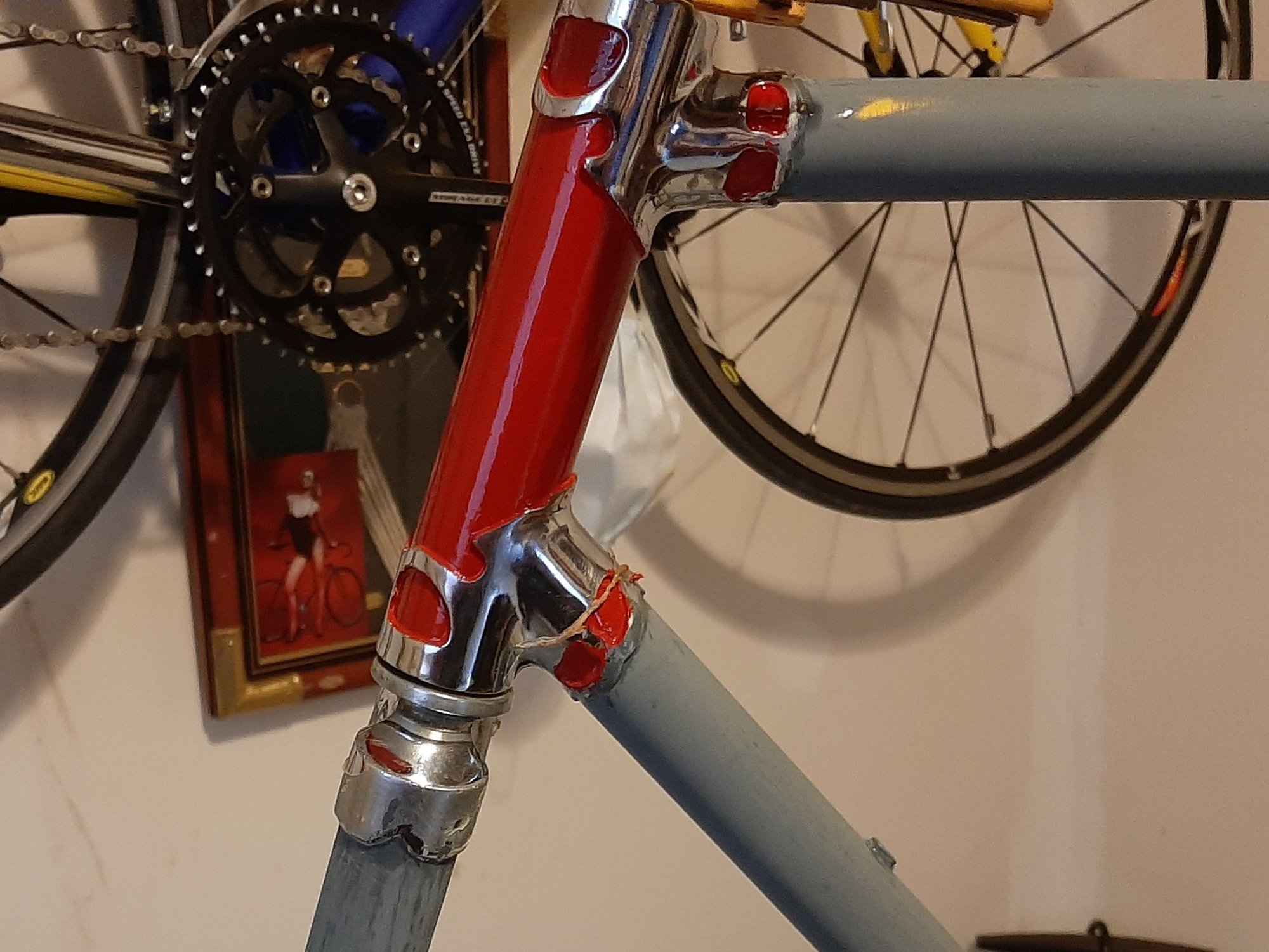

Her is what the taped result looks like. Two narrow red strips run down each side of each fender. The same tape edges the fork and stays socks. The double black tape edges the seat tube panel. Very easy to do...
To that, add this bar tape and there should be enough red to do the trick...

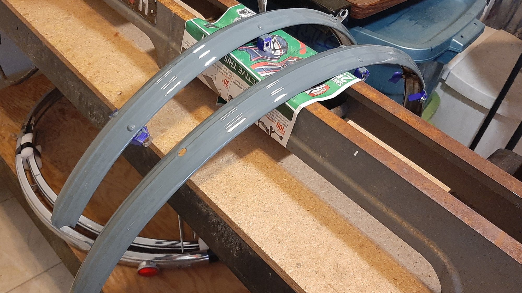

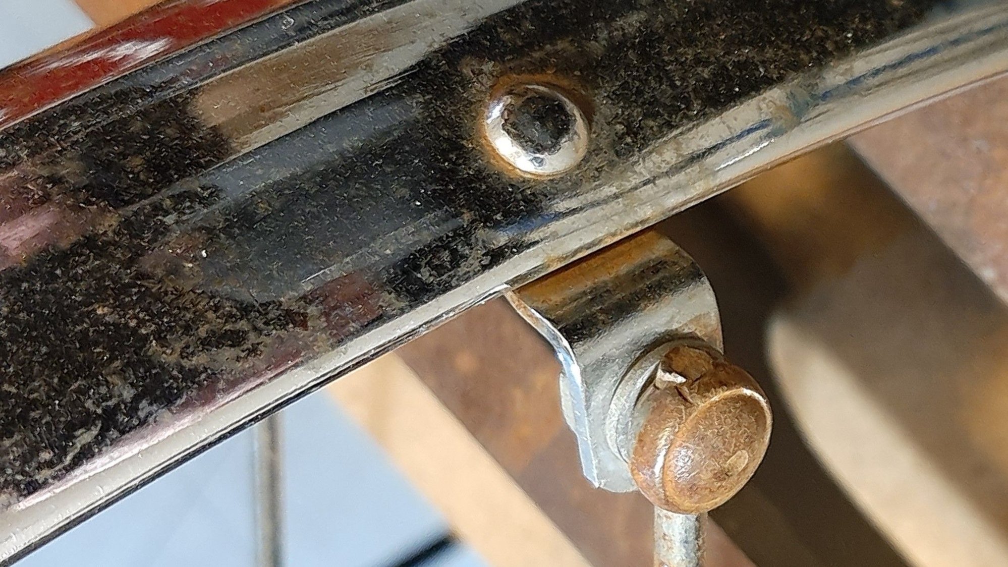

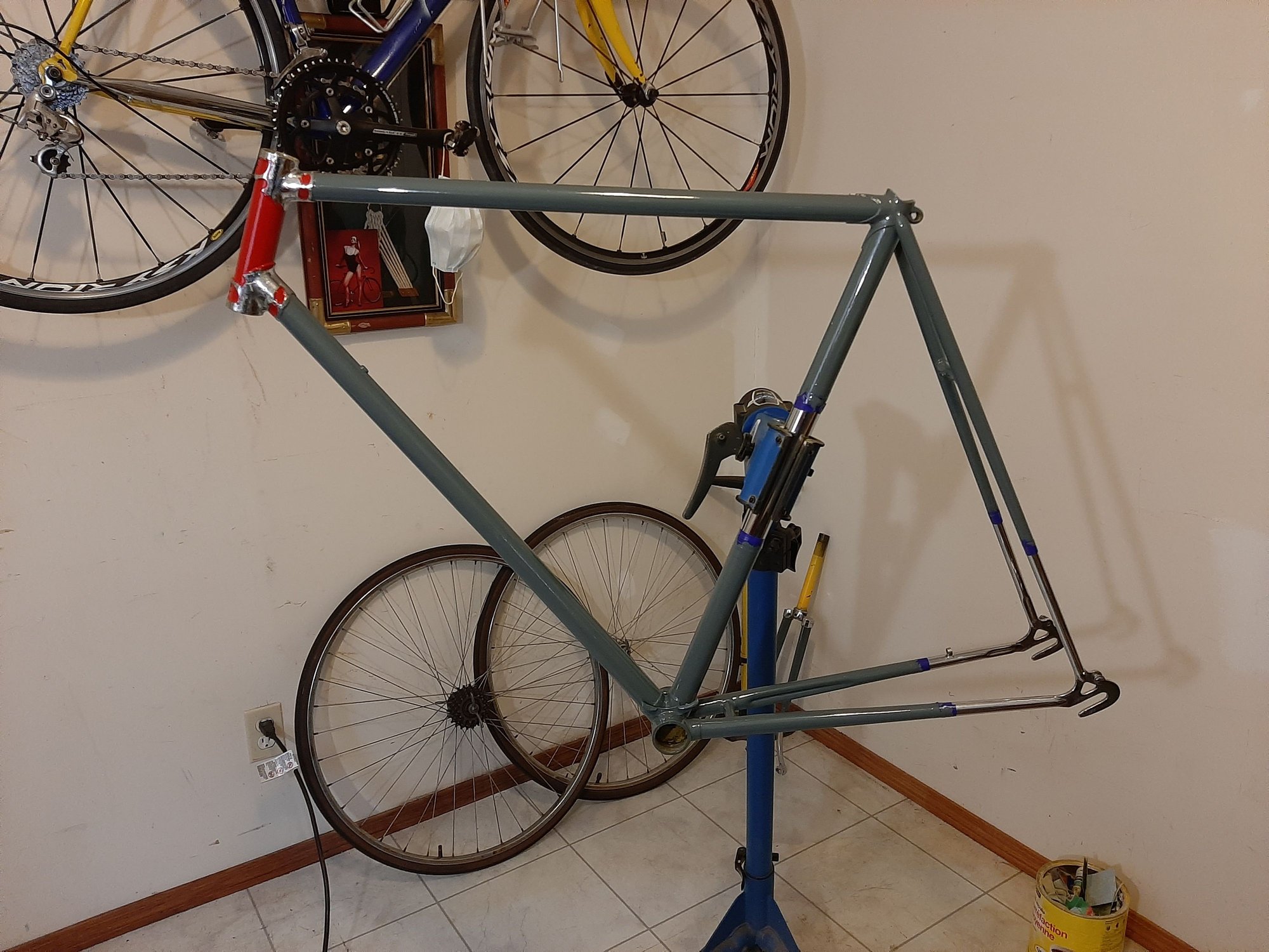

Today, I finished sanding the pitted chrome original fender set. There is no way the chrome will look good, leaving the option to paint wide open. Not sure what color to go with right now - grey or red or a combination. Anyway, a hard to find original Torpado fender set in great shape except for the poor chrome...

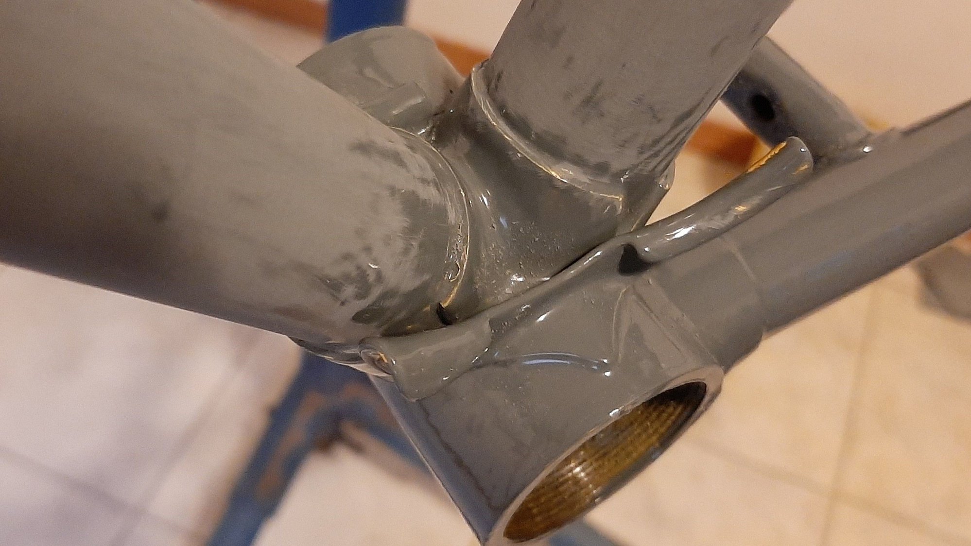

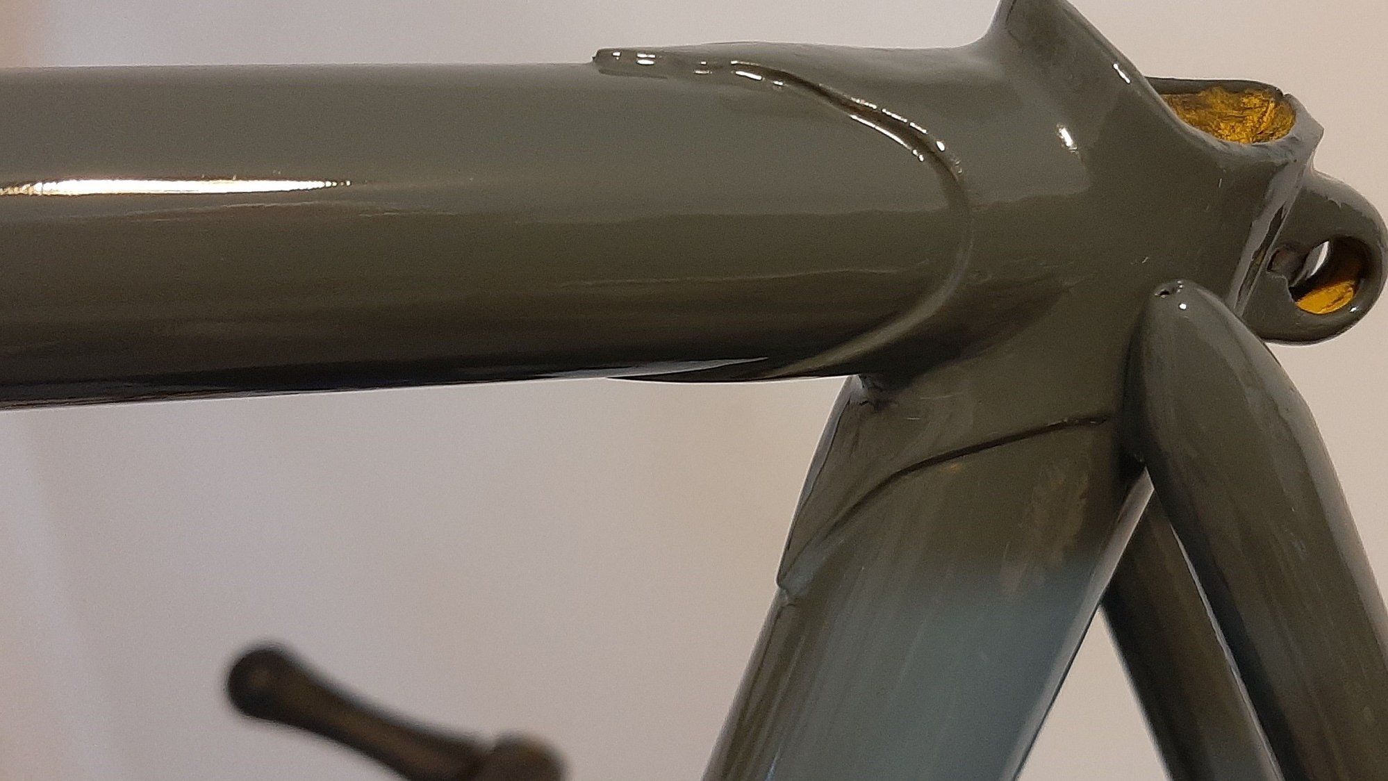

The frame and fork were color sanded today, smoothing the less than perfect surface offered by the first two coats. This coat, the final I hope, will be applied thin and with extra care...
When sanding, go slow and use fine paper (wet and dry, wet is best). As you proceed, you will see shiny spots surrounded by the matt grey sanded finish. These are low spots and need to be blended into the surface. The better the surface, at this point, the nicer the finish will be once done...

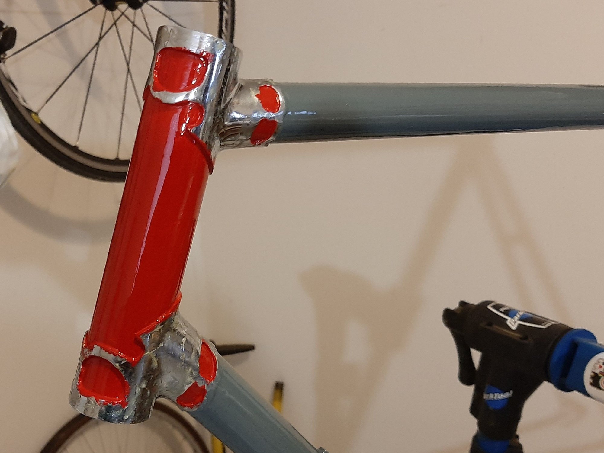

The liquid latex did a decent job of masking the fancy lugs. You can see some of the latex, that I peeled/rubbed off with my finger and finger nail. That is, pretty much, all you need to get not too bad results. Still have a bit more edging to do. Out comes the finger nail again. And, once done, if any touch up is needed, it is very easy to apply.
So, with luck, tomorrow will see the frame/fork painted and drying in preparation for art. I will slap the first coat of grey on the fenders. They will get at least two coats, color sanding between them. Then, I will have to decide on one color or two tone fenders for the old Torpado.

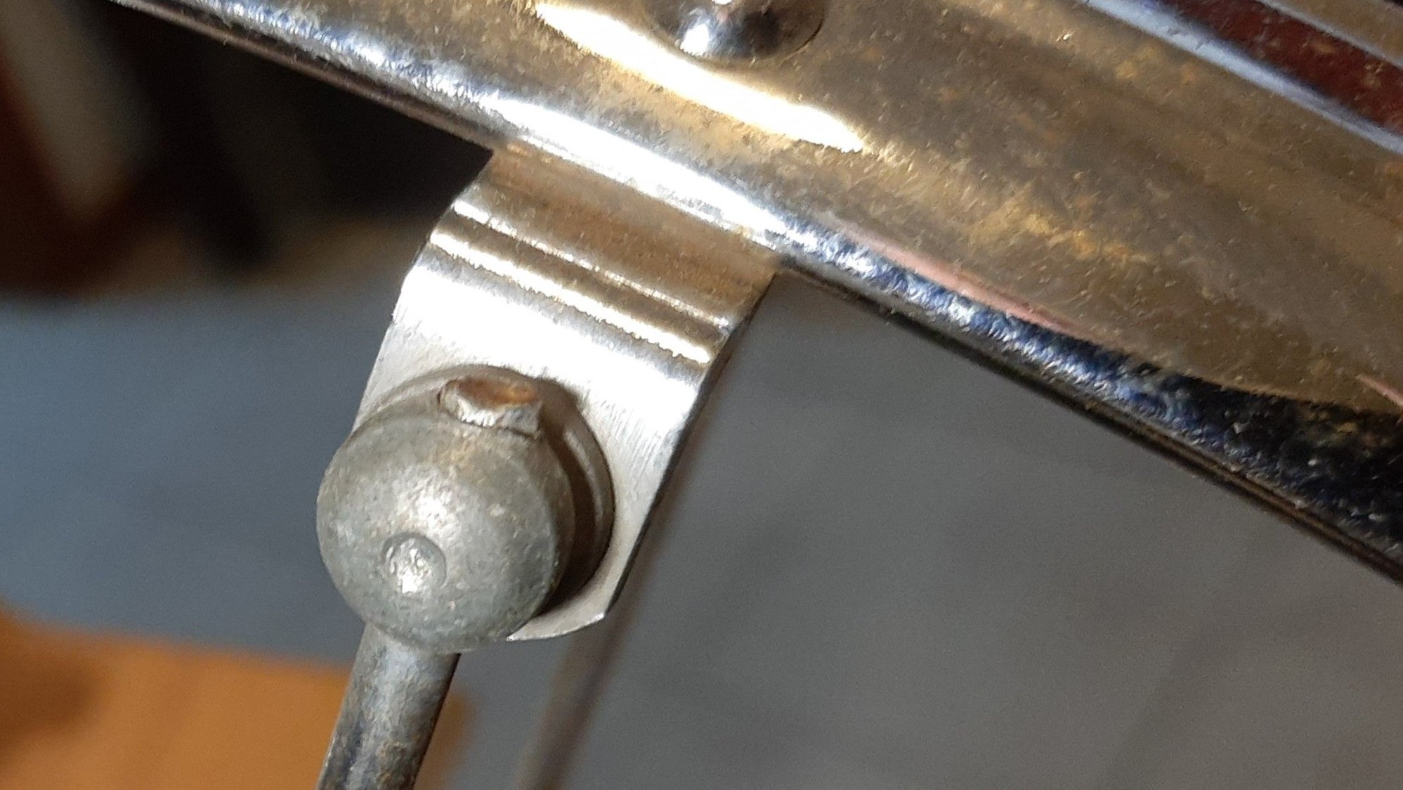

The fender fasteners are very unusual (the first I have gotten my hands on, I think). They will all be cleaned up, along with their matching one piece support struts, and installed sans paint...
Some require more cleaning than others...

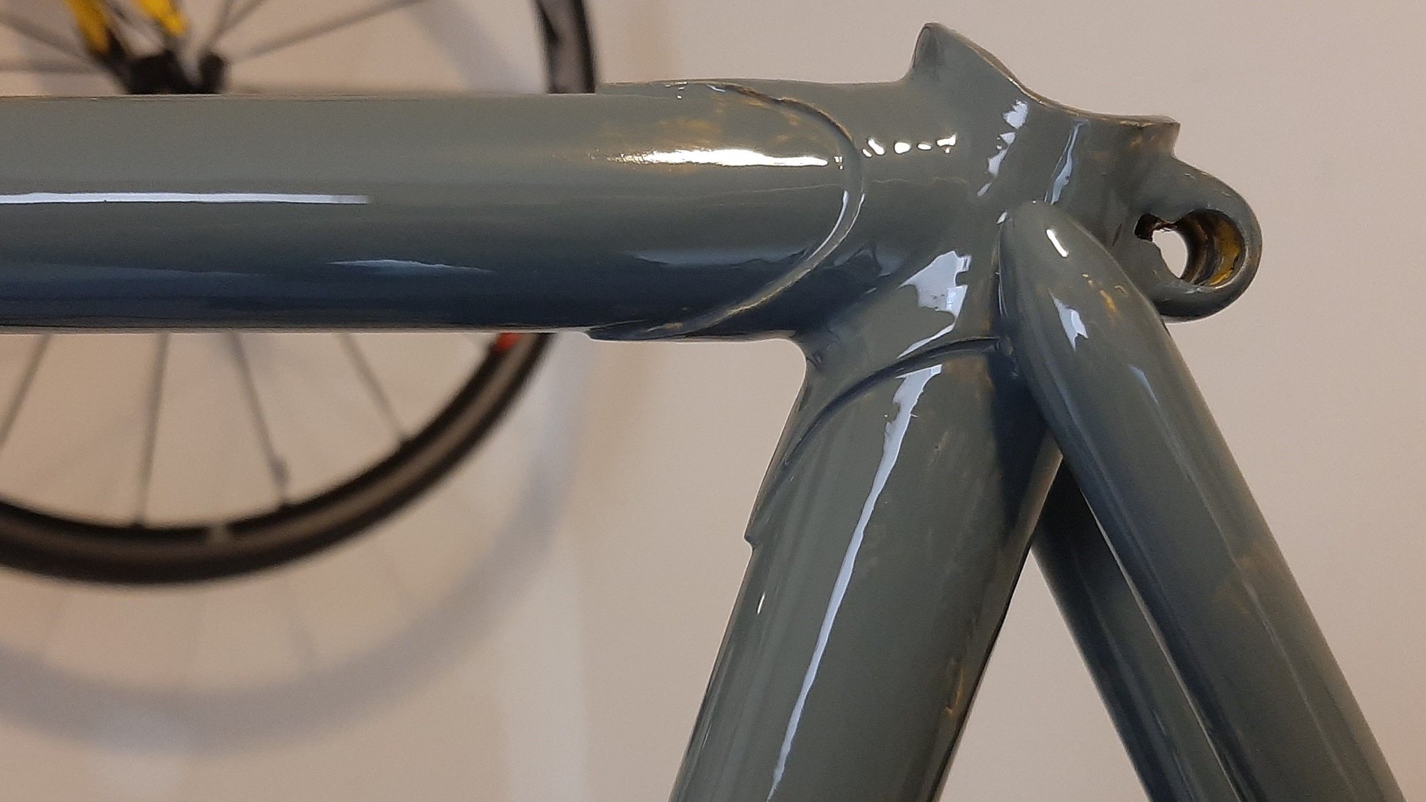

By now, if I did not know what was happening, I just might say to heck with it. But I learned a long time ago that the quality of one's brush paint work improves with each coat of color applied. Simply put, with each coat applied, your painting skill improves.
The first coat or two does not look great. So, after each coat, color sand. Color sand means, after the paint is dry (say a couple of days in a warm room), use #400 grit wet/dry paper to sand the new painted surfaces. In seconds, as the shine dulls, you will begin to see low spots. Any irregularities in the paint finish will lower the quality of the finish. So, do your best to sand the new paint smooth. You might sand through in places but that is not a big deal. Just apply another coat, let it dry and have a look. Repeat until you are happy with the final result...
As found...
Two coats...
Final coat applied (with greater care)...
Even the fenders get a coat of grey...

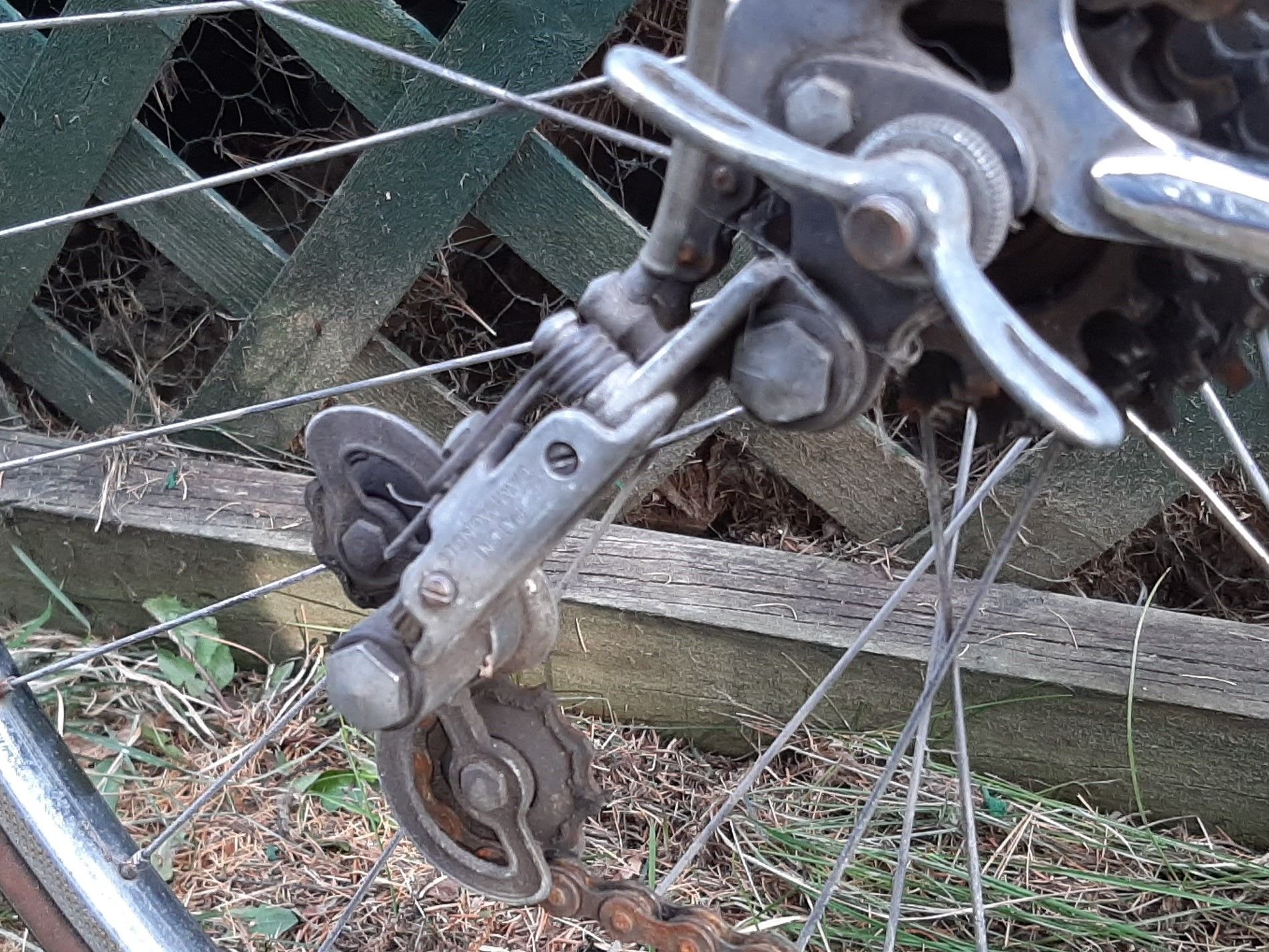

Now, wait for a few days while I clean the components in preparation for assembly. For now, the Torpado frame is looking pretty good. I do have two small spots to touch up but the repair is a snap. The fenders will need another coat, probably tomorrow. Anyway, still some tidying up of the lug work but the effort is beginning to pay off...
Most of the luquid masking material was removed with my thumb nail. I still have some cleaning and edging (not sure what else to call it) to do, but all in all, not a bad home based brushed on paint job. And done in the mud room, at the back of the house, with minimal mess. There was, however, an odor associated with the effort...
I pan to buy some new tape. This stuff looks pretty good but my confidence in the adhesive backing is low (the tape is old - new when I bought it, but old now)...

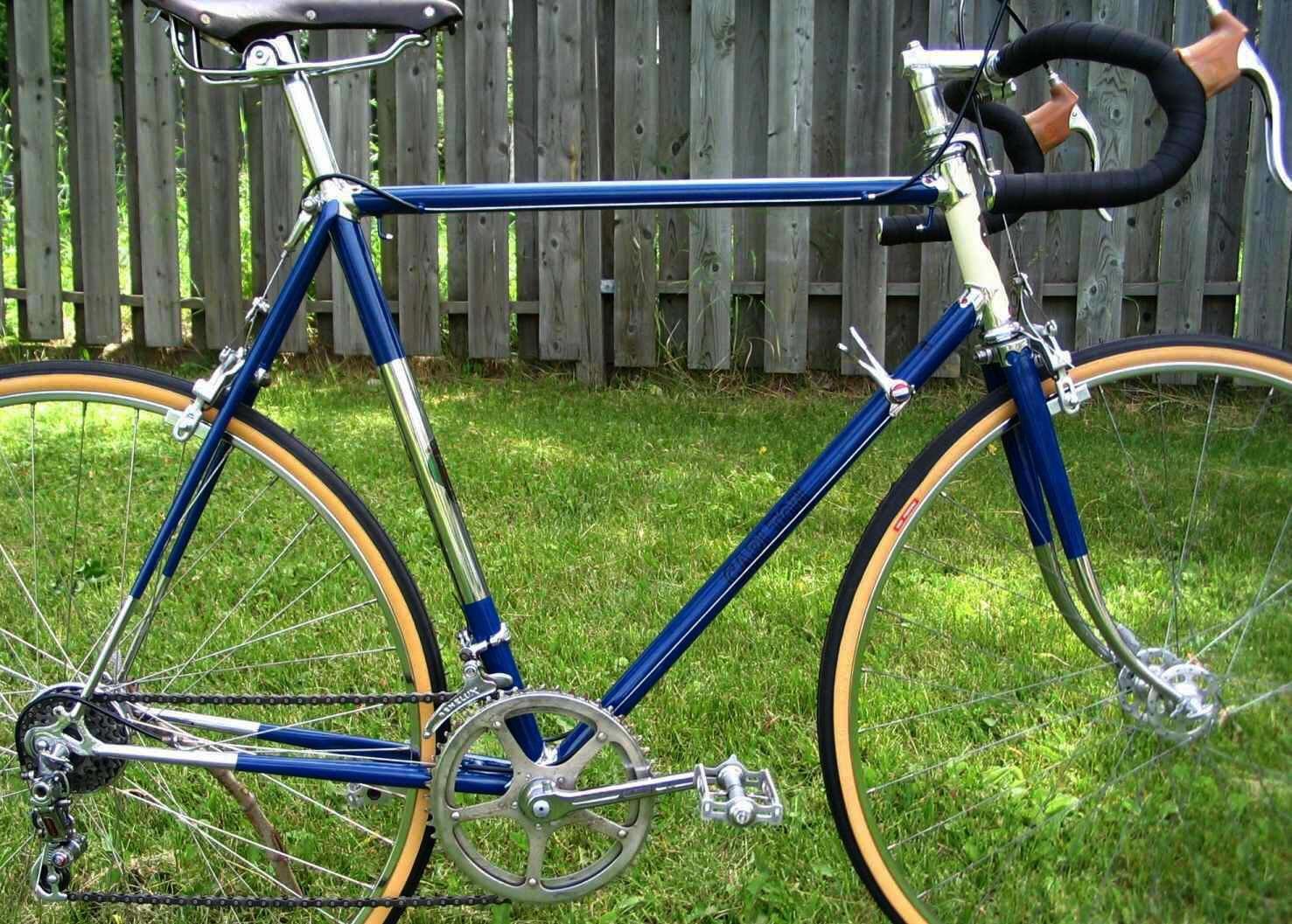

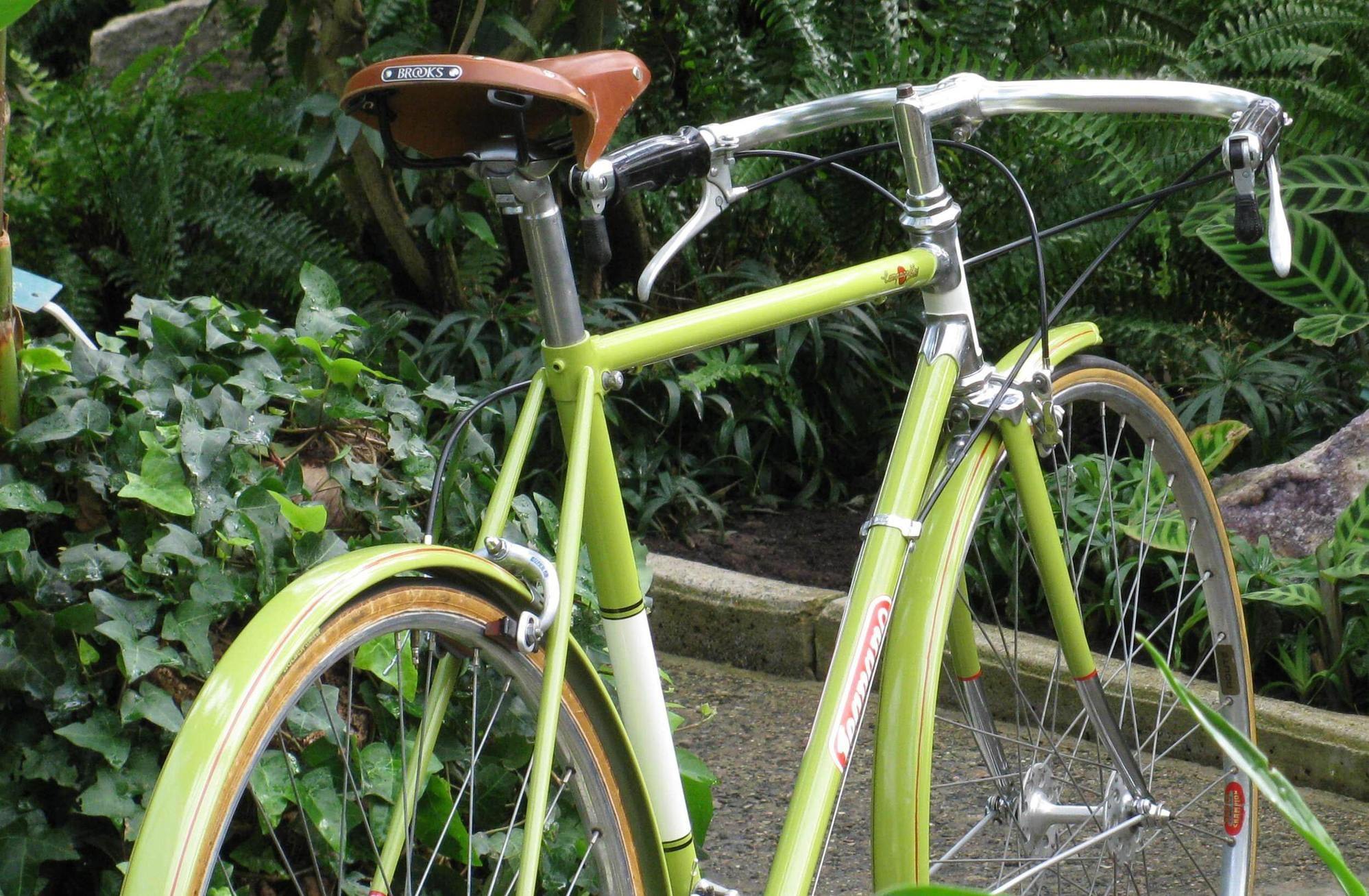

I have done a few "brush" paint jobs on frames and have to really resist the urge to start "rubbing out" before the paint has cured. I followed somebody's advice and made a simple "hot box" of a aluminum-foil lined bicycle box with an incandescent bulb inside and leave it be for about a week. A week might be overkill but that's what worked for me in the "high ambient humidity" of SF Bay Area.
Rubbing out is where all the work and where the pay-off is, even if your brush-work is poor, but smooth brush-work makes for easier/quicker/better rub-out.
And I've always wondered (cause there HAVE been some hints) do you Canadians who can obtain both find ANY difference between Tremclad and Rustoleum? Some have said that Tremclad is better; others that there is NO difference besides brand/label and the volumes (milliliters vs fluid ounces) in the cans: same parent company=same products.
Tremclad on this (brush)...
Rustoleum on this (paint brush)...
Russtoleum on this(rattle can)...
Crylon on this (rattle can)...
Lacquer (rattle can) on this...
And, of course, my present project, Smoke Grey Rustoleum and a decent brush...

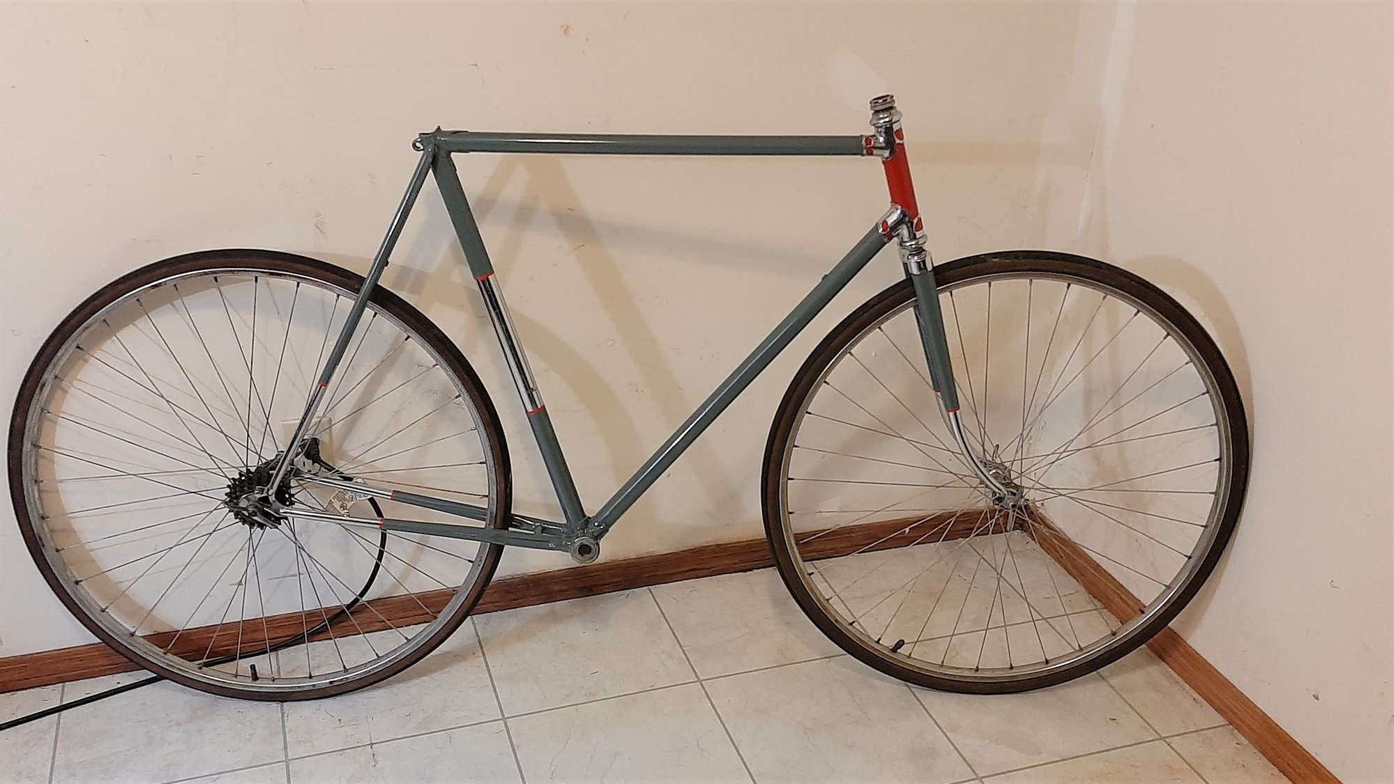

Once sure it all fits, art follows...

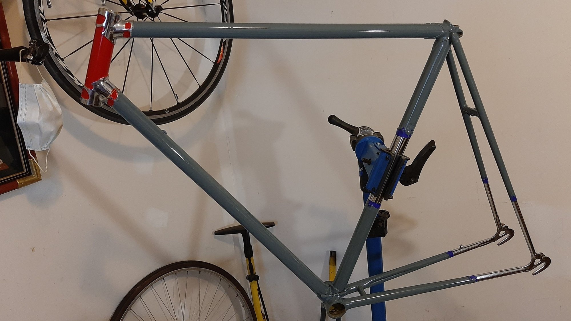

So, the last coat goes on as carefully as I can apply it. If good enough, then I am done. If not, sand and apply another coat.
I did not thin the paint. Rustoleum recommends against it and, to be honest, there was no need to thin the paint. It goes on well and flows to a smooth shiny surface...
I still have some clean up to do and possibly a wee spot of touch up. I have, pretty much, done my last bicycle paint job. Eyes are dim and hands shake too much for fine work. But ya never know. I still have Torpado's top dog, from the same era to restore, and I am gonna give it a shot next Spring - early sixties Torpado Professional...
I do and did color sand the work between coats but did not wet sand the last coat. I could do so but do not intend to do so. I am quite happy with my less than perfect results. Keep in mind, as I mentioned earlier, vintage road bikes were, particularly the entry level steeds, were not mechanical art. In fact they were hastily made, painted and assembled. This is the sort of cosmetic quality one can, often times, expect from a lower tiered vintage road bike...

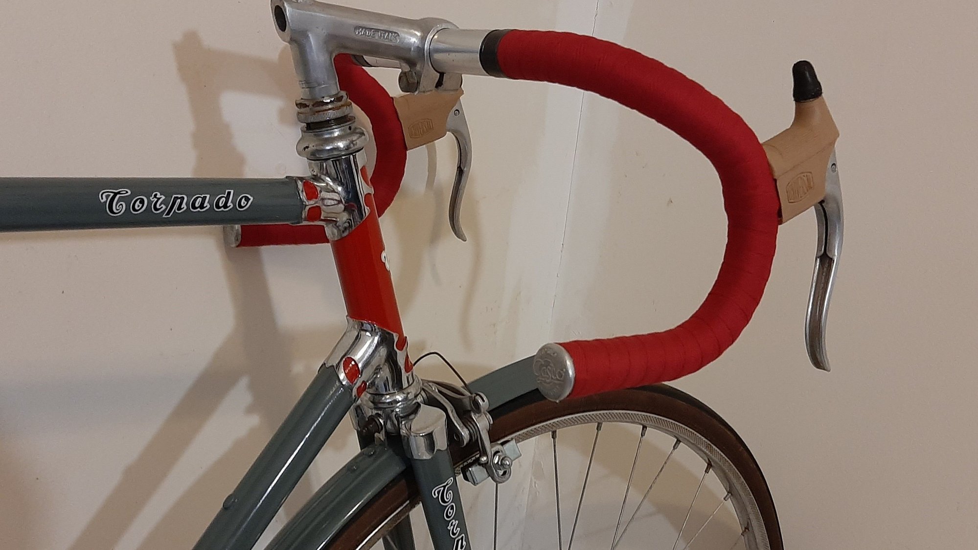

I sweated bullets applying the art. Twenty four hours drying time and then off comes the protective layer. Fingers crossed...

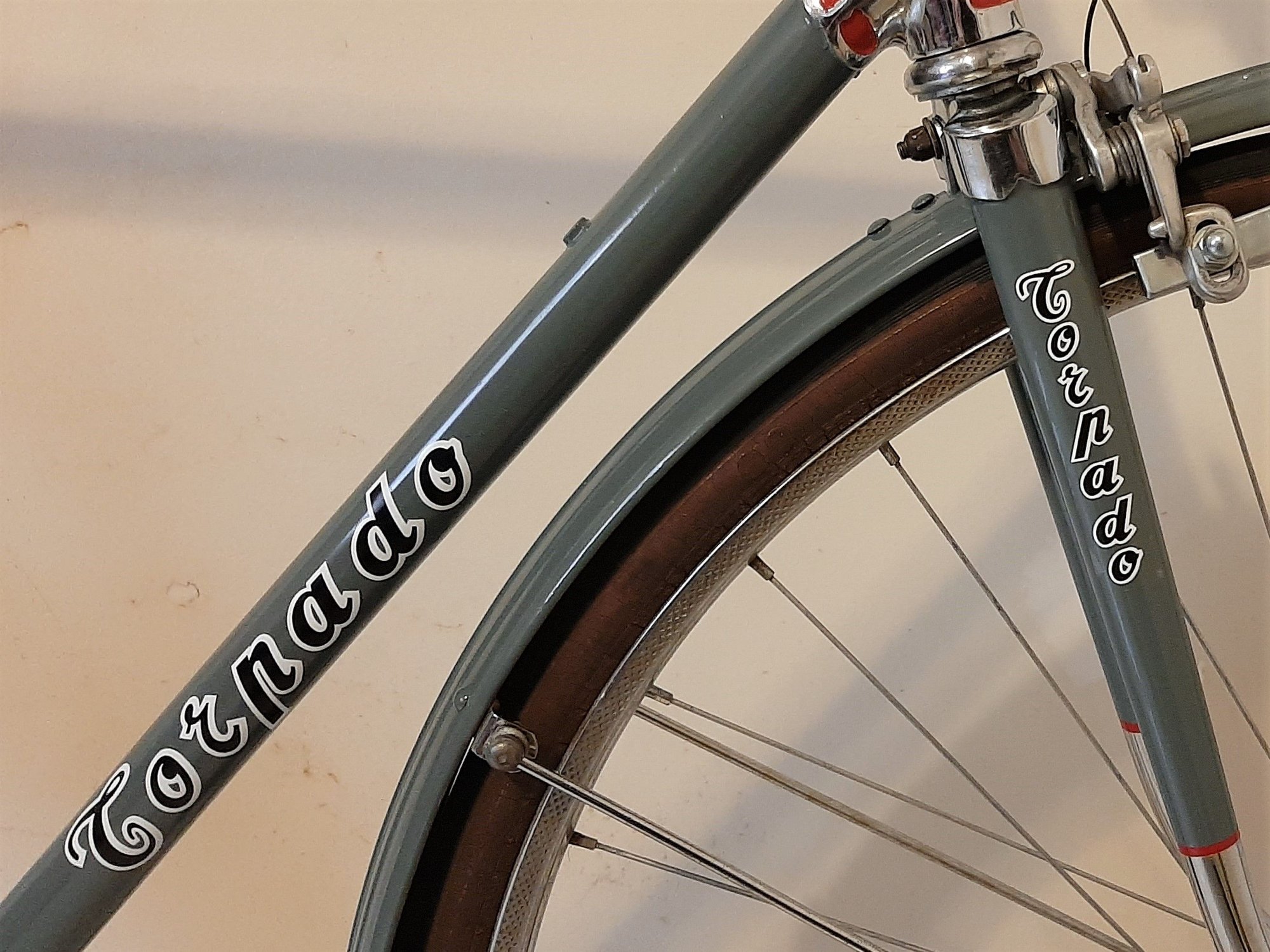

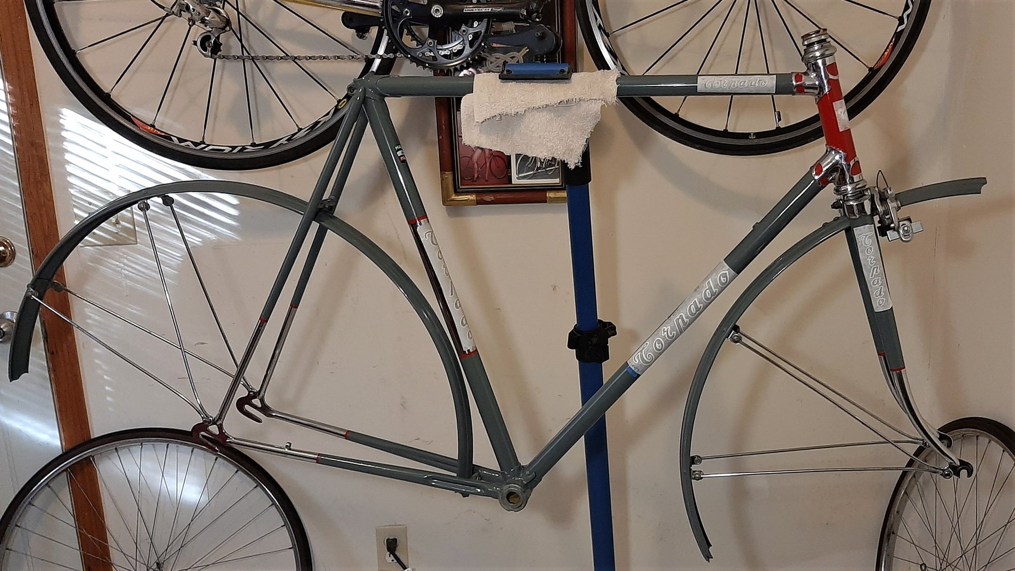

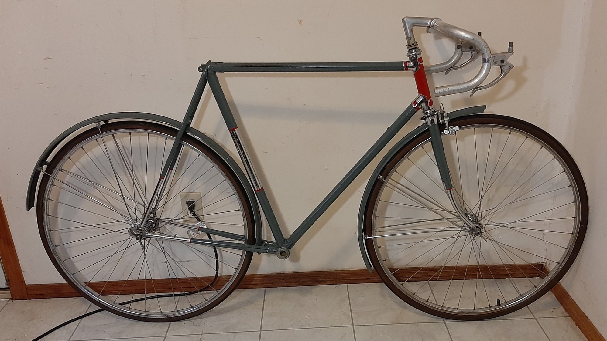

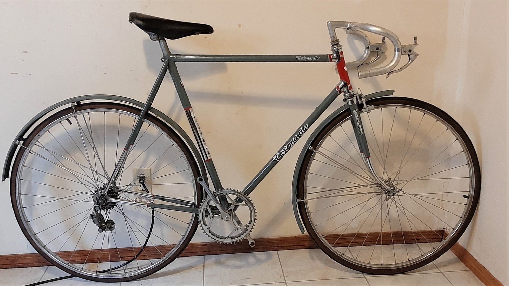

Assembly begins. Not really fussy on the saddle but keeping this one as close to original as I can is the primary goal, next to having fun. Please excuse my poor quality pictures...
Still a bit of tidying up the paint and chrome but things seem to be working them out
It will look better after the final clean and wax job. For now, I will resist that until April, at the earliest. My gum wall tires (700c x 28 will be here at the end of March). Might also keep my eye open for a decent original head set...
Anyway, hope someone found how to paint an old Torpado with a brush interesting and entertaining.
