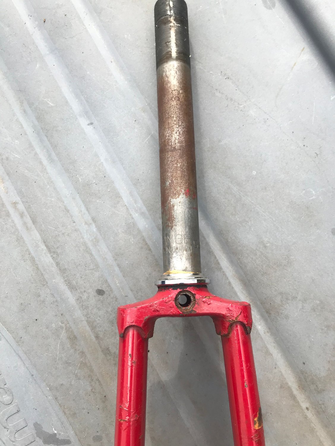

Hi,
I’m in the midst of disassembling my ‘85 Cannondale this winter in order to strip the beat-up paint, and I am looking forward to seeing that beautiful bare aluminum frame. What I hadn’t considered as much is the chromoly fork.
How does one know when it’s worth it to forget the old one and get a new (1” threaded) fork? Obviously I can’t see all of the rust yet, as I haven’t stripped it, but based on these pics can those with experience tell what I should look out for/what I’m in for?
Thanks for any thoughts

Based on your pictures, strip it down, 100:1 odds that fork can be cleaned up and repainted with no issues. I've seen worse clean up nicely.

Looks like it is only surface rust to me

I'd have it bead blasted, probably it's OK.

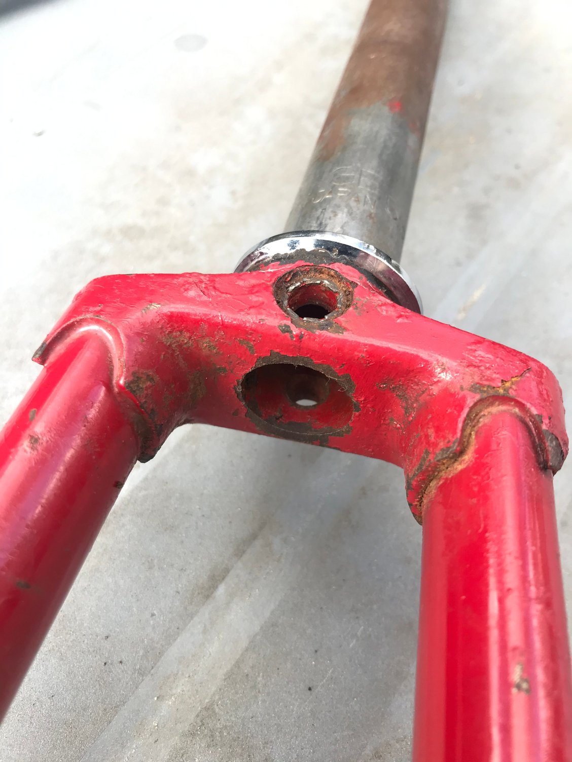

That looks like a Ishiwata CCL fork crown.
See these discussions:
https://www.bikeforums.net/classic-v...ork-crown.html
https://www.bikeforums.net/classic-v...ata-forks.html
While it's not that likely that you'll have a failure after all these years, since you're bead blasting anyway, have a framebuilder braze in a pair of tangs on the inside. Just for peace of mind.

Well, that’s interesting. It does look like that. And it does not look like the one on the SR900 in the 1985 catalog, which is supposed to be a Tange fork- see below. (I assumed this was the original fork, but then again, it doesn’t have its original headset either.)
So I’ll have to think about it some more, see what I see, get info on cost for blasting. Or maybe it’s a better idea to move on and buy a replacement, something like - -> THIS?

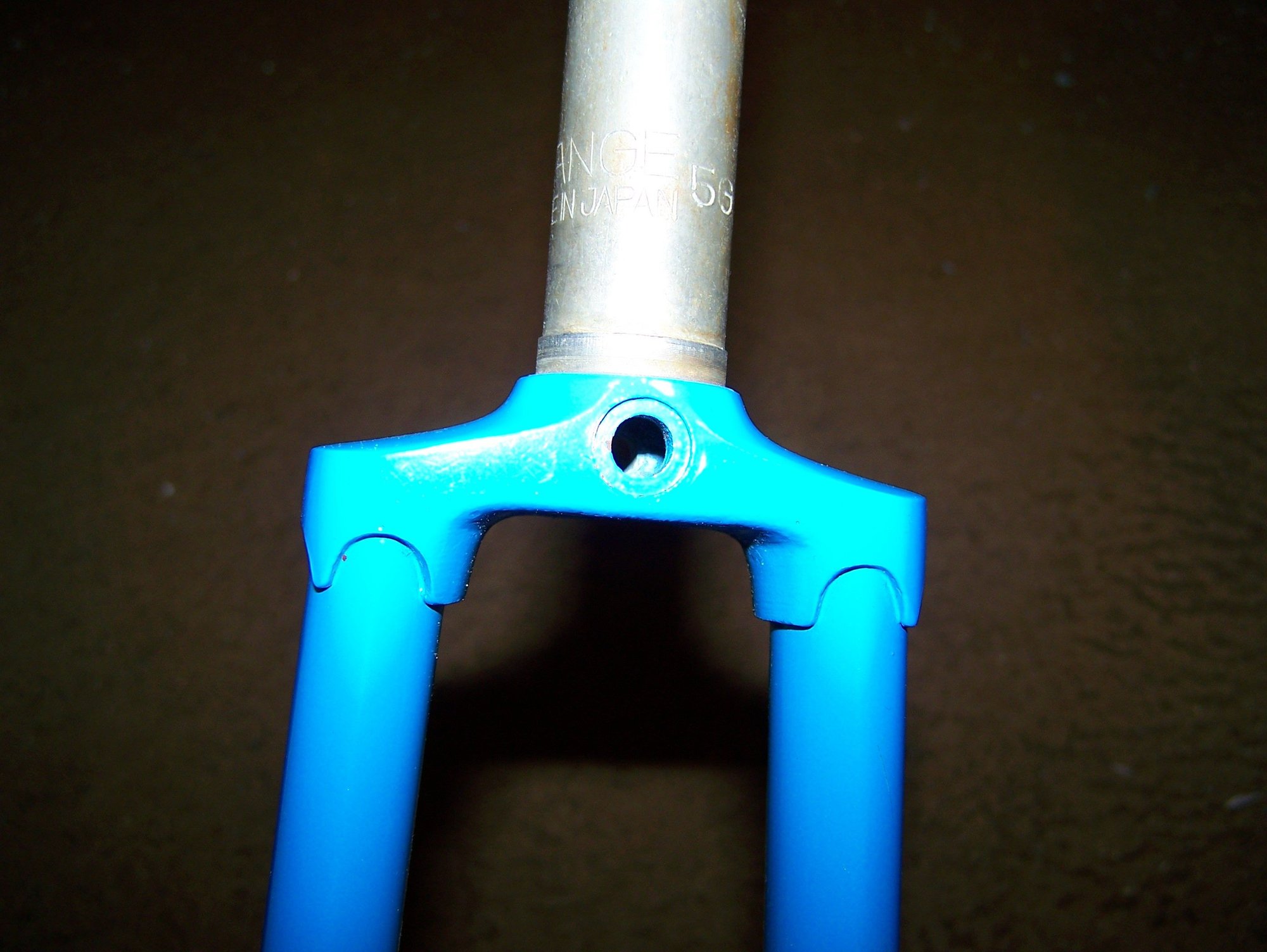

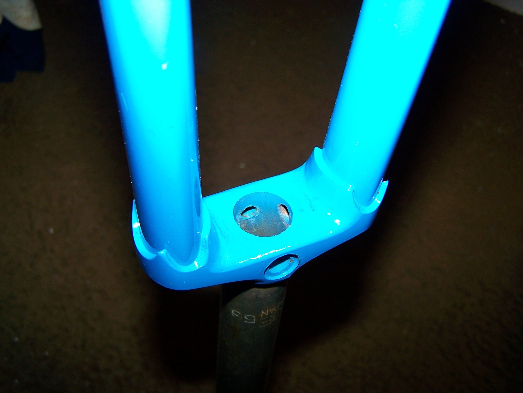

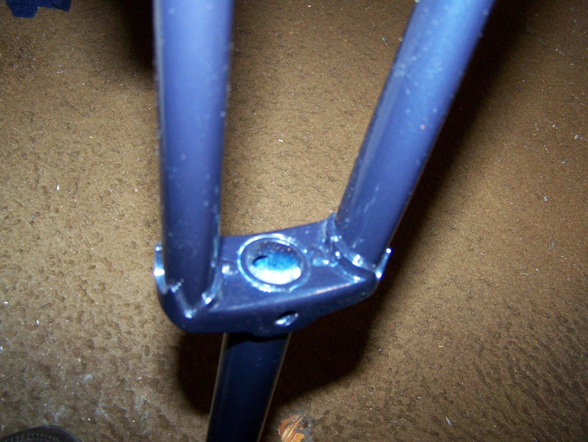

The following light blue fork is a Tange cast crown, which looks a lot like the OP's fork, this is from a 1985 Nishiki Sport and was shipped as a replacement fork under warranty and never used, I think there was an issue with the fork blades being too short for the 27" wheels, we pretty much assumed they shipped a fork for a Prestige just painted to match the customers Sport.
At a glance its similar to the Trek fork but much better built.
I've seen quite a few of both of these forks floating around over the years, my take on it was that they freely distributed them to dealers so many got left on the shelves over the years. At one point I had 30 or more of the light blue fork and a dozen or so of the Trek fork above.
thicker than the Trek crown, plus Tange is clearly stamped on the steer tube.
Cast crown, no seam
recessed brake hole

Hmmm I’ll pull the fork and see if we find the Tange stamp

Yeah I was going to say, I have an Ishiwata-crowned fork, and something about the OP's fork don't look quite like mine. @vintagebicycle has put a finger on it! The OP's fork crown looks cast, whereas the Ishiwata fork crown is stamped and welded.
Look for the weld bead on the underside. That should tell you.

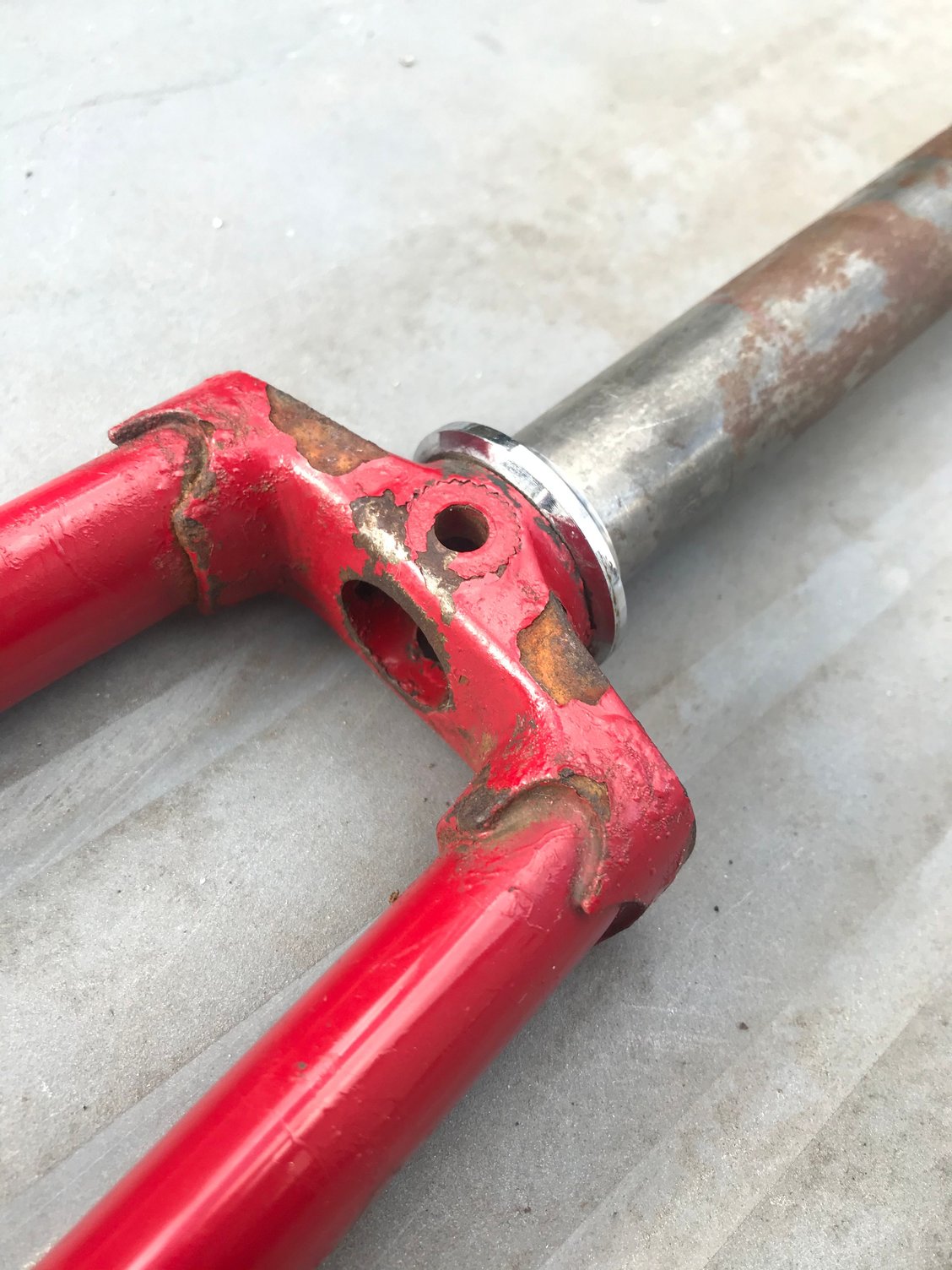

Well, it’s definitely a Tange. Says Tange 5G on the steerer, and no weld bead underneath. So the ‘85 Cdale catalog was accurate, though it does have a different lug design than the one they picture (in red above).
It weighed in at just under 27 oz (764 g) with the crown race on. Guess I’ll see about bead blasting, or will strip and treat it myself and repaint.

Now that I have a view from this angle, may I suggest taking a file or sandpaper and scraping away the rust and taking a good hard look right there where I've circled in yellow? If you can't see a decent bond with brazing filler present, but instead see a gap between the crown and the fork blade, it may indeed be questionably made, because you won't know how deep the gap is.
Not to say it's in dire immediate danger of failing if you do find a gap. I'm sure some would ride on it anyway. Just probably not worth repainting and you might want to look into a replacement.
Hey- yup, I see what you mean, and I appreciate the clear explanation. I definitely wouldn’t want to spend tons of time and effort refinishing it unless I feel good about using it
I’ll check it out and post pics.

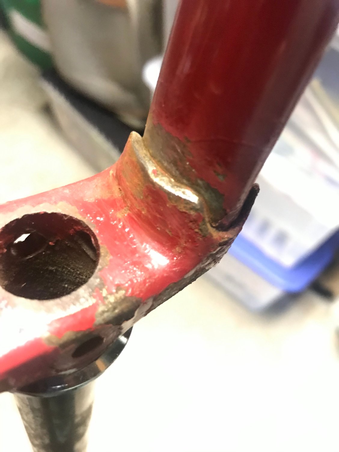

Here’s what I see so far. I can also apply paint stripper etc, but I’m not encouraged yet; I do see/feel a bit of a gap.

Stick a needle or pin in there. Scrape it back and forth in the gap. Does it feel like it's touching filler metal? Or going deeper into an empty void?
I think I see filler metal (bronze or silver) in the gap, only a little below the surface, in that last picture.

I see what you mean now. I scraped more in the gap itself, and there’s no void- bright metal. Just a gap at the corners of the lug/fork blade juncture, so I’m likely ok if I want to keep it?

Just a little under-filled
Don't bother with the tangs, if you were thinking about that. They don't do anything to stop cracking. That crown doesn't look cast to me.

Yep, seems like all's well!
