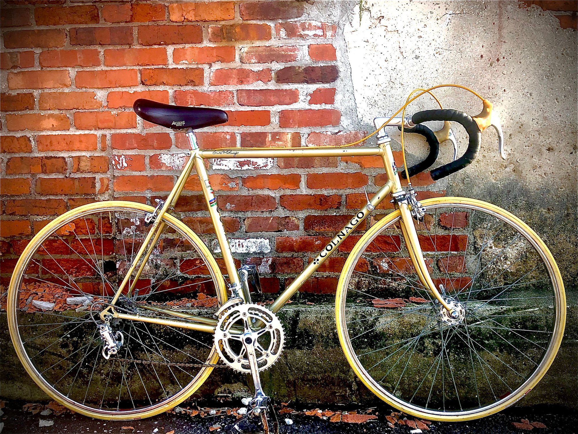

There are MANY great bikes out there....MANY.
I LOVE all my bikes and I am lucky enough to own a Colnago Super 1976.
Maybe it's in my head or real.....I cannot even hear it when I shift it is SO SMOOTH !!!!!
So I would suggest to the OP to test ride an Italian bike and see for yourself.
I prefer steel. I have ridden aluminum and they are fast and light....but harder on my body
My go-to bike is a Schwinn Sports Tourer 1973 VERY smooth...BUT it weighs in at 31 pounds !!
The Colnago is 10 pounds lighter !!!!!
To me there is greatness in all bikes.........................it's just what you want to get out of it...................

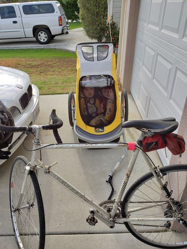

I had two bicycles that should have been comparable: 1980 Peugeot PKN-10 and 1982 Bianchi Campione d'Italia. Both had moly steel butted main tubes. In fit-and-finish craftsmanship, the Bianchi was very noticeably superior to the Peugeot. I also liked its lower bottom bracket, but I did greatly appreciate the Peugeot's more generous tire clearance. The Peugeot was one size too long and too tall for me, so I gave it to my elder son.
Erik and Henry on Pi day (3/14) 2020, waiting for their dad to give them a trailer ride. He is really thankful for that 34T granny ring I added.
