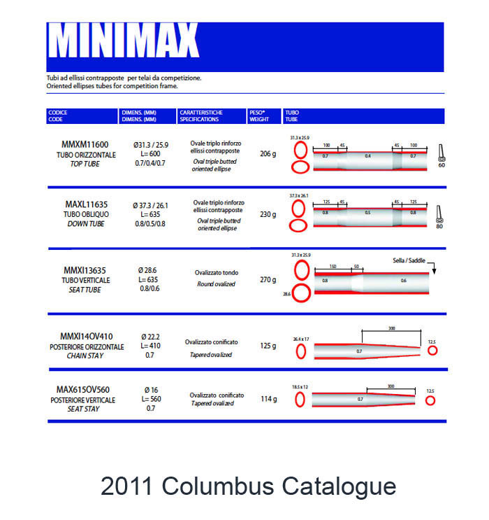

i bought this frame a few years back, and i would like to find out what tubeset that is.
The facts:
Brand: "Learco Guerra" - bought it as such from italy, fork crown has "LG" engraved, BB has "GUERRA" stamped in. Billato says they didn't make it. (clearly a "label" brand)
Tubes are partly ovalized and oversized, compared to a SL or similar. Similarities to MAX, but it isnt it, see below.
The Upper Tube is ovalized "vertically" at the front and "horizontally at the end
The Down Tube is ovalized on the front, but round on the lower end
The Seat Tube is round
the diameters are smaller than MAX would be:
Diameters:
Upper tube: 32,5 x 24mm at the front, 25x32,5mm at the rear end
Down Tube: 32x24,5mm at the front, 28,6 at the end
Seat Tube: round 28,8mm
Rear triangle:
Chainstay: front oval 15,5 x 23,4mm
Seatstay: 12,6mm round
it is lugged and the lugs fit *very* well, this is no amateur job.
Since such tubersets require the matching lugset, i think i can rule out a "bastard" frame made from different tubesets, or "homemade ovalizing"
Question: Could this be Columbus MINIMAX? I found one source that says MINIMAX was only made for Merckx and never (or very sparsely) available to other builders (?!)
Dropouts are (very pretty) Columbus with the dove symbol cast in.
can anyone shed light on this?
I don't think that's true, although they don't come up much, there are plenty of non-EMC examples of Minimax. I was eyeing off a Minimax frame built by Sorenson in Australia - that's a long way from Belgium. Unfortunately it was the wrong size so had to let it go.
Anyway, you could check your tube sizes against the Minimax data:

This is a spec sheet I found online - almost a match,looking at the dimensions?

Originally Posted by martl View Post
this is what I have right now (it's night here) - can make some better ones of the stripped frame tomorrow!
Yes, that could possibly be a MiniMax frame. 1 thing..please relieve it from that current build..does not do it justice.

Minimax was not custom-built for EMC
EMC did not build the frames with Columbus Minimax
In the kit produced for EMC (Columbus Mxl) only TT came from Minimax (and was assembled in reverse)
