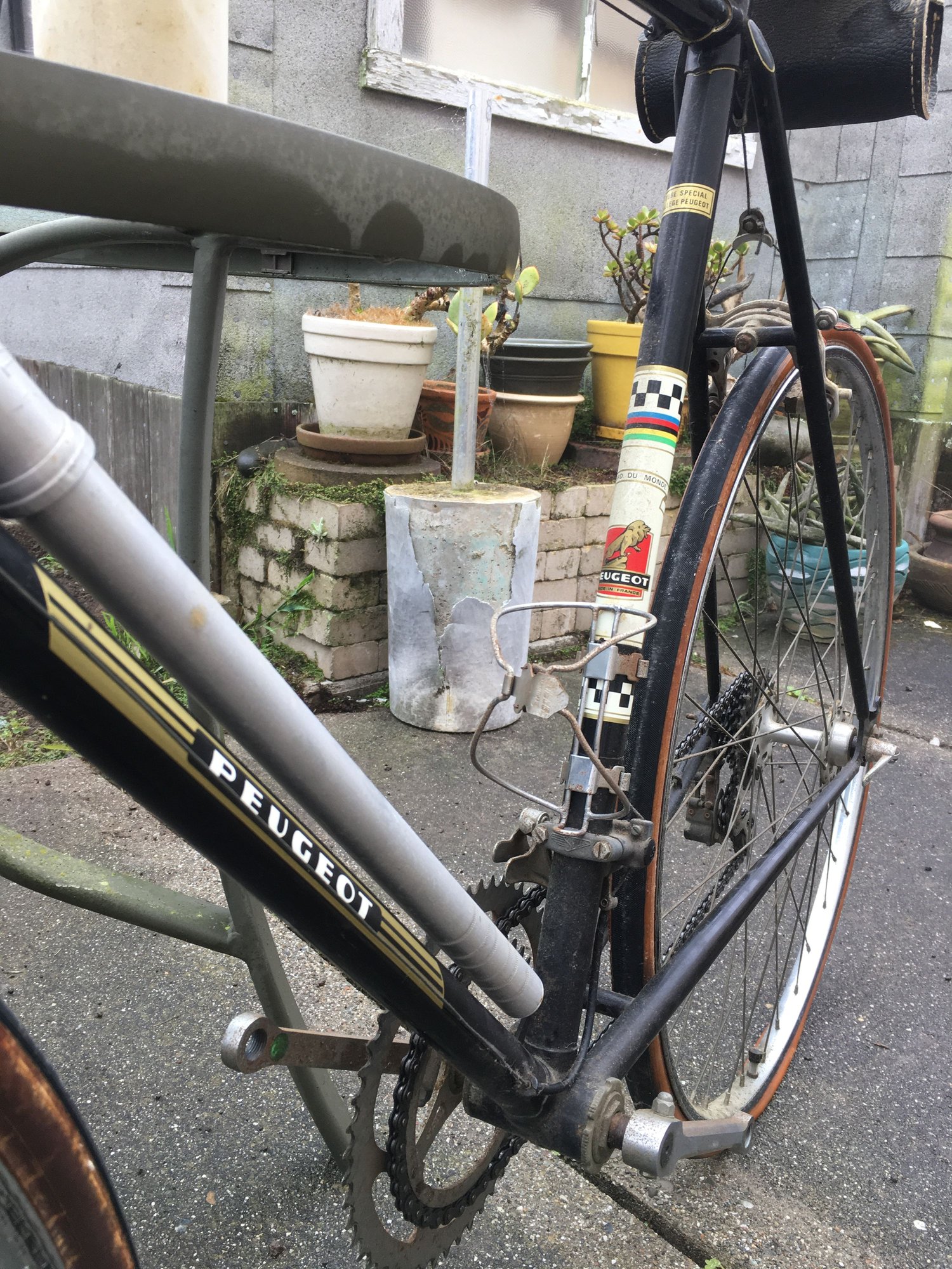

Hi Folks - I would greatly appreciate any help with identifying the year/model/value or any other particulars you think are of interest. I've listed below all markings I could find and tried to take relevant pics (I regret I am not very bike savvy!). The bike was last ridden in the late '80s and has been stored since then and needs a good cleaning, and tune-up in order to get it back on the streets in the San Francisco bay area. There is also an extra set of wheels with the same markings as those on the bike. Many thanks in advance for sharing your knowledge and expertise
Record Du Monde
Tube Special Allege Peugeot
Serial# 1728044 (underneath side of bike)

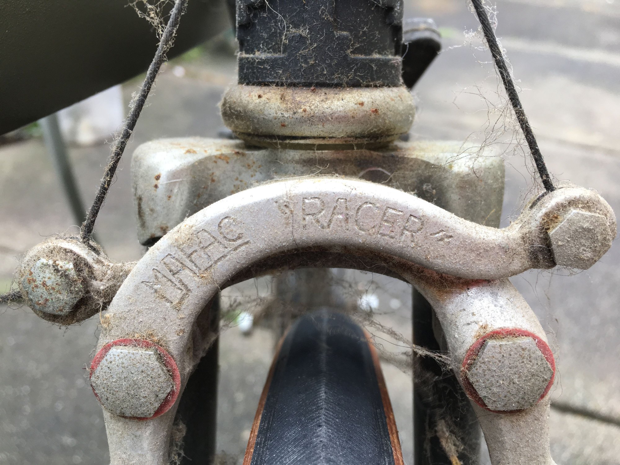

Mafac Racer

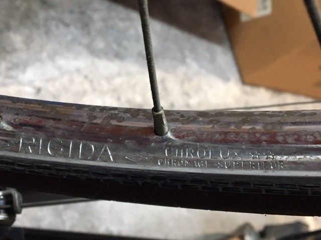

Rigida Chrolux wheels
Normandy (center of wheel between spokes)

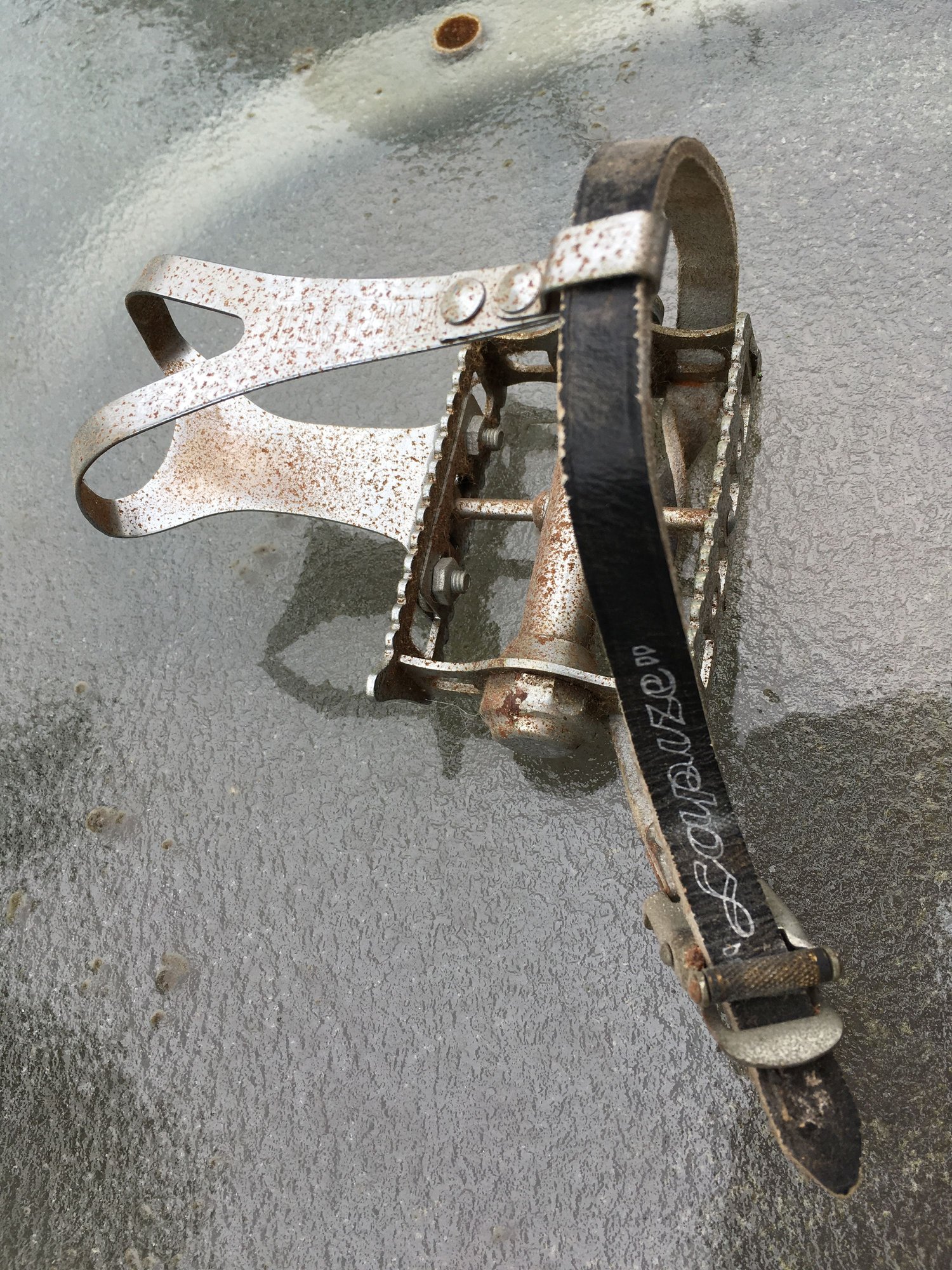

ADGA Chatillonnaise on seat
Lapize / Lyotard pedals

hello shern,
thanks for posting
fine job with the pictures
model is called U08
date is 1971
you will find a marking on the backside of the bicycle's Simplex Prestige rear derailleur with a date mark
it is great that the bicycle is so all original and has no damage
usually by this age they have had parts changed and show usage wear
hope you enjoy it, if it is a reasonable size for you

Shern. Really nice nice looking bike you have there. Those MAFAC brakes work great. Nice to have the frame pump, gloves, water bottle and the bottle cage is a neat piece. The rope is a mystery, maybe to hang from a beam in garage? A little soap and water and the bike will shine! Cheers. Kevin.

Brake blocks are OLD, Kool Stop replacement pads would be the way to go.

pedals are metric thread 14mm X 1.25 and marked D and G on spindle ends. They are Lyotard model Nr. 36.

Lovely bike and well worth fixing up and riding. Alloy wheels will be a big help performance wise if rebuilding the bike.

Funny ... as I read this thread, I thought someone has to mention aluminum wheels. It's not for looks. It's not weight, though aluminum rims will weigh a lot less than the steel that's on the bike now. It's for safety. Steel is VERY hard to stop when even a little wet. If it's possible that you may have to go down a hill in a serious fog, and you have steel wheels, you will be in grave danger. (Every time I've been in SF it's been sunny. )
