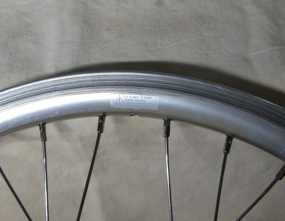

Yes. Caliper brake wear on aluminum rims happens. If you don't replace the rim it can crack and the tire blow out. Modern rims have a "wear indicator" machined into the brake track. When the indicator disappears it's time to replace.
Years ago I had a well-worn rim explode as I was riding along. Fortunately I was riding at a mellow pace on a bike path. Still, I had to wait a couple hours for my wife to ride home and fetch the van.

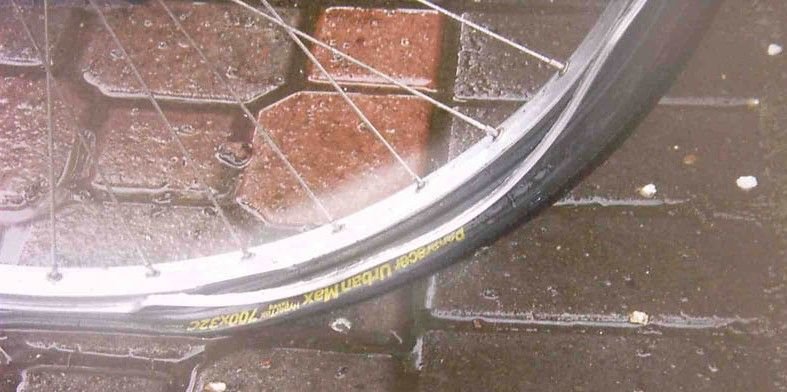

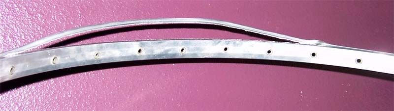

I can verify this, as it's (nearly) happened to me several times on my commuter bike. Luckily, before the rim disintegrates it begins to expand in width at the weakest point and a distinct "thump" happens when the brake is applied. Close inspection will reveal the source of the thump, and immediate rim replacement is indicated.
In my experience, this always happens on the rear wheel... for reasons I don't fully understand, because I use the front brake more heavily than the rear. It certainly could happen on a front rim though.
Imminent rim separation; lateral view
Imminent rim separation; radial view... THUMP!
Can't say I wasn't warned!

1. Feel your front rim's brake surface with your finger. If it feels noticeably convex it's time for a new one.

Unless the bike was ridden on wet sandy roads I doubt the rims need to be replaced. Just because you see fine wear marks, they occur shortly after you get the bike.
As an aside the pictures of the worn out rims that have broken go against what riders that dont like disc brakes say.
