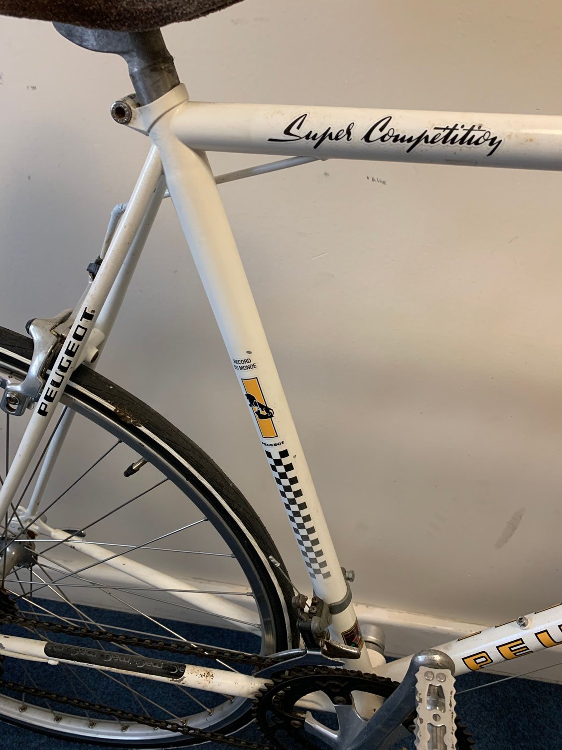

Hi,
Hope everyone is well and staying safe during lockdown!
I bought a Peugeot Super Competition on eBay a few weeks ago and hoped you guys could help with some information and advice.
Hereís what I know so far:
Frame: Peugeot Super Competition with Reynolds 531 tubing and white front fork. Frame number Y101 2003
Bars: La Bonneville Iton 27190 CTA
Chainset: Unknown. The only marking I can see is Dotex on the plastic covers on the cranks and D0 Made in France on the inside of each crank
Drivechain: Shimano shifters and front/rear mechs, 7 speed rear cassette
Brakes: Exage Motion levers and I think matching brakes
Wheels: Campagnolo Berlin 36 front, Mavic T238 rear
The bike is roadworthy, with a few chips and marks on the paintwork and some outer cables need replacing. The brake hoods are missing but Iíve bought some of the same brakes with the hoods in place.
From what I can tell, some of the components have been replaced as I canít see that they would match the age of the frame.
My plan is to service the bike, ultimately to sell on as part of my education in fixing up older bikes. But Iíd love to know what you guys think, what age some of the bits are, and what youíd do to the bike to make it as desirable as possible.
It was only a cheap find on eBay, so donít feel bad if youíre writing something mean!
Many thanks,
Kev

I'm certainly not a Peugeot expert, but I don't recall any non-lugged 531p framed "Prestige Peugeot" bikes.
I think someone stickered up a lower-level Peugeot.
First thing I would check - what's the seattube OD and the seatpost OD?

Thatís what I was a little concerned about. Seat tube is 29mm OD, seat post is 25mm

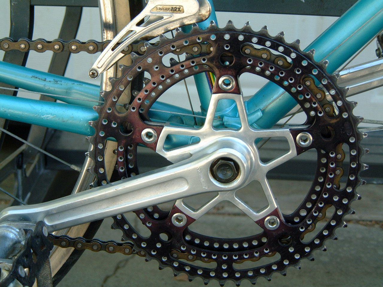

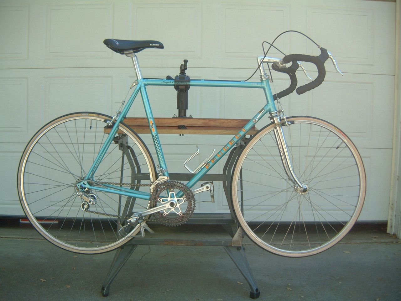

...not certain what that bicycle started out as, but here are a couple of Super Competition's for comparison reference.
You can note the many differences.........do you have any recourse through ebay ?

...also, whoever applied those Peugeot stickers was not very good at it. Note how low the downtube sticker is positioned as opposed to an original.
Thanks for that, itís clear when they are side by side like that!
To be fair, it was advertised as a ĎPeugeot Vintage Racing Bikeí with no mention of Super Competition, it was just me who jumped to that conclusion! I didnít realise it was so easy/common to re-sticker bikes. Oh well, all part of my education!
Oh yeah! Again, itís really obvious now youíve pointed it out!

Speaking of decals, do I see two different Reynolds 531?
