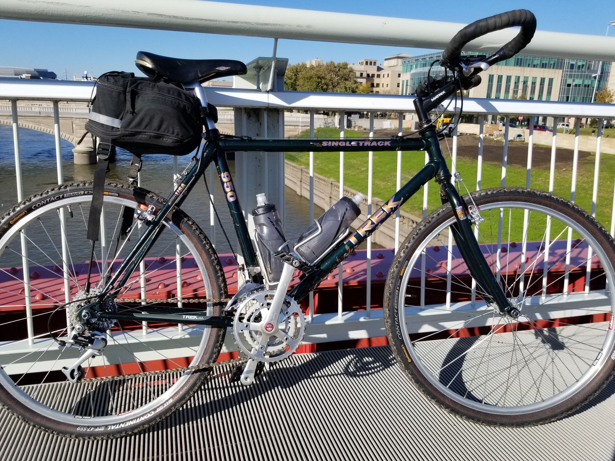

Trekking bars are a good choice for vintage MTBs. They offer a lot of hand positions and your old parts will work well. Plus they're cheap. A Jones bar is not cheap and you will likely need to get a threadless converter since it is 31.8 and you are going to want a stem with a plate to install it.
This is my '92 Trek 950 with trekking bars; it's a good ride on gravel as well as the road:

That's a good looking setup and similar to what ive got in mind ---- I just got the quill to threadless adapter yesterday and My LBS ordered the H bars for me with the 2" rise -- I figured if theres not too many reviews out there on them, I may as well take the plunge and review them myself --
