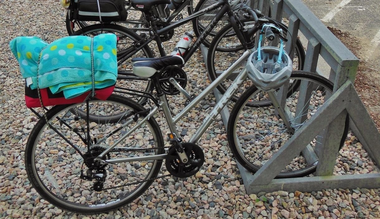

if you don't want a drop bar bike, maybe what my Wife uses would interest you. It's a Trek FX Stagger which has a steeply sloped top tube
rumrunn6 is offline
WIth a dropped top tube, you could go to the larger size to give you the longer length from seat to head tube. THe shops all want to force you into a compact frame. They recommended a 53cm for me and I bought a 55cm and still have decent 2-feet on the ground stand over. I am 5'8.5" with a 30" inseam.

Originally Posted by nivalu
when considering standover height, im not sure if it should be comfortable standover, or standover with the bike kinda.....up in there. it would seem like a frame that was 2-3 cm smaller than the size is take based on height wouldn't feel so......violating?
I, too, despise being pinched "up there."
Myself, I am fairly short-legged for my height. I've always had to worry about stand-over height (SOH) on bikes I've ridden. And I have always looked for smaller frames, frames with angled/dipped head tubes, or even step-through type designs.
A frame design like this seems to work best for me, given my shorter legs and max-SOH limit:
Through the 1980s and 1990s, a number of popular bike makers created step-through variants for some of their standard models of ATB/MTB.
At least up through 2015, Trek made the FX bike in a step-through variation, with their FX WSD.
* That one's a Rodriguez Adventure bike, the step-through variant.
Another option might be a Mixte type frame, which has a heavily-sloped top tube(s):
* That one's a Soma Buena Vista frame.
If wanting a bit of an upscale type of bike, perhaps consider the Rivendell Cheviot step-through model:
