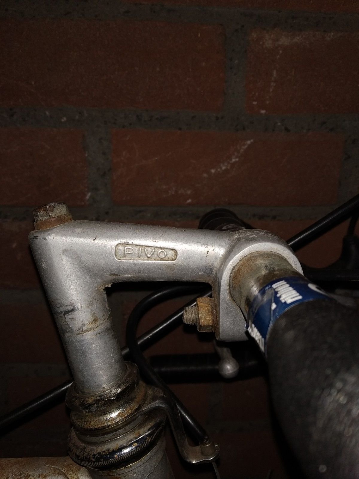

The grey bike has stayed almost completely French
The Reynolds decal on the down tube suggest that it should be after '74, right?

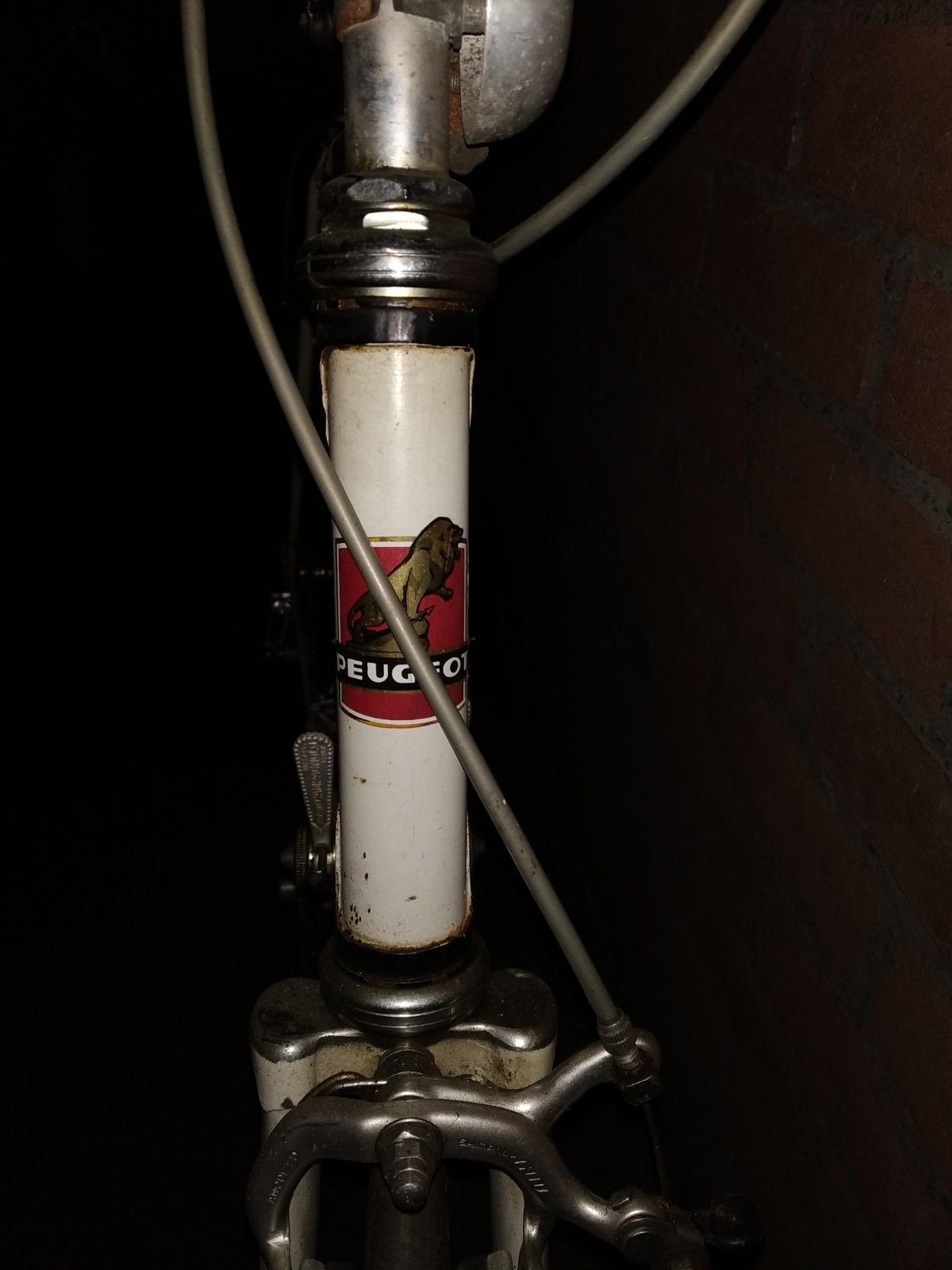

The head badge indicates that it is either '75 or '76
The only non-French part I could find so far
I've actually got two of them, because why not? And both are the same bikes more or less and even the same size: 59.5CT, which is kinda a French fit for me. Perfect!
Here are the pictures.
Bike 1. Should be '75 or '76 according to https://www.bikeforums.net/classic-v...-timeline.html

Bike 2. Falls into time period between '71 and '73, judging by its head badge and Reynolds decal

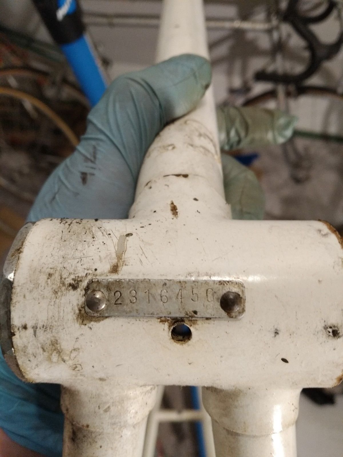

Stripped the white bike today. The frameset should clean up quite well, gonna be doing that over the weekend.
The serial number is 2316450, which means that it is from 1972, I suppose.
A bit confused with the headset, the locknut is marked with 25x1 (French) while the crown race is marked with 26.4 B1. French should be 26.5, right? The headset is Shimano UA-100, but Velobase doesn't mention French UA-100 at all.
Frame number
Crown race marking 26.4 B1
Frame number

It seems like the black version of the headset was available in French configuration, at least according to Velobase. Anyway, I've got a mishmatch plus the locknut washer is missing.

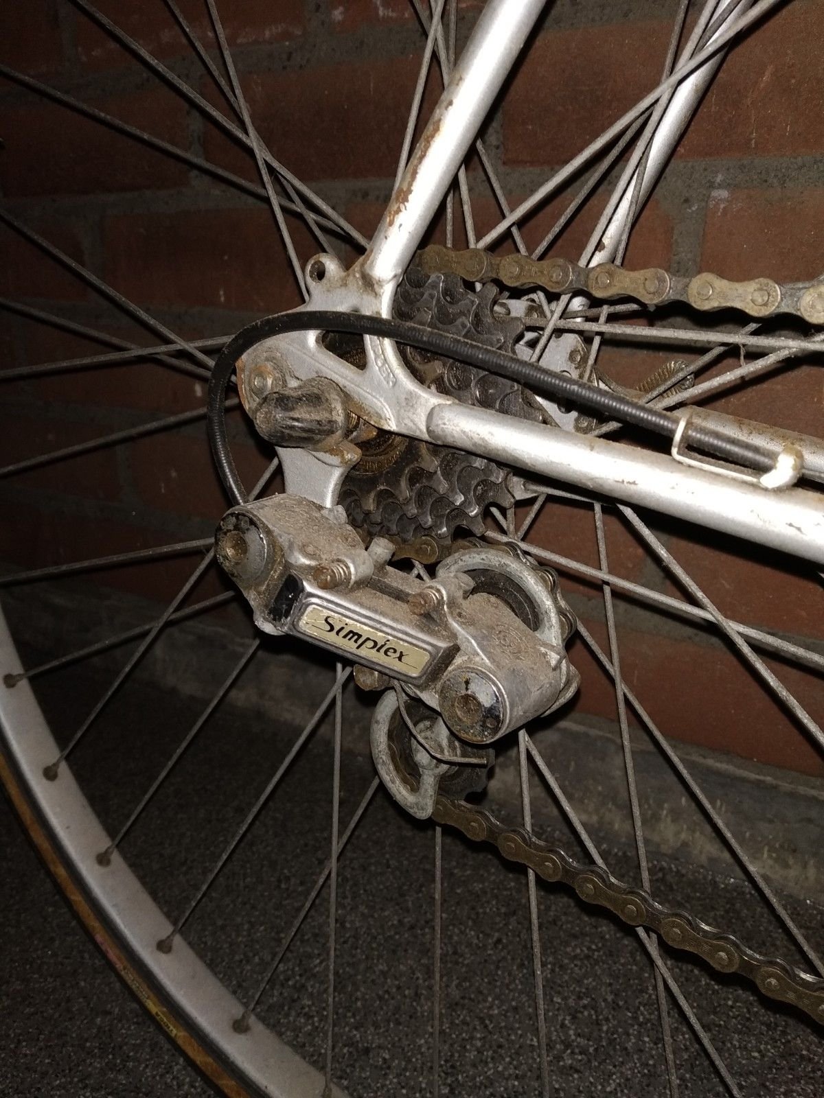

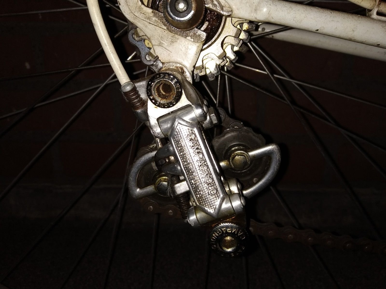

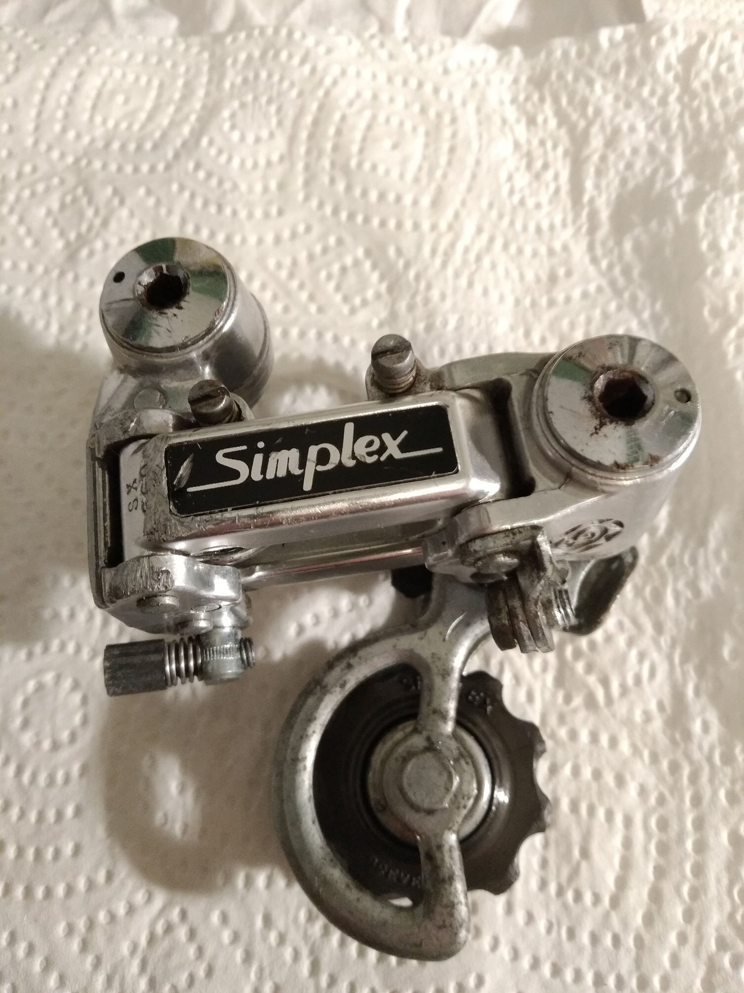

I think I ruined the Simplex rear derailleur , I posted about it here

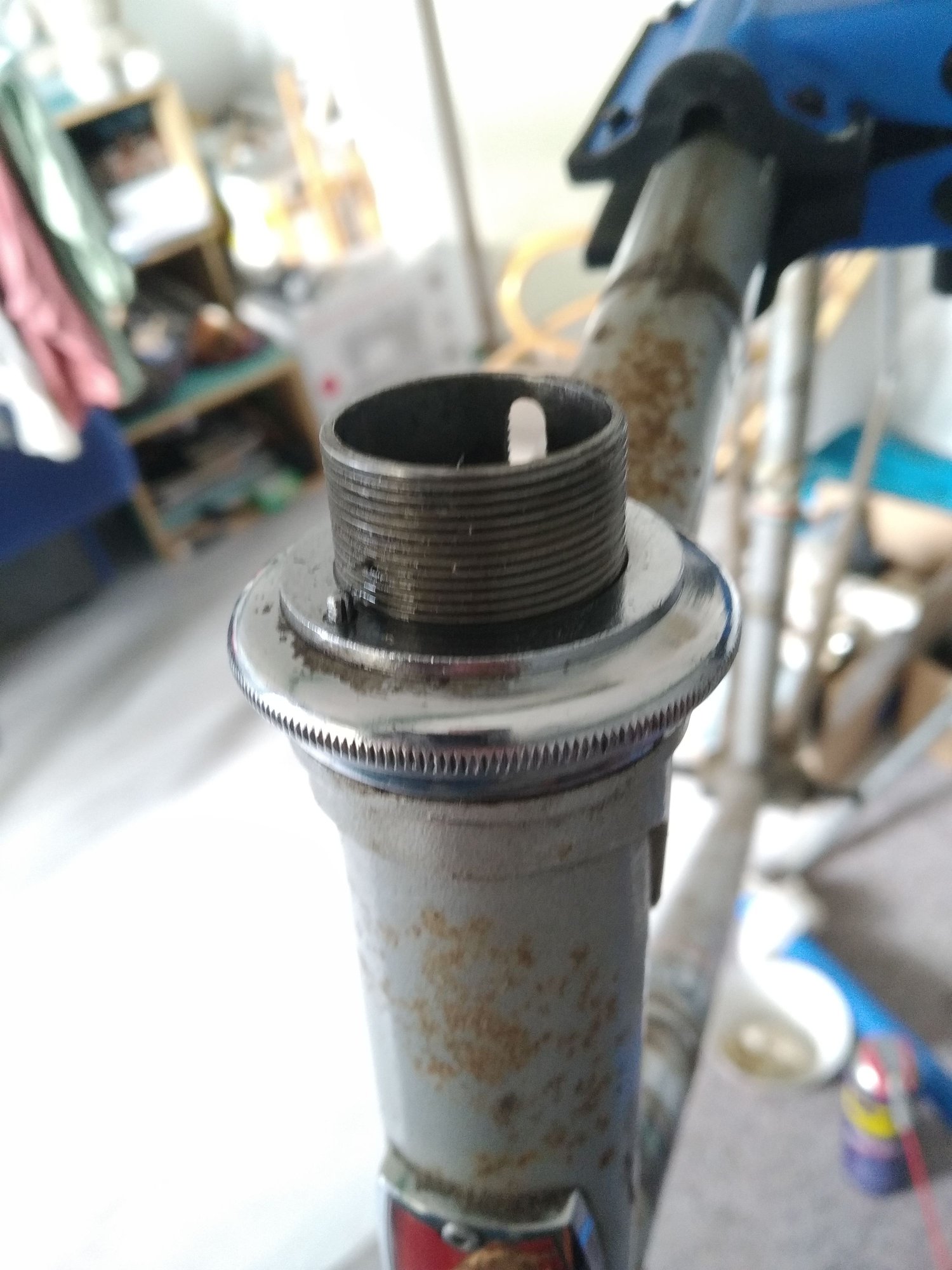

Also, I can't remove the headset adjustable race cup from the grey Peugeot . Nomally, they can be unscrewed quite easisly even without any tools but not in this case. It seems that someone might have used threadlock on it. I have to find larger tongue-and-groove pliers and try it again.
The adjustable race won't come loose

The French Standard for the headset crown race is 27.0mm ID. Some Japanese headsets are/were made in that diameter but most non French headsets have a 26.4mm or 26.5mm ID.
All Campagnolo headsets have a 26.4mm ID... But I think the NJS Keiren track racing standard is 27.0mm so Campy maybe makes some special headsets for that market???
verktyg
verktyg
Chas. ;-)
Chas. ;-)
Join Date: Oct 2017
Posts: 361
Quoted: 157 Post(s)
Liked 113 Times
64 Posts
verktyg
verktyg
I saw on the website of Sheldon Brown that French headset crown race I.D. can be also 26.5mm. Is that so?
I suppose that the crown race seat in question has been reamed to accept 26.4mm crown races. Standard French crown races most likely won't work anymore, will they?
Join Date: Feb 2017
Posts: 4,139
Bikes: More bikes than riders
Quoted: 1443 Post(s)
Liked 759 Times
568 Posts
Join Date: Oct 2017
Posts: 361
Quoted: 157 Post(s)
Liked 113 Times
64 Posts

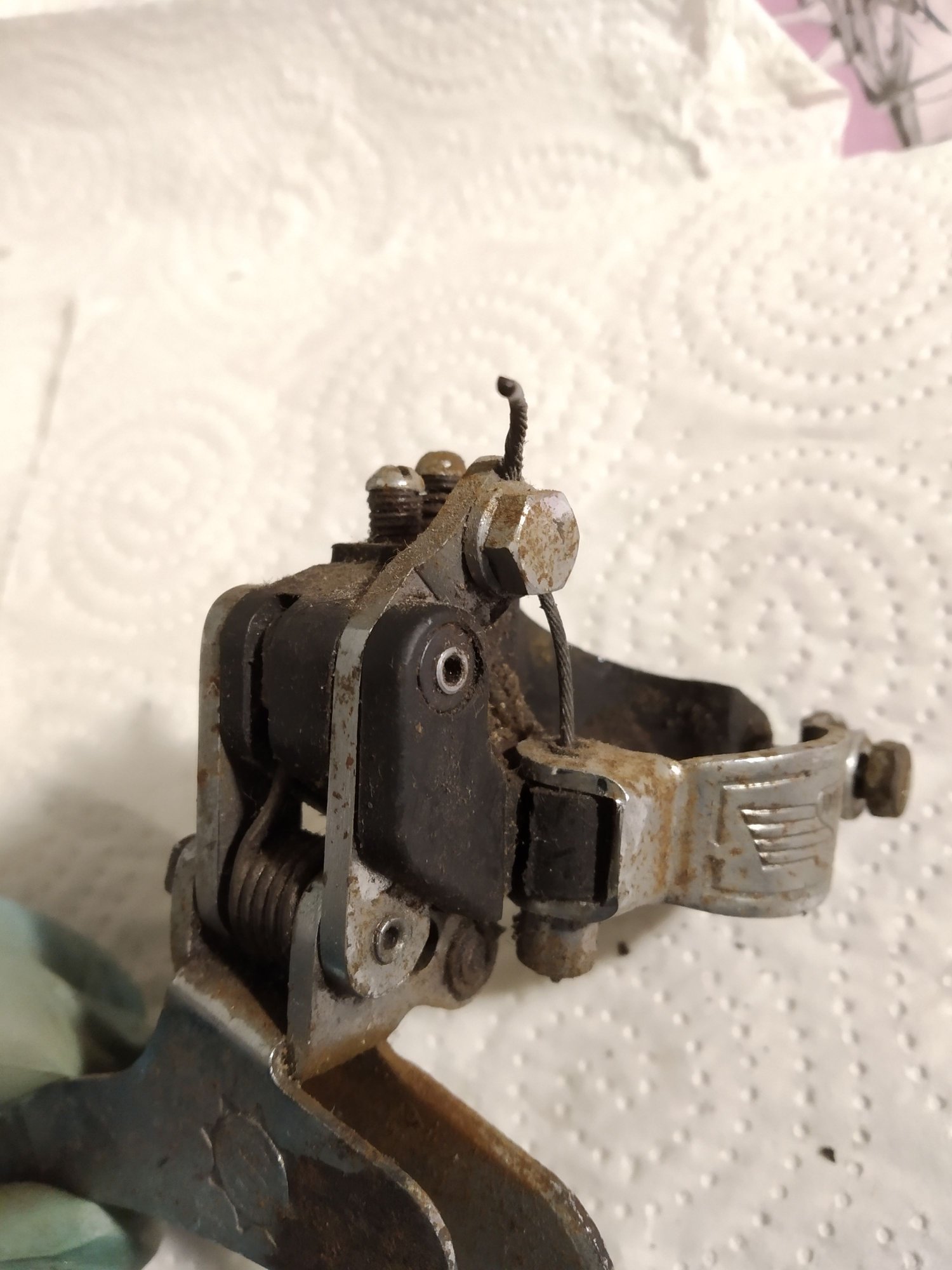

I've got a new derailleur which I am gonna use for the build (white bike). It came attached to a bike which I still have to get rid of . I did't dare to disassemble it completely this time, I soaked it in WD-40 and brushed off all the grit and dirt.
Simplex SLJ SX660, a bit scretched but should work fine
The front Derlin derailleur is broken, by the way, which I kinda missed before. I should have a replacement laying somewhere around so that is not a big deal.
Broken front derailleur

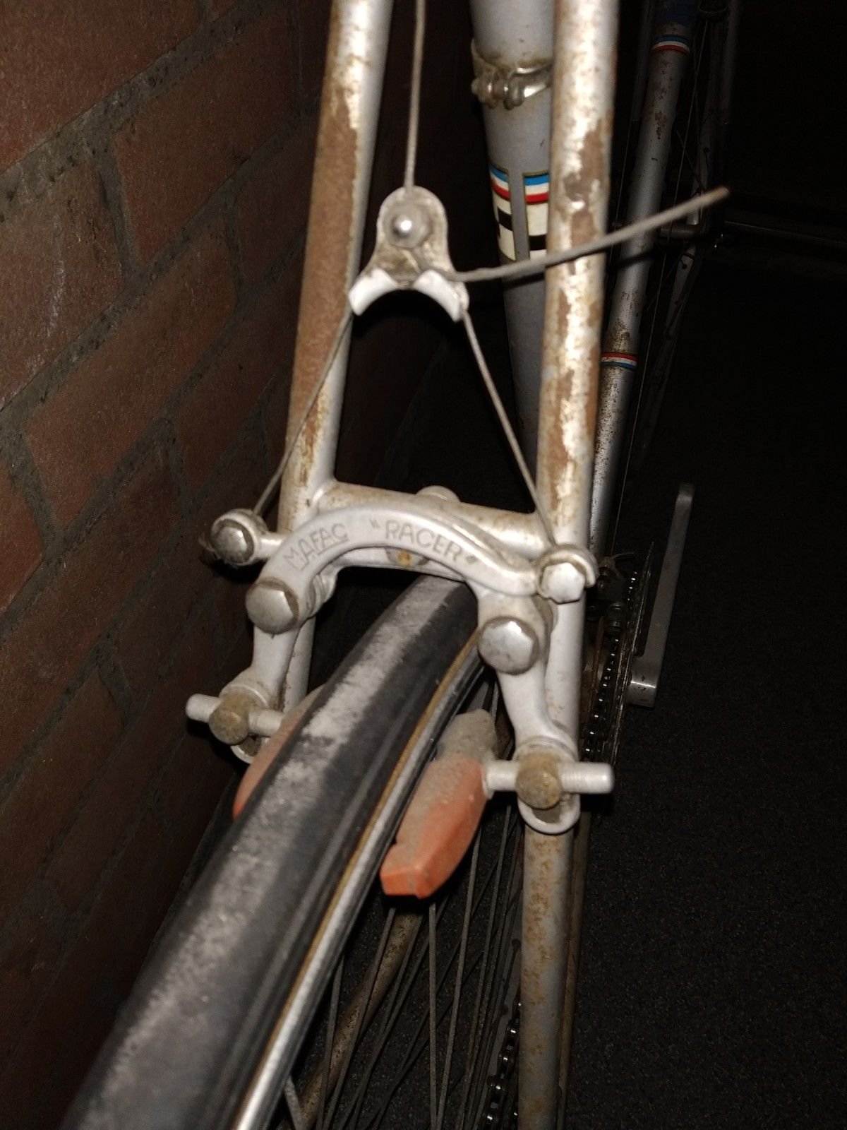

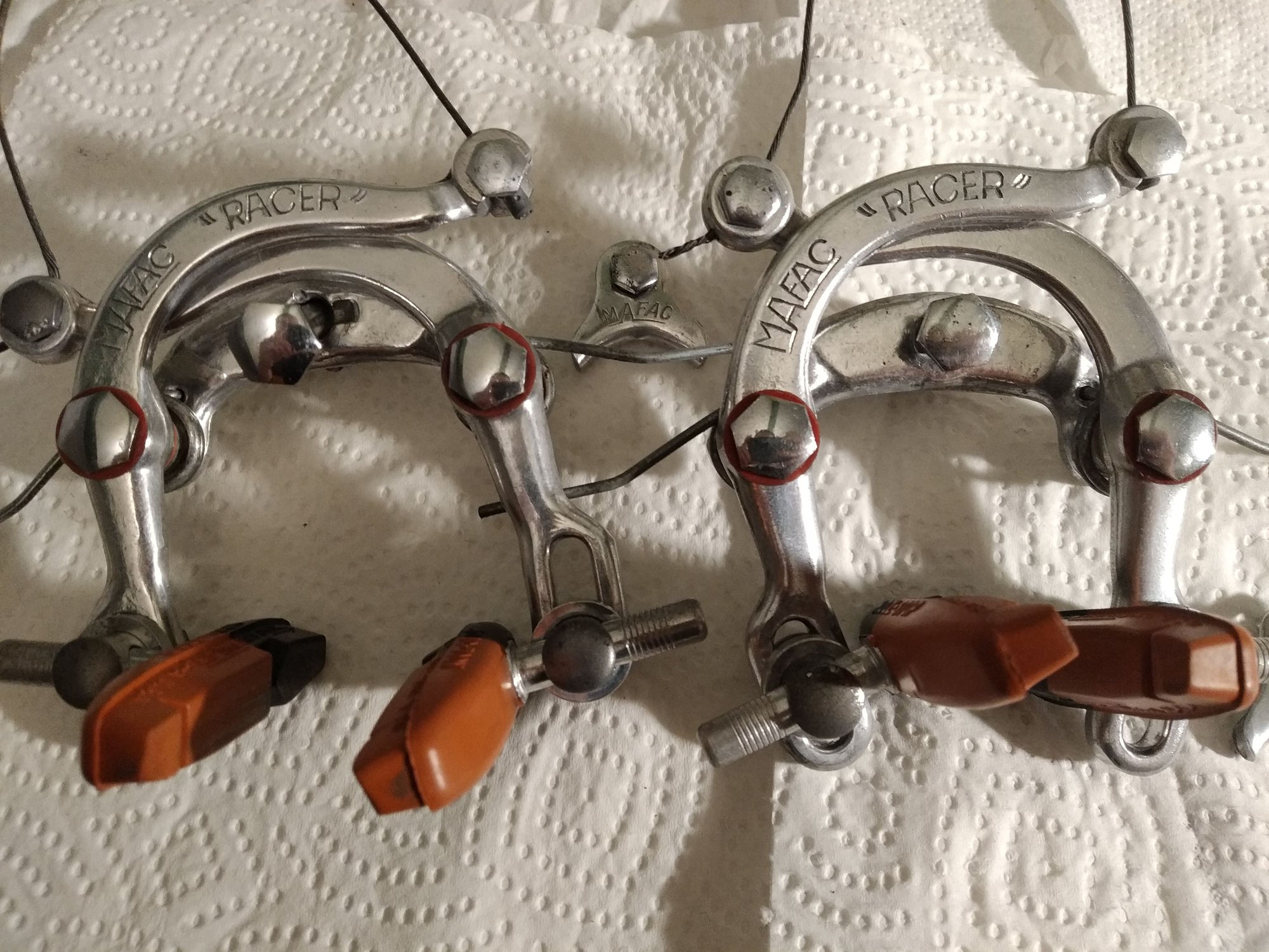

I've been also working on other fittings such as brakes, pedals, bottom bracket snd some other small parts. Cleaning and polishing mostly.
Mafac Racer brakes after polishing
I have to deal with the seatpost tube which appears to be ovalized. The bike came with an undersized seatpost with a shim and the seatpost binder bolt was tightened super hard.

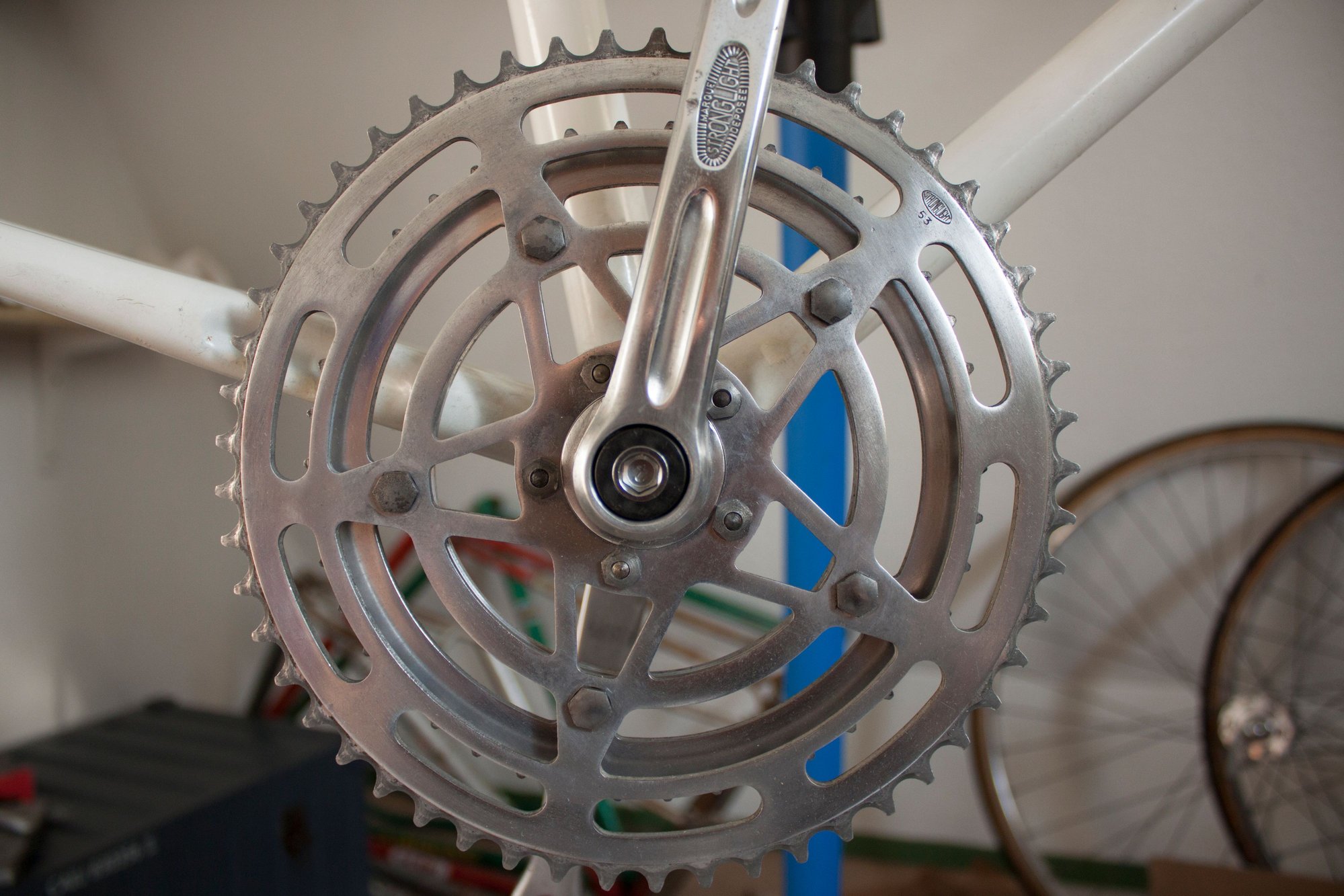

A small update on the project. I was able to fix the seatpost tube on the white bike a bit, it now accepts a 26.6 seatpost which is about right, I suppose.
Cleaned and polished the crankset, I could have done a better polishing job, but even this took me like 3 or 4 hours.
Stronglight 49D after polishing
After inspecting the bottom bracket cups, I decided that it needed replacement. I tried to remove the fixed cup from the other bike and see if I could use it, but it was super stuck. So in the end I just ordered a new sealed BB which gonna replace the Stronglight unit on the white bike. I am also waiting for some other parts, among others a headset, which was not good either (on both bikes actually). Once the parts are here, I will be able to go ahead with the build.

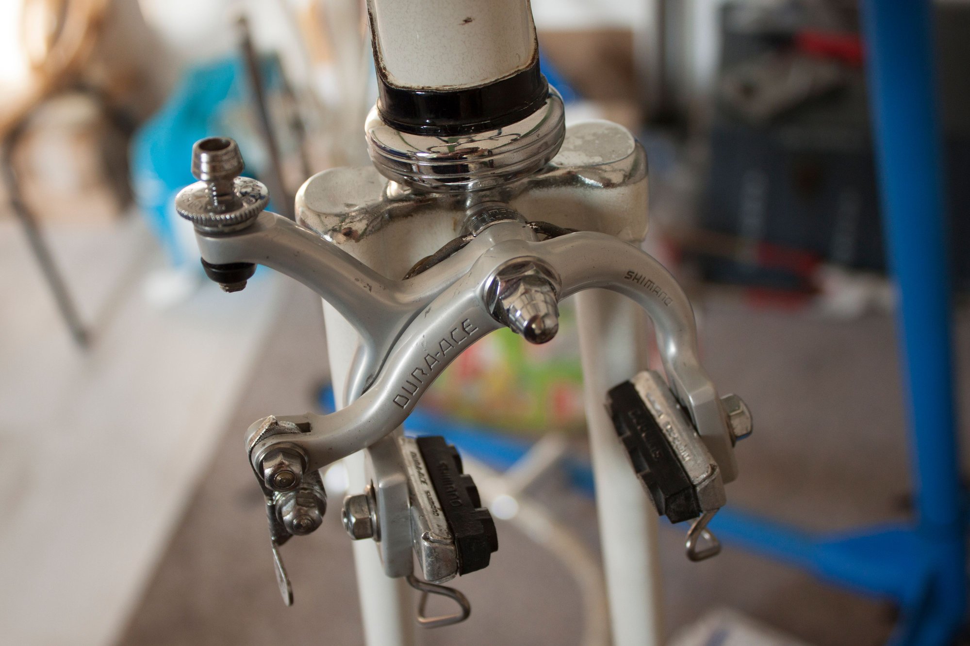

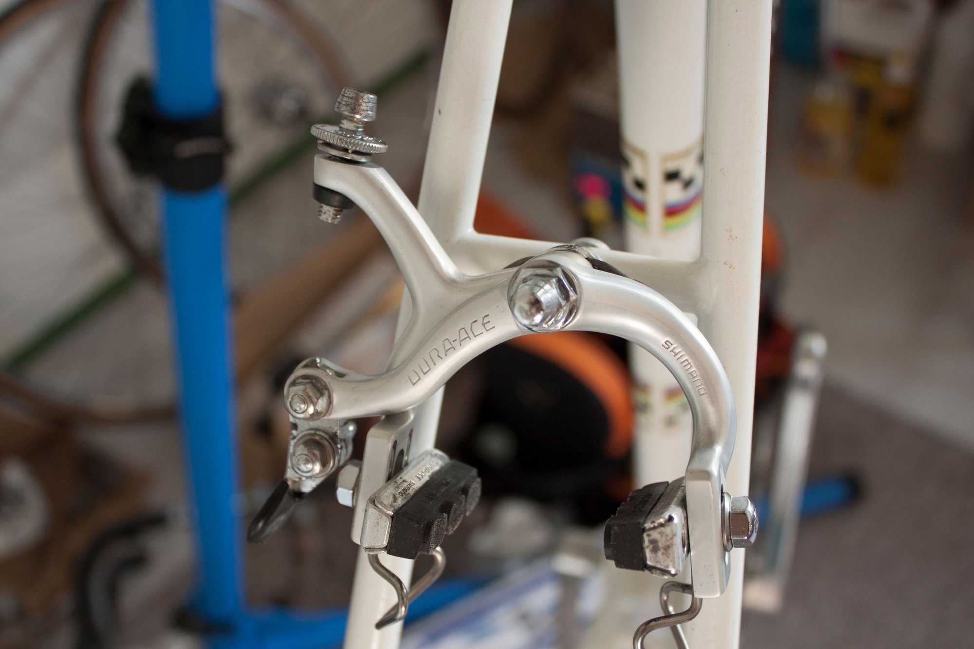

Decided to keep this Shimano DA headset which came with the bike. This actually meant that there were no threads left for a washer/Mafac cable hanger. I could have tried using smaller ball bearings I suppose but I was not really attached to Mafac brakes that much.

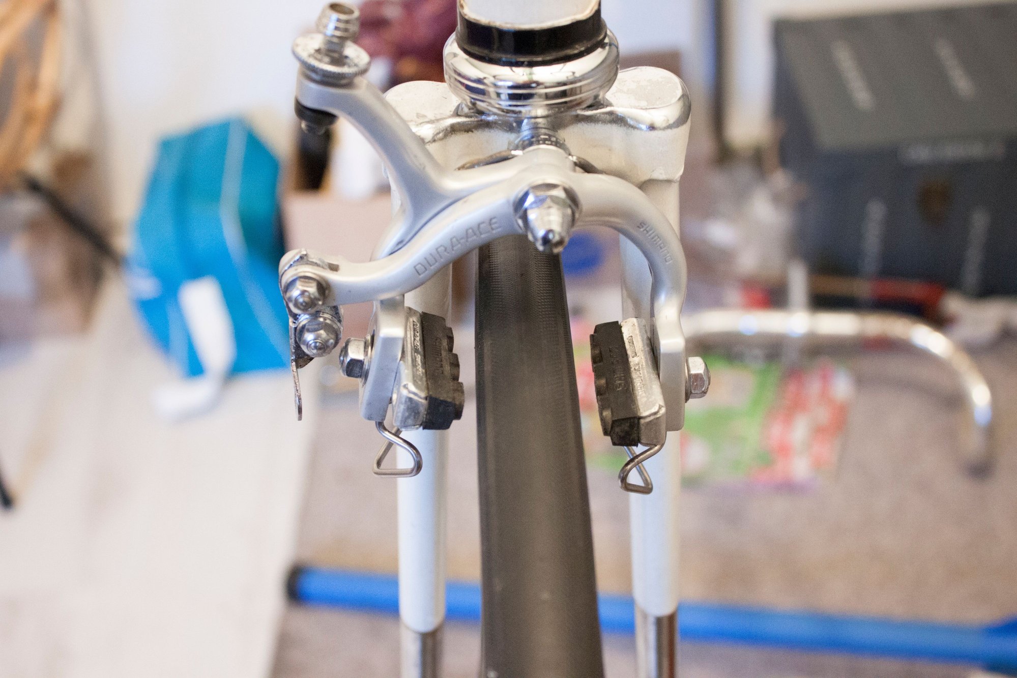

Will be using this Shimano DA brakes which I already had in combintation with Shimano 600 brake levers which also came with the bike.

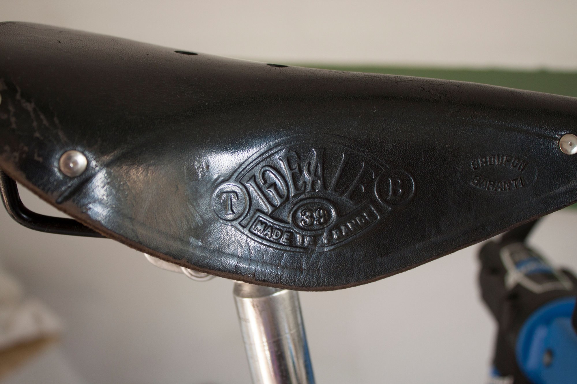

Gonna give a try to this Ideale 39 saddle
Rear brake installed
I ended up using a Token BB with french cups which I ordered from Velosaloon. Gotta check the chainline but it seems to be just fine
This is where I started today

So this is what I discovered once I reinstalled the front wheel. I have to find someone who's gonna straighten the fork for me.

Yes, exactly! I double checked the alignment after I had discovered this issue and it was fine. The fork blades seem to be bent sideways though. I wrote before that I have spread the fork ends to their nominal OLD, which caused this problem. The fork end on the right (in the picture) seems to take all the deformation.
