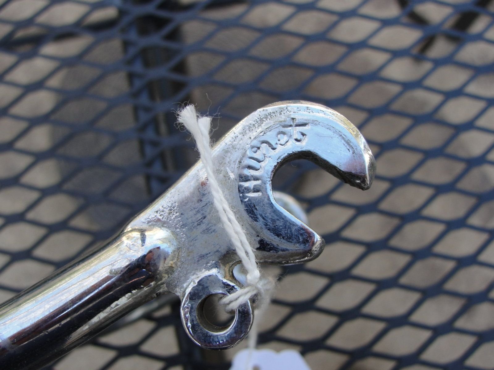

not all Schwinn Super Sport model cycles of this time received the same fork
here is the fork of a 1966 example
the crown employed is the NERVEX Pattern Nr. 6

Nice! My fork doesn’t have that crown. 😩
