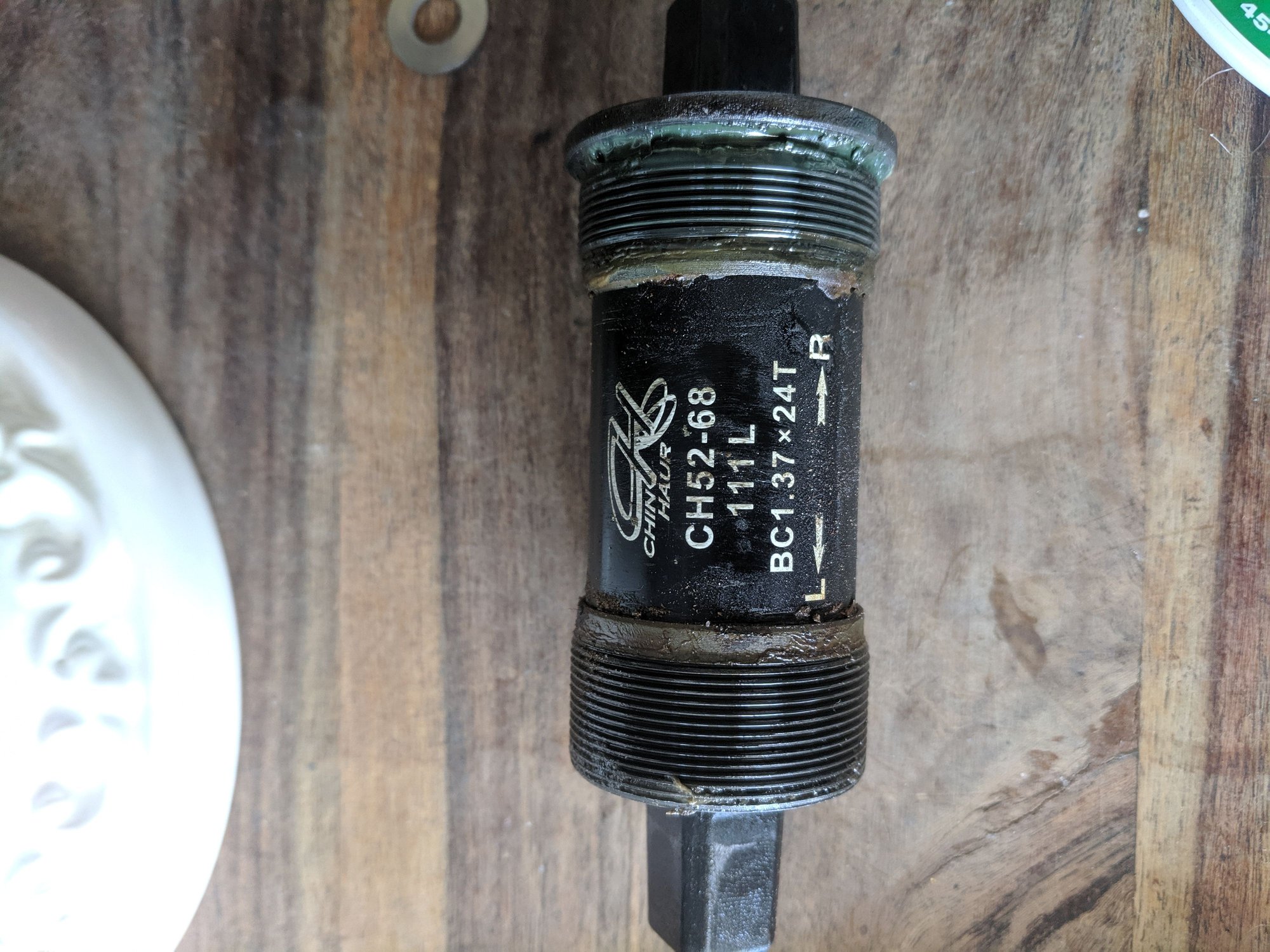

Thanks for the response! Have a question for you: My bike's bottom bracket is a CH-52 111L (I think this means 111mm spindle) BC 1.37x24T (photo attached). The specs of the bike from bikesdirect.com said the following: "CH52, Sealed Cartridge 103mm, square taper."
Could bikesdirect.com be incorrect in this case?
I measured the chainline from the teeth of the crank to the center of the seat tube and it was roughly 45MM. So in theory... if I were to purchase Sugino Messengers or Andels, how can I match up a 45mm chainline? Sugino's website shows 45mm chainline for the messenger with the 103MM spindle bottom bracket? I think that's what they mean - that you can achieve a 45mm chainline with their 103MM bottom bracket.

Looks like yours is a 111mm spindle. Definitely possible that BD listed the wrong specs, as they don't really make or assemble the bikes. Or it could be an iteration with different specs from what BD currently sells. Anyway, whichever crankset you buy should have a manufacturer's or seller's recommendation for compatible BB. I'd go with that.

If you get new cranks I would certainly upgrade that bottom bracket. Plastic cups on a bottom bracket are a complete no-go for me in any situation and you can get a UN-55 from Shimano pretty cheaply or use the Sugino CB-103 or whatever it is called or if you want to be a bit more spend SKF or IRD Defiant QB-95 are good choices. I generally haven't ever worried about chainline. Everything I have run is relatively quiet and smooth to extremely quiet and even smoother. The only time I might worry about it is on some odd conversion but I would rather just have a bike built to be a single speed or fixed gear.
