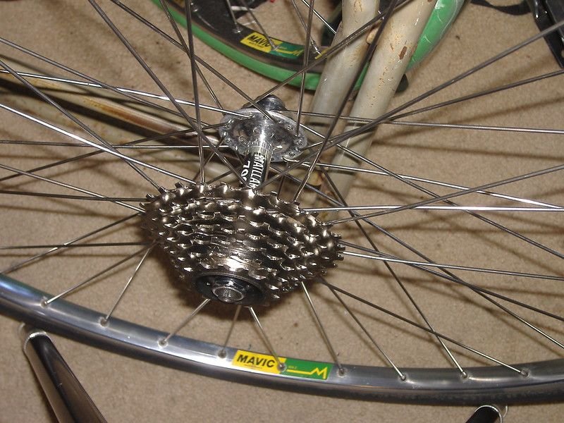

For the 121mm rear of my 1974 PX10LE, I slightly modified the axle spacing and wheel dish to allow a 7s freewheel on a 124mm spacing width, and ended up with a very strong wheel by exploiting the redundant axle overhang dimension on the (originally) 5s hub. I kept the axle overhang past the face of the smallest cog down to about 3.3mm and it adequately cleared the frame using 8s chain after I massaged the dropout's axle-position hardware with a Dremel and kept the smallest cog down to 13 teeth or so.
Note that the 7s wheel shown was for use with Campag 8s shifters and derailer, not Suntour, but the 7s GIANG freewheel worked well in this application.
Also, since you will be using only a 6s freewheel, a very strong wheel can be built to 121mm spacing width if the axle spacing keeps the locknut from protruding much past the face of the smallest cog.

For the 121mm rear of my 1974 PX10LE, I slightly modified the axle spacing and wheel dish to allow a 7s freewheel on a 124mm spacing width, and ended up with a very strong wheel by exploiting the redundant axle overhang dimension on the (originally) 5s hub. I kept the axle overhang past the face of the smallest cog down to about 3.3mm and it adequately cleared the frame using 8s chain after I massaged the axle-position hardware with a Dremel and kept the smallest cog down to 13 teeth or so.
Note that the 7s wheel shown was for use with Campag 8s shifters and derailer, not Suntour, but the 7s freewheel worked well in this application.

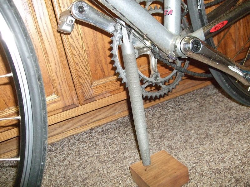

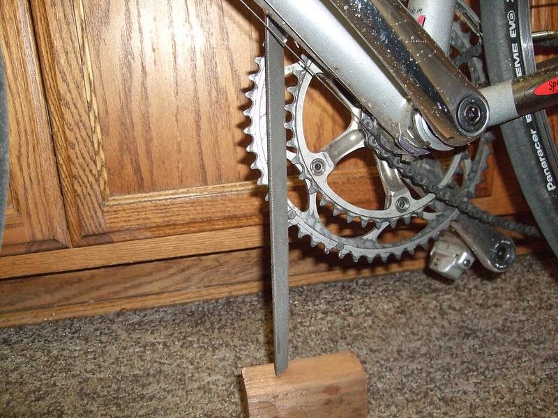

One can hold a file against the small ring while turning the cranks backward to move the tips of the teeth toward the big ring. Very little actual metal removal is needed here, just a few turns. Use a good, sharp file resting on a support block (while you angle your arm to stay clear of the rotating crankarms).
In cases where the chainrings are more similar in size, I might remove the small ring and bend each tooth about a half-millimeter using an adjustable wrench. Never broke a tooth and have modified many such rings over the years, I keep the wrench gripping toward the tip instead of the base of the tooth and it is easy to eyeball.
