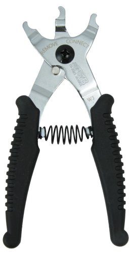

I bought one of these on eBay. They work really slick for opening or closing the KMC quick links, as well as other brands.
Yes!
I have a 2 pronged model, but it works great, $8 I think.
jackbombay is offline

Originally Posted by jackbombay View Post
Yes!
You can also cheat, & use hemostats. 😎
