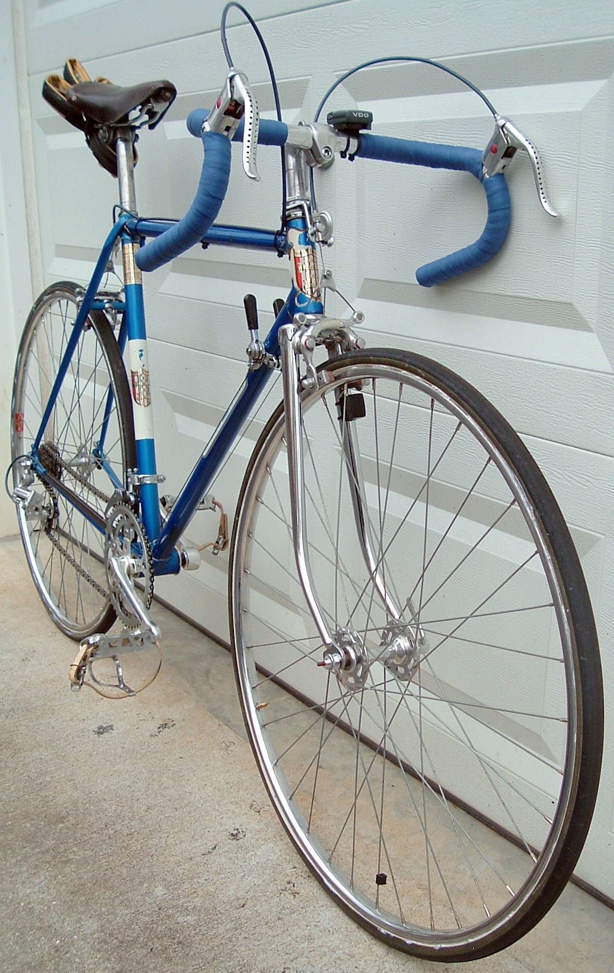

Great restorative efforts on display there!
I picked up one of the blue ones recently and am now motivated! My earlier Viscounts were Sport models and rode well.

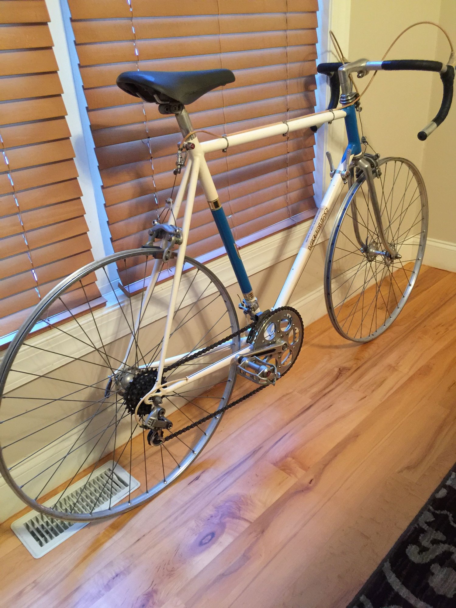

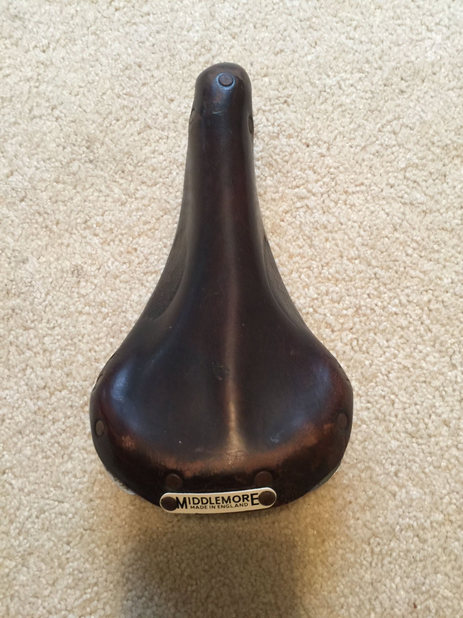

As found
Hopeing to straighten this out

If you have both pedal dust caps you'r a lucky man indeed. Looks nice and complete.

Yes top, both caps intact! Glad to have found this thread. Lots of info on the inter webs about these bikes. Around here, mostly the common makes of c&v so this viscount has been interesting to research. Looking forward to riding this! Cheers, Kevin.

I can't tell from the pictures, clincher or tubular rims?
I'm sure you've covered the trouble spots (BB spindle, fork, bearings, ect). I like mine quite a bit, rode it 180 miles in the pouring rain on a charity ride a decade ago.

Excellent find that looks complete. That is the stock Middlemore saddle and Birmalux clincher rims. I'm curious what brand seatpost - appears Campy 2 bolt style that was also copied by many others.
Also note the dropout adjuster screws. Lucky you! I've yet to see these on the Aerospace Pro. Without, the rear axle with rather lacking skewer design were prone to shifting. (I improvised for mine and made adjustable stops.)
Regardless the bad rap often thrown to this brand, I find it a fascinating slice of history for lightweight bike collectors. The company storyline has enough drama, its attempt to be both a component and frame maker, the challenge to go after the giant English maker Raleigh, etc..
The Aerospace Pro model is impressive for what they offered and LOW retail price. I had fun learning and building mine, its a blast to ride.
Only did one Sat. AM group ride with it and it was great to show up the B group carbon snobs. I had a sense that a few thought it gave off a virus -kept their distance from me. These were fellows I've usually ridden with in a tighter group. Too funny~

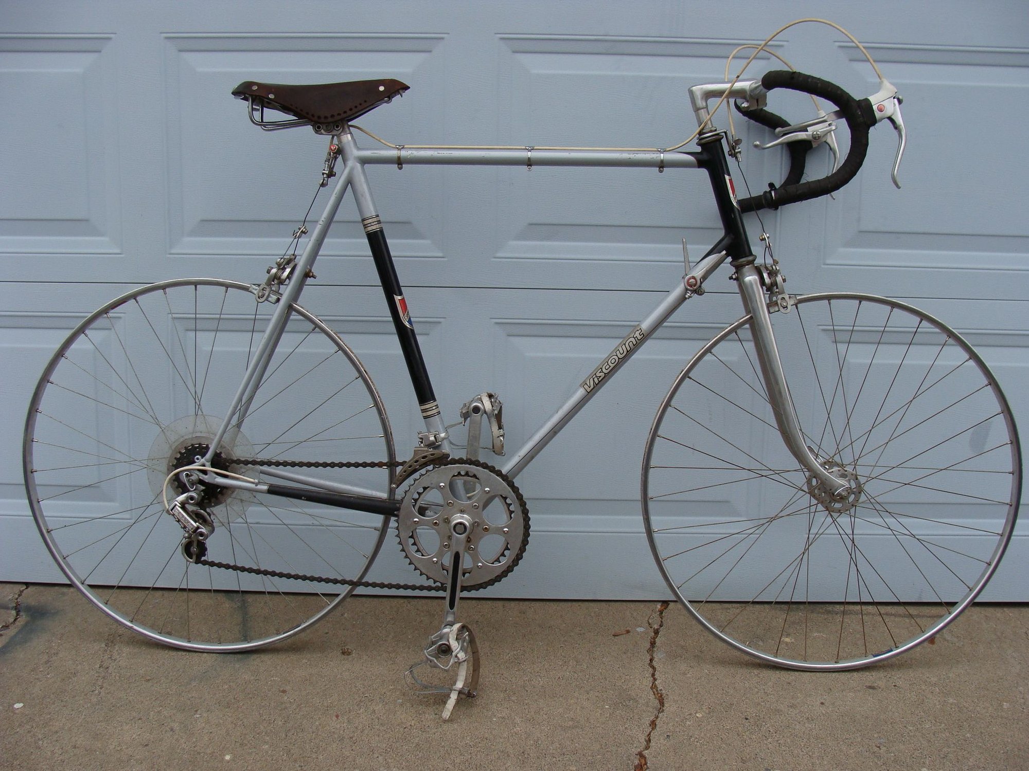

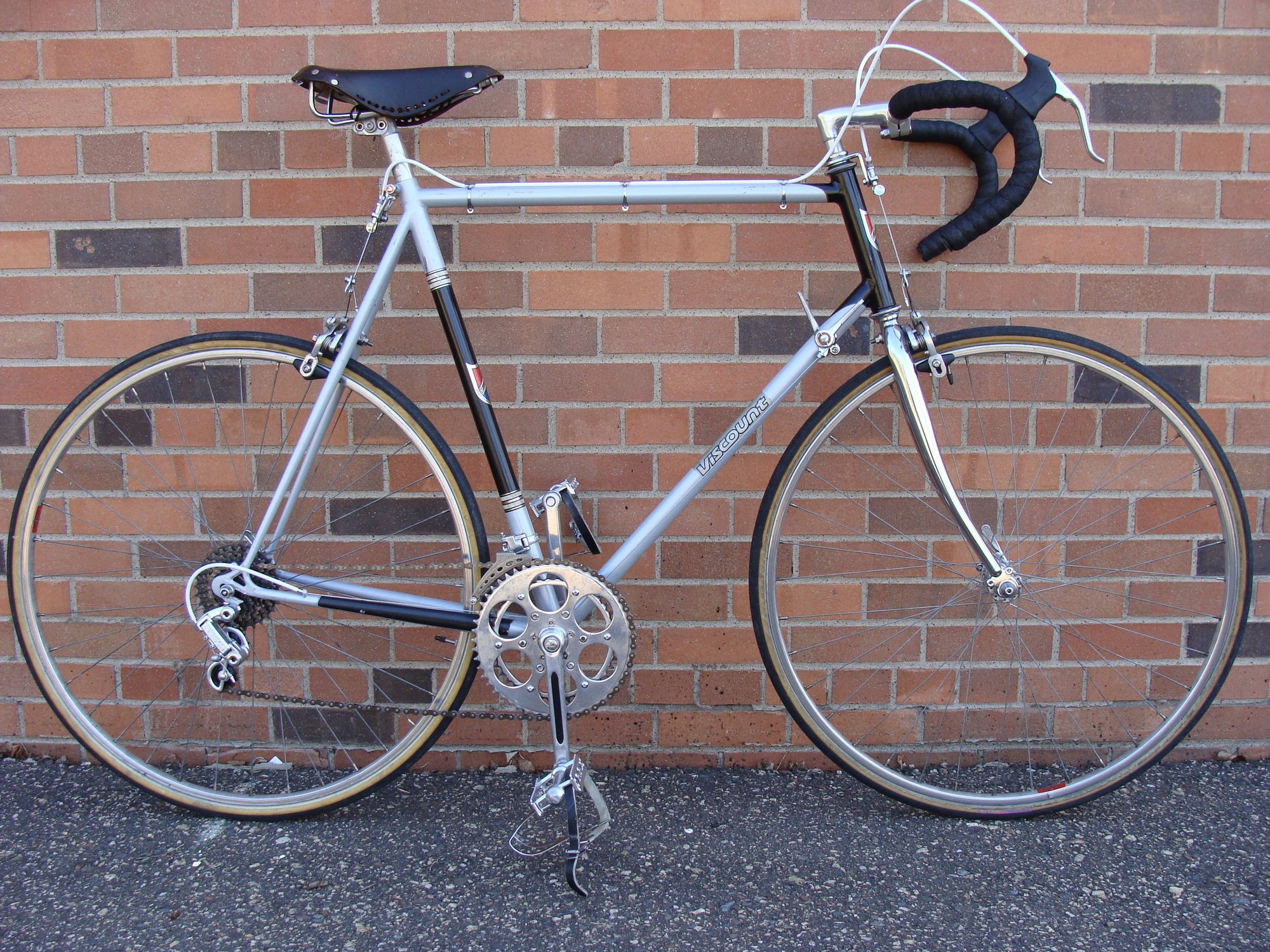

Here's the Aerospace Pro I found and built for my son. As found and finished. I also ran into problems with the bottom bracket because one bolt was gone and the last owner had tried to force a random bolt into it. Located a spindle and bolts here on the forum. Had to replace one bottom bracket bearing as well which I got through my LBS. I also got a modern cro-mo fork from them to replace the third gen death fork this bike came with. And yes the bike was complete with its Middlemore saddle, running budget sew ups from Yellow Jersey as well. I replaced the original drive sprockets with a Stronglight set shortly after taking these pics because the original was so worn it could barely be ridden.
Y

Very nice viscount, Steve. Those forks look great on that bike. My cranks spin smooth so I’m not attempting to service the bottom bracket. Not sure of the fate of my bike but it’s been interesting to read about and I like the odd bits and the looks. For now it’s on the trainer for the winter.

@SteveSGP, that's the best looking replacement fork I've ever seen, and I would consider putting one on my Viscount. What is it, and where can I get it? Thanks.

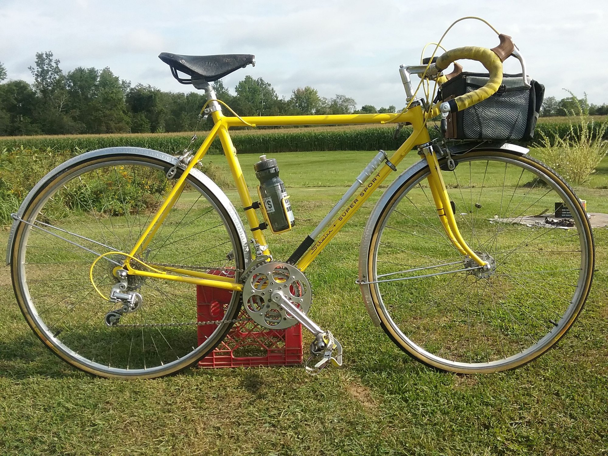

Too bad about the chain ring. I like the way they look and put one on the otherwise Nervar crankset on my hot-rodded Super Sport:
Very nicely done. Next in line after I've finished the Lambert 'upgrades' is to take my Super Sport and replace the Ashtabula crank with the Nervar I've had for years (came off a Sport Tourer, I believe), and finally get rid of that Huret Allvit with something Huret that's a bit better. Unfortunately, that Nervar comes with a 54t big ring, and I normally ride a 48-49t. Going to have to do some shopping, which is why I haven't done the conversion previously.
