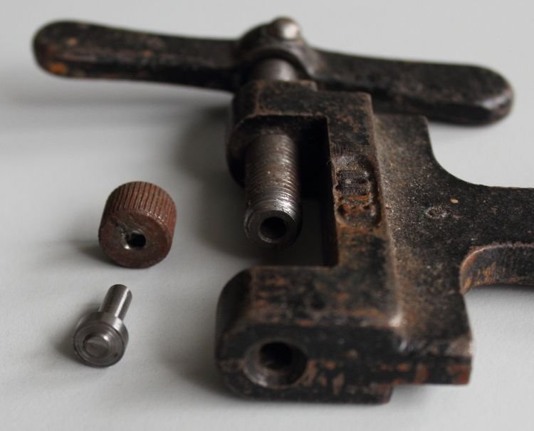

All,
I am looking for a snapshot of the pin which fits inside of an Eldi chain tool.
Anybody? I've looked all over the WWW. Plenty of photos of the tool, but none of the small pin which drives out the chain pin.
Thanks in advance,
Kurt

Here's a picture of one. The extractor pin has snapped off, but it shows you the configuration, with a central flange having a mounting pin on one end and the extractor pin on the other, which is fairly standard. The central flange measures 0.312" diameter x 0.125". Mounting pin section measures 0.164" diameter x 0.505".

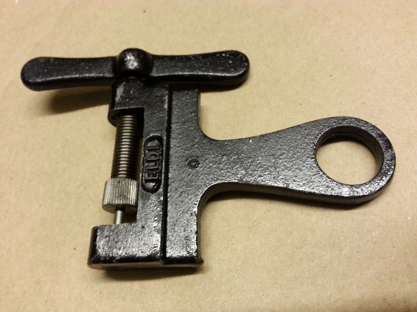

Sorry for bringing back this older thread but it is exactly my subject.
I have this exact chain breaker. I'm sure I bought it in the 1970's when I briefly raced.
I am looking for replacement pins for it and I am having trouble finding them. Is this Eldi CB too obsolete?

Eldi may be one of the venerable brands of back in the day but they are a bit crude no matter how you cut it.
Very long screw for a bicycle chain tool, any slack in it creates deflection and binding when extended.
This was probably a multi use tool for motorcycles too and everything in between, easily loosing its precision needed for small chains.
You might be able to find a grade 8 screw to use or you could have a pin made but my view would be to display it for its place in history.
