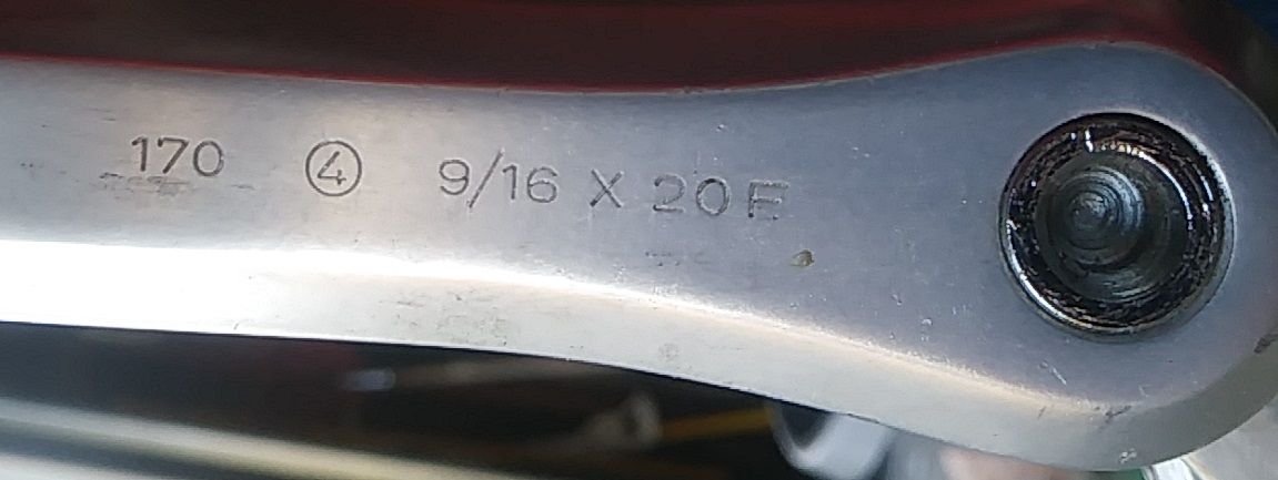

I think the circle (32) would be a 1982 crank right?

Yes I thot maybe he 32 meant '82 but then I'm certainly no Campagnologist !

2 inside circle is 82. 3 inside circle is 83. 32 inside circle is an anomaly.
Here is an 84 Triomphe crank:

Ok - good to know - thanx - just means nothing ?

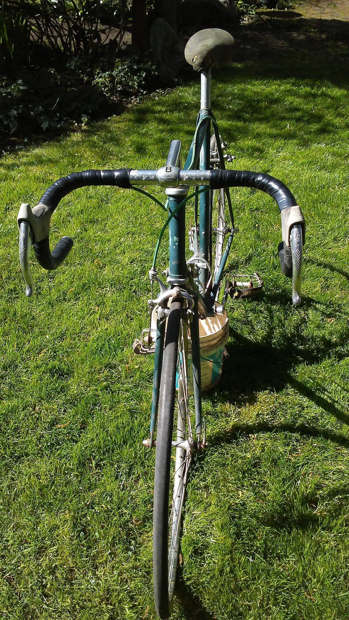

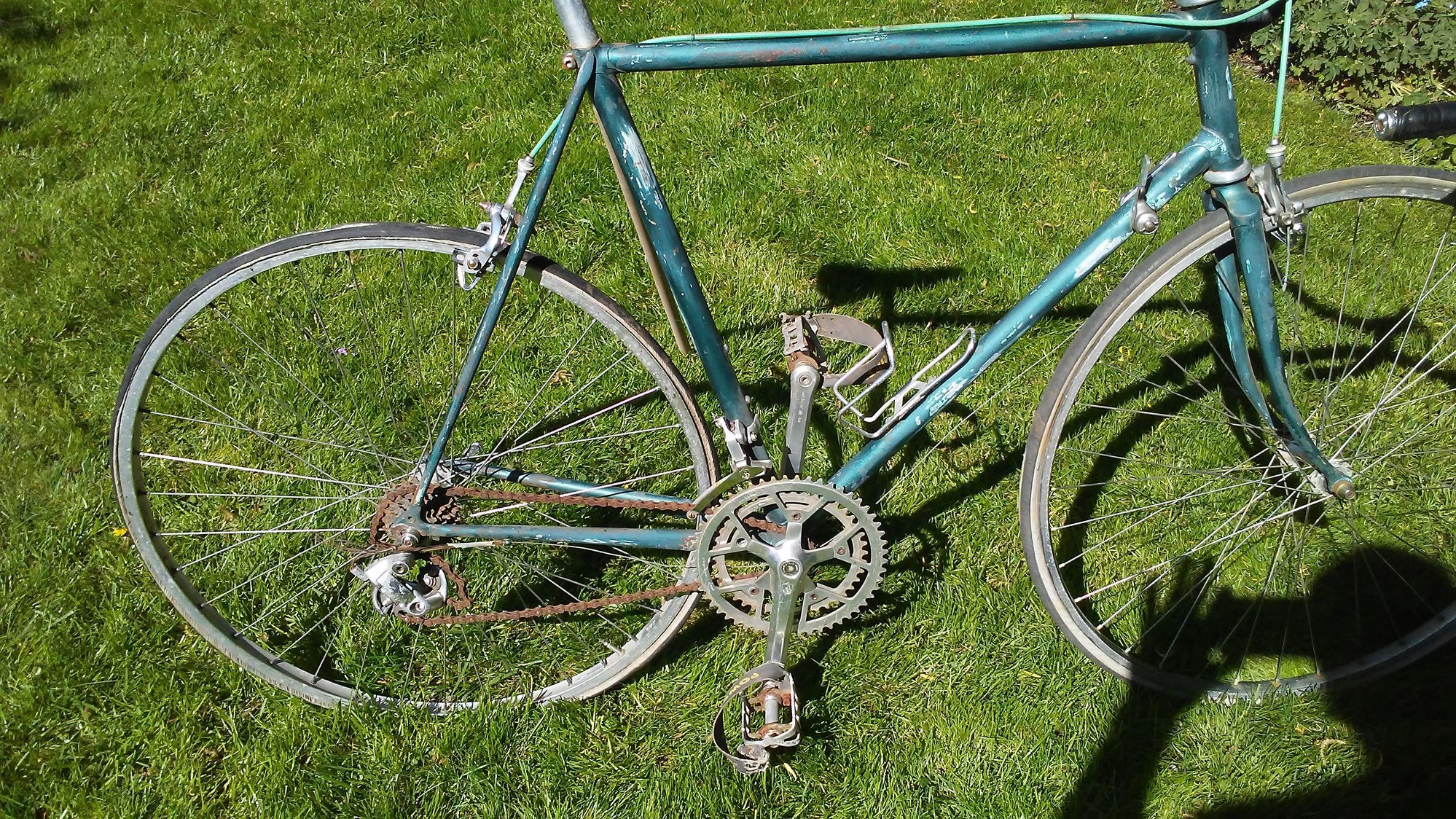

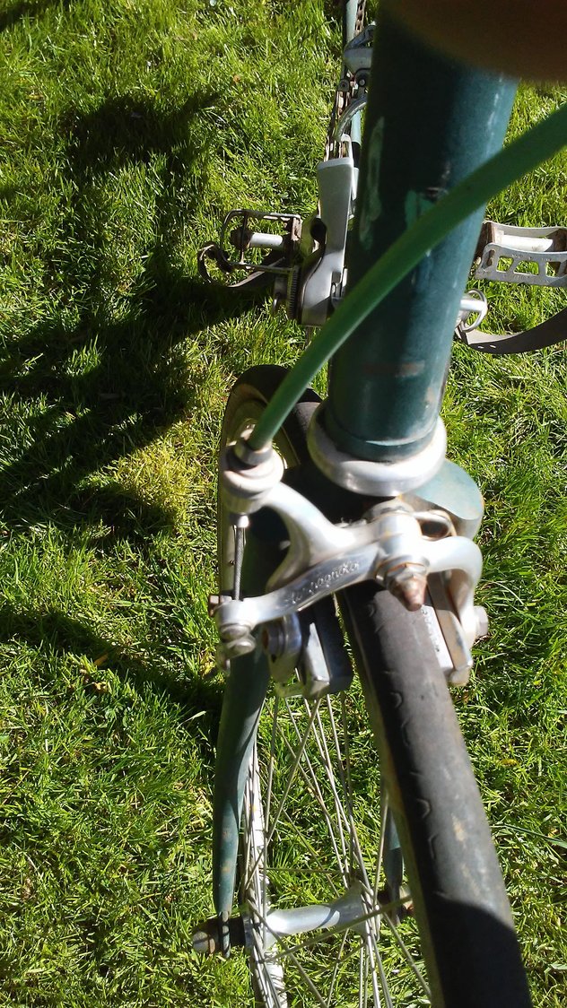

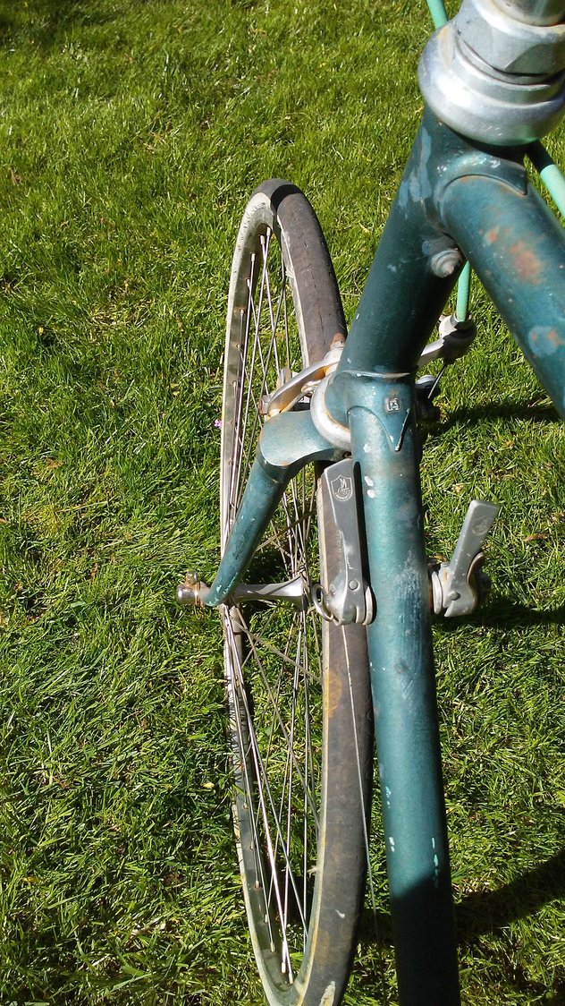

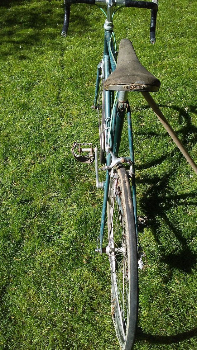

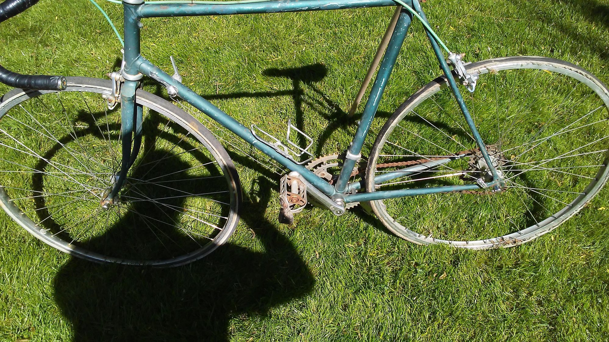

Here are some pics. It is too bad someone repainted this. I am pretty this is a '88 Giro with a Columbus/Bianchi Formula II frame and fork. I can't really see someone installing Synchro shifters on an older model that had Victory shifters. The headset could be a replacement or it may have been factory installed because they were out of Victory ones.
This looks liek it needs a ton of elbow grease along with tires, cables, chain, actual grease but it should clean up and be a great rider.

Are the bubs still Campagnolo? The rear rim is certainly a replacement but the front Ambrosio would be OEM. The only other part I see missing is the rear derailleur.
I am going to tell you what I tell everyone; clean and relube this and ride it before painting! Yes it is more work but if for some reason you don't like the ride you are not out the time effort and materials or heaven forbid the cost of a professional repaint.
Now if this was mine I'd start in with thew overhaul. I'd put the wheels in bags along with the shifters and set them aside. When reassembling it I'd of course add cables, chain, tape but also Lool Stop brake pads, I don't mess with NOS CampI pads because they are still 20+/- years old. Although they are the signature look of the Victory brake calipers I might ditch those rusty truncated cone nuts and just put some stainless acorn or cap nuts on. Most of my bikes use a 7spd shipmano HG hubset for the smoother shifting and better supported axle of the freehub design. If it functioned well I'd likely leave that Light Action RD in place, (for a bit) they are cheap but the Slant Parallelogram design shifts smoother than the 1960s old school design of the Victory. For shifters I use some retrofriction from Sachs or the new DiaCompe MicroShift ones.
The catalog shows the '88 Giro in Italian Red with yellow and white decals. I am not sure what color the line was on the Giro but these from a Super Leggera are likely pretty close although you obviouslt don't need the Campione de Italia portion. The two smaller "B"s go on the stay caps while the larger ones go on the fork crown. https://www.ebay.com/itm/Bianchi-Sup...MAAOSwGhFZfoo-

...I am pretty this is a '88 Giro with a Columbus/Bianchi Formula II frame and fork. I can't really see someone installing Synchro shifters on an older model that had Victory shifters. The headset could be a replacement or it may have been factory installed because they were out of Victory ones....
The Miche headset is OEM spec and just another sign of Bianchi's penny pinching. By this time you couldn't even get a full Formula II frameset. All the Formula II models were tretubi versions with lower grade Aelle stays. The ill performing Syncro levers are also OEM spec. The only non-OEM components that I can see are the saddle and pedals.

Yes - the pedals I hadn't mentioned but wondered about since they're Japanese (also the bars & Shimano derailleur - & the Weinnman rim ? - What would be the correct seat , pedals etc.? Thanx for your input.

OEM pedals were Look PP75 (clipless). The handlebars would be 3TTT Criterium, to match the stem. The rear derailleur was Campagnolo Victory. Rims would be Ambrosio Super Elite 19. Saddle was Selle Italia Super Mundialita.

The OEM tyres are pretty narrow, 700 x 20C. These days most riders want to fit the fattest possible tyres. I'm not sure exactly what these frame will accommodate. Anybody? I imagine current the tyres are somewhat bigger than OEM, so you can always check the size markings on them.
I also just noted that the brake levers aren't Victory, which have grip/lightening holes drilled in them. However, the catalogue picture doesn't showed drilled levers either, so it just appears to be another case of the factory downgrading so save a few lira.

Yes I thot the levers looked like Triomphe ? Aero? - I'll try the is thread -thanx again.
