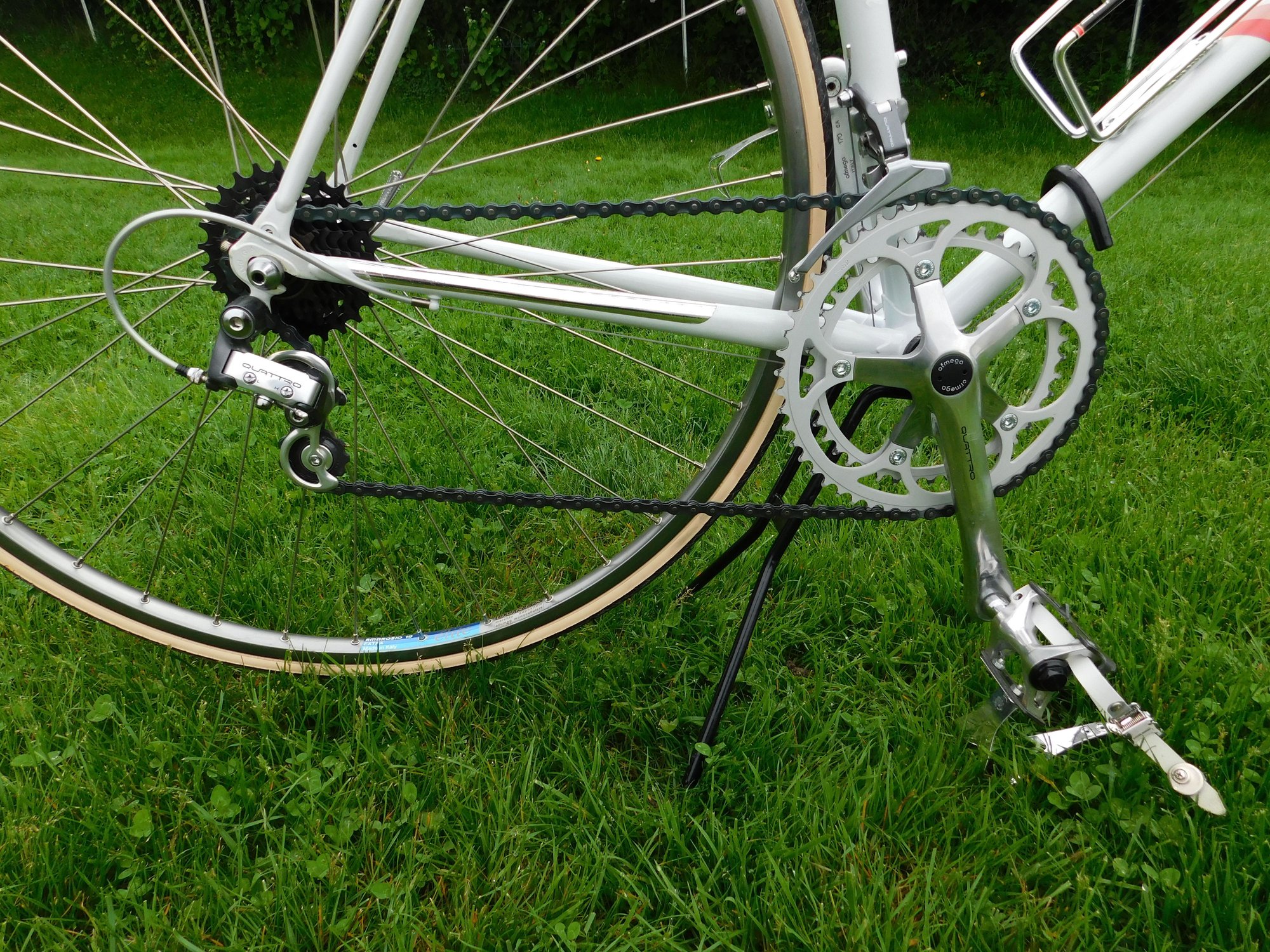

Here's my Trek 400 Elance- (I lied, it's XC Pro.)
1985 Trek 620 by Dave The Golden Boy, on Flickr

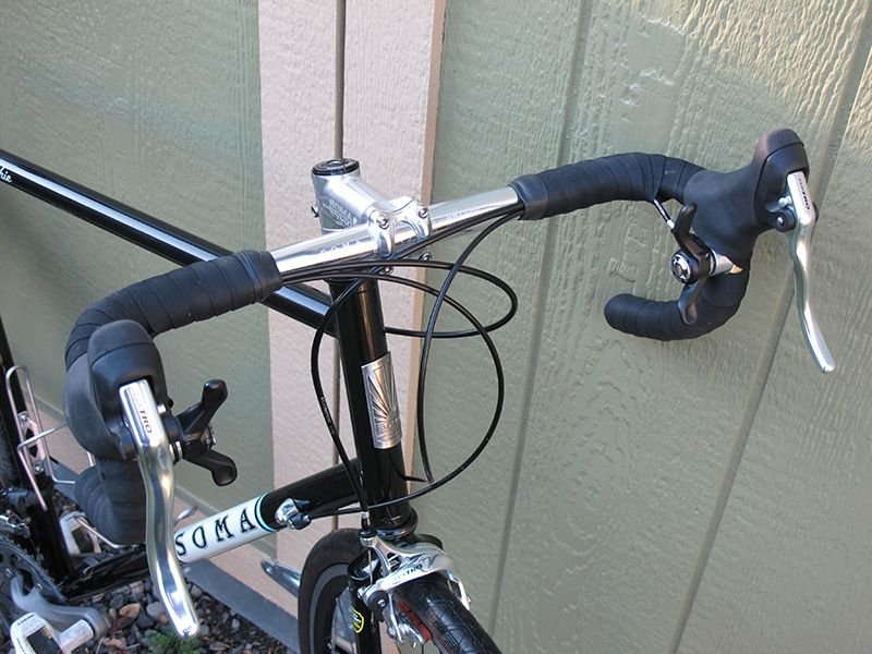

i was just wondering.....what's the swing like on those command shifters, anyway? i wear a men's M size gloves, but my fingers aren't particularly long. even shimano brifters are a little awkward for me. doable, but it is a bit of stretch
i'm going to try and avoid as much complication as possible stick with parts that are "meant" to work together on this. keep my tinker time to a necessary minimum (famous last words) <<<fingers crossed>>>

gorgeous treks you have, dave! love treks
Within the middle region of the cassette, the shifting is relatively effortless and ergonomic, but stabbing for low gear gets your thumb up there (not bad) while shifting to easier rear gears from the drops is yet more awkward. Outside of these two extremes, they work pleasantly.

I've always loved this pic of a Superbe Pro RD on my almost entry level Trek 400 Elance- with a dork disk.
SuperbePro400 by Dave The Golden Boy, on Flickr

golden boy....indeed, suntour made some of the nicest bike bits to my eyes. and, that is a lovely shot of the drivetrain! so, what might be the "equivalent" to the superb in the mtb/long cage line up for 7spd AP? i can't get anything right now, but eventually i think i'd like to. (my x-1 could use some serious touch up paint). and, i'd like it to resemble the superb or even cyclone mkII as much as possible. you know, that way it'll match up nicely with the mkII FD and the sugino AT triple i'll be installing. right now my univega (gran turismo) has suntour BL derailleurs and SR custom triple, but the spider is 118bcd (harder to find rings for) and min granny ring is 36t. the sugino will allow me to go down to 24t and i'd still be within the era of the bike. i can do it, so why not, eh? anyhow, built like i imagine it, it'll resemble the specialisma build specs.....an upgrade as it were
i can see why it would go "ker-chunk" when shifted vs shimano....hence "hyper glide". all the ramping and synchronizing shimao does.

I'm joining this thread late and not replying to any post in particular... mostly just to say I really love my Command shifters. (I like bar-ends on my commuter bike, but not as much. I've got no use for downtube shifters at all.)
You should note that Suntour made multiple variations of Command shifters. I prefer the versions where each shifter is spaced off the handlebar by a round aluminum bushing rather than a formed steel part. I think the length and shape of the levers varied too.
Ergonomically, I believe Command shifters probably work better today, with more modern brake levers and bar shapes, than they did back in the day. (I'm using Tektro RL-340 levers on a Soma Hwy One bar.) I like having shifting entirely separate from braking: the simplicity of it and that it results in better feel upon brake lever actuation. Shifts are convenient for me to reach without removing my hands from the tops, or the hoods, or the drops - right through the whole range. I wear XL gloves, so I'll concede that people with shorter fingers might not love these shifters as much.
My RB-1 came to me with complete Accushift system, but I already had a spare wheel with Hyperglide freewheel, so I tried an almost blind back-to-back test... and I never went back to the Suntour freewheel. On the one hand Ultraglide shifts MUCH smoother and more quietly than Accushift, and on the other hand the Shimano freehub is MUCH quieter than the Suntour freewheel. Plus, you can have an extra cog or two if you want. On the RB-1 I used 8 cogs of a 12-27 9-speed cassette on a 7/8 speed freehub body, in combination with a SRAM 9-speed chain. Worked great!
I set the Command shifters to the friction mode... now, I know there are detents and maybe the detent spacing is slightly off, but I've found the detents aren't deep enough to matter at all. They function as friction shifters! Ride the bike before deciding for yourself, and I think you'll probably agree. (The detents feel more significant until you're actually riding. The amount of friction in your cables and spring in your derailleurs will affect perception.)
I got hit by a car, and my RB-1's frame got bent... so last winter I transferred over my Command shifters to a Soma Smoothie build. Now I'm running the Command shifters with Shimano 105 derailleurs (RD-5701/FD-5700), compact crankset (FC-5750), CS-M750 11-32T 9-speed cassette., and Sram 971 chain. The shifters are excellent! It's just a pity Suntour didn't get them to market a couple years earlier - maybe brifters would never have caught on.
I hope something here helps someone.
