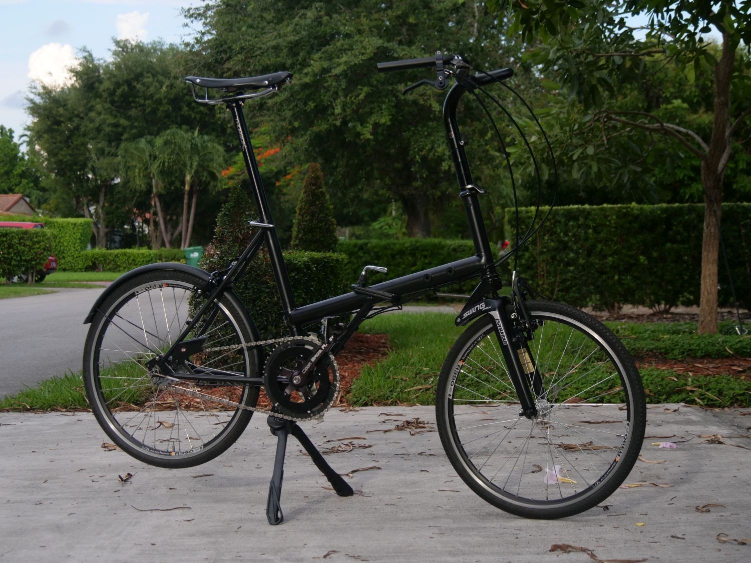

I found a workable bottom bracket and soldered up the brushless motor leads today - and the PAS sensor arrived too. Figured I'd hang everything with rubber bands and bags to test the electric assist system a test between rain showers.
Worked well too. Topped out at 18mph, though the assist seems to come in a bit slow. I couldn't really hear over the rainwater being lapped up by the tires. May have to try an eight magnet sensor wheel instead of five.
Despite the mess upstairs (temporary - battery will be fitted between the seatpost and the rear fender), the motor wires aren't that obtrusive. I might replace the yellow MT60 connectors (the visible ones, anyway) with black ones later on.
It's also wearing MKS FD-7 folding pedals now, thanks to AeroGut .
Now that's a proper (and attractive) fenderline. Still hemming and hawing over bending a spare set of stays to bolt up to the brake booster.
Also, the wheel has been re-spoked with all the spokes on the inside, crossing, per the lacing of the 350W motors on the JUMP 5.5's.

Originally Posted by Roll-Monroe-Co View Post
I was just sure that the unconventional thing was going to be the installation of a two-tooth, eccentric chainring.
Wouldn't you know, it was murder on a smooth cadence. Who would have thought?

Insane!
A motor even, I missed that, or didn't see it coming!
Its gonna be a tank!

Where did you get that thing? It looks wild and I'd honestly love to give it a try haha
The hub or the Twenty?
-Kurt
