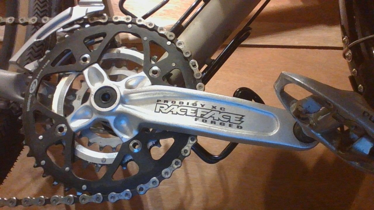

What triple did you use? Chainrings? Maybe I missed it, but I looked through your posts and didn't spot it if you did. I have been interested in a 920 for a good long while now, but when I contacted Trek, they wouldn't give me any info on triples that would fit; only doubles and singles. I passed because I couldn't take the chance a triple wouldn't fit. It would be the only crankset I would want for this bike.
I originally use a Deore triple but I didn't like the look so I found a Raceface Prodigy that was in great condition cosmeticly. the rings were not great but only the big needed replaced for now. The rings are 44, 32 and 22. I am sure there are better ones but I really like the look and it should be more than strong enough for my needs. I think any MTB spec would work but from my experiments I found a road double will NOT work, a road triple WILL work but the BB needs to be used with a MTB BB (cups on a road BB are wider) and both MTB triple cranks from different bands I tried worked fine. Keep in mind this is all using external bearing threaded BBs
I am mostly pleased with it. I found it hard to be comfortable for long rides until I put a leather saddle on it, I was not happy with the 160 rotors in the rain so I switched to 180 front and back with TRP levers and ordered TRP Spyre calipers (still awaiting those in the mail), the front and rear derailleurs are Deore as is the 36x11 cassette, I am using the Shimano10 speed bar cons from my TT bike. I found I didn't like the looks with racks on this style of frame so I switched to bags and the racks went back on another bike, and for now I am using a Salsa Bell Lap bar but I do not like it and am leaning toward the Ritchie Ergomax bar (has some rise built in) to get me a little more upright. I have done a few 100km rides and some longer 6-8 hour road/off road rides and find it suits me well and more forgiving off road than my crosscheck ever was but I still like a horizontal top tube more aesthetic for some reason. Thanks again all for steering me in this adventure I think it turned out wll.

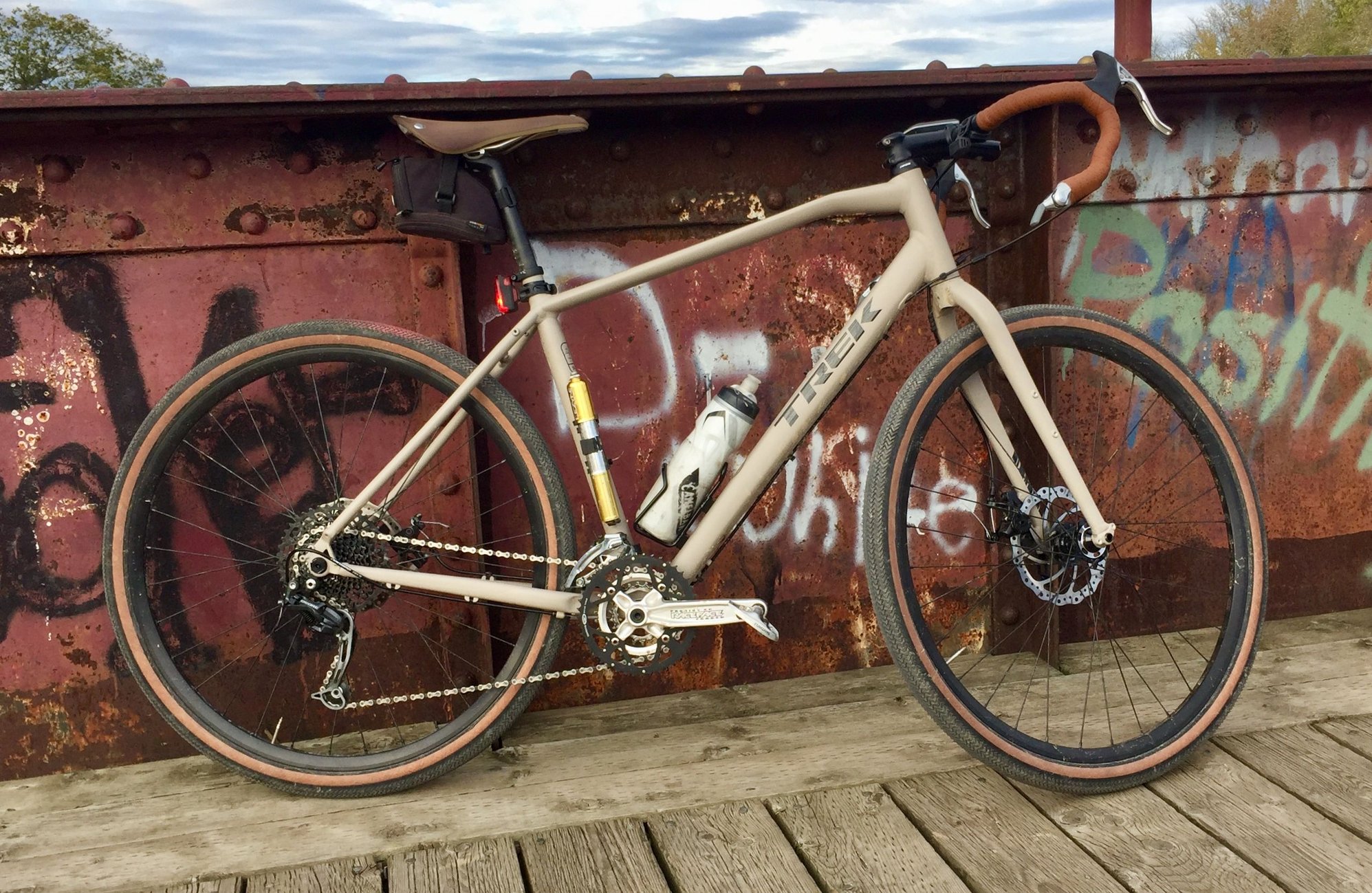

Gorgeous bike and build. Absolutely love the color (and the RaceFace crankset), and kudos to Trek for going with an aluminum frame for their top touring model.
One caveat: please consider using a smaller bottle in place of the big one placed under the down tube. Hit one pothole at speed with a full bottle in that cage, and there's a very good chance that that bottle and cage will flex downward, turning into an emergency brake and immobilizing the front wheel and launching you over the handlebars. I can picture it all too vividly.
If you're sure you'll need more fluid, pack another bottle in a bag.
LOL It is there because it does not fit in the seat stay cage. These are near 10 years old now so I am due for new ones and I will probably mount hese to the fork. I have a aluminum bottle for white gas with a strap that will be there when I tour.
Thanks for the info. That 44 chainring looks like it might not much room. Do you have any way of knowing if a 48 would fit in place of the 44 without hitting the chainstay?
I don't know the answer but I doubt it. There is 3/4 of an inch between the tip of the tooth and the chainstay and according to a chart from Wolf Tooth components a 48t chainring is ~16mm larger in diameter than a 44t. I like my setup with the 44t ring as it gives me plenty of speed with the 36x11 cassette. Only downhill do I spin out.
