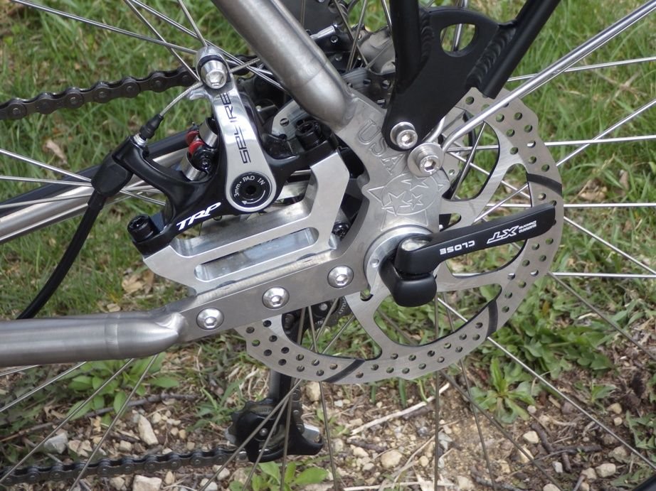

Originally Posted by Nyah View Post
My recommendations stopped when I realized that there is a scam going with manufacturers enticing people with inexpensive bicycles. They put disc brakes on a bicycle that cheaply still uses QR-skewers. All the problems you read and hear about disc brakes are rooted in their use with the skewers. Thru-axle is the only way to get the care-free use out of disc brakes that newbies are expecting from them. I have one bicycle with disc brakes and feel lucky that it's also got thru-axles.
Disc brakes without thru-axles are disappointment that lasts for the life of the bicycle.
Haha, my goodness.
You have 1 bike with disc brakes, its TA, yet you are sure all disc brake problems are rooted in the QR design? Wow.
My gravel bike has TA. It works fine and there is no rub.
2 mountain bikes we own, one for my wife and one for one of my kids, are QR disc. They both work fine and there is no rub. Both are seriously basic aluminum frames from Marin.
The wheels are rarely pulled because there is no need to pull em, but they reattach just fine and without issue each time for years now. No rub.
Shimano QRs are used that are internal cam, so maybe the higher clamping force helps?...or maybe QR disc isnt the end of the world like you seem to claim.
I do like that you claim Fuji and other brands are scamming buyers because QR is used. It isnt a scam when its clearly listed and/or shown. Its a budget focused decision for sure, just like the tires will generally be lower quality too. Everything is dont to meet a price point. It isnt a scam when its known though.

There certainly nothing wrong with recommending an improved design such as thru-axles. It eliminates a common source of alignment problems when using disc brakes. Thru-axles combined with advanced hydraulic calipers makes disc brakes the optimum choice. There are plenty of poorly executed disc brake bikes with quick release axles. Not all, but many. New bikes that feature thru-axles are clearly a step forward from older designs that use quick release axles.
Of course there is nothing wrong with recommending thru axles. I wouldnt think twice is someone said- 'I find thru axles to be a better design because it helps ensure rotor alignment'.
What I was responding to were over the top claims that brands are scamming consumers, all disc brake problems are due to QR, TA is the only way to get care free use with disc, and that QR disc will be a continued disappointment for the life of the bike.
You do see the difference between recommending an improved design and what I responded to, right? I mean, its glaringly obvious.

I and others rightfully observed the user issues relating to quick release axles when combined with disc brakes as a reasonable selection criteria.

Originally Posted by Moisture View Post
So what's wrong with QR? Is TA or regular axles with bolts on each end better or more rigid? With or without disc brakes?
Quick release axles are more difficult to manufacture and install with sufficient precision. Not impossible, just more difficult. Thru-axles provide much more precise installation, and manufacturing variants are not an issue. Also, the 142mm dropout dimension provides a wider rear installation, this also improves the strength and precision of the assembly.
After reading this thread, why are you asking me what is wrong with QR?
- QR is fine for the vast majority of quality bikes, as far as Ive seen/experienced. There has long been internet chatter about QR not allowing the axle to be seated in the same place each time a wheel is attached to the frame or fork, and therefore rotor rub is created. In those instances, yeah it must be frustrating- for sure. A quality skewer that is internal cam has a higher clamping force and may help keep the wheel in the same place thru use(its debated whether a wheel moves at all thru use).
- TA helps reduce the chance that a rotor doesnt line up within the brake caliper. It reduces the chances for error and misalignment, basically.
- Bolt on hubs are not applicable to this discussion.
- A TA system is more rigid than a QR axle setup. 15mm for MTB vs12mm for road and gravel exists for multiple reasons, one being rigidity. Its more difficult to break a 15mm TA. And there is bigger than 15mm for MTB too.
To answer your last question, I dont know why anyone would use TA with rim brakes.
.... Also, the 142mm dropout dimension provides a wider rear installation, this also improves the strength and precision of the assembly.
My Lynskey has replaceable dropouts, it takes two M4 screws on each side to remove and replace dropouts. By swapping dropouts, my frame is either 135mm conventional quick release or 142mm through axle.
So, frame is not wider with a 142mm through axle, it is the same frame as a 135mm rear hub.
And when each dropout is attached with two M4 screws, I fail to see how through axle makes things that much stronger.
The frame I am talking about is this one:
https://lynskeyperformance.com/backroad-touring-frame/
Photo below from manufacturer website with through axle. And the frame in the photo has the flat mount for disc.
My Backroad has quick release and post mount for disc brake. The brake mount is attached with the three M6 screws in the chainstay.
I am not saying all frames use a few M4 screws to hold things together, but it does make the point that the through axle is only as strong as the rest of that part of the frame.
I have found that the rear part of the frame on all my quick release bikes is adequately strong for the purpose the bike was built for. My expedition bike has much stronger stays and dropouts than my rim brake road bike that was built to be light weight and only strong enough for the purpose.
I am not saying that there is any inherent problem with through axles, but I see them as a solution in search for a problem.
Only once did I work on a bike with a through axle, and that was on a trike that a friend owns. And I found it to be quite frustrating to get the wheel in the right place and installed. Some of that bad experience was because it was a trike I am sure, but so far I am not convinced.
