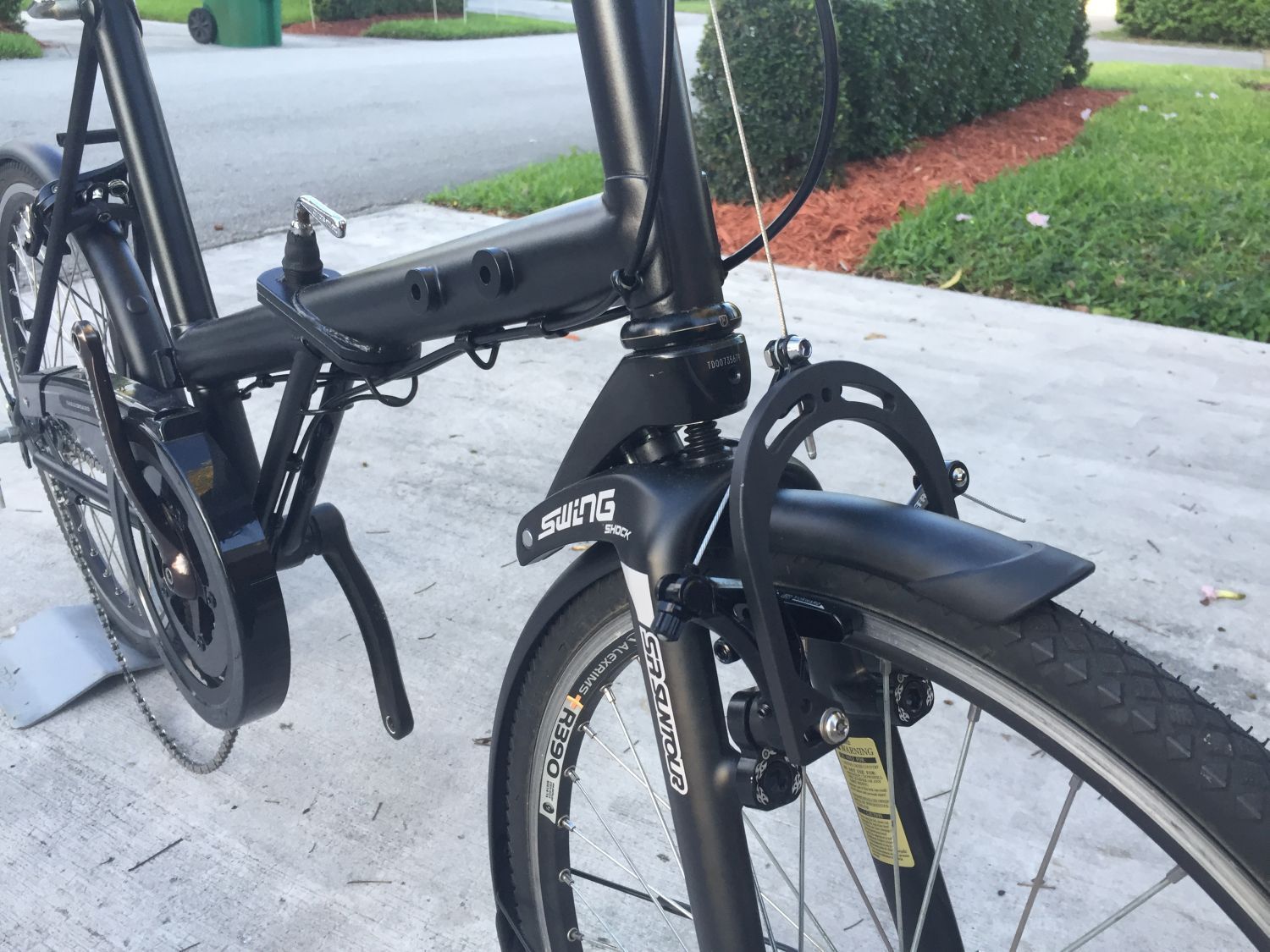

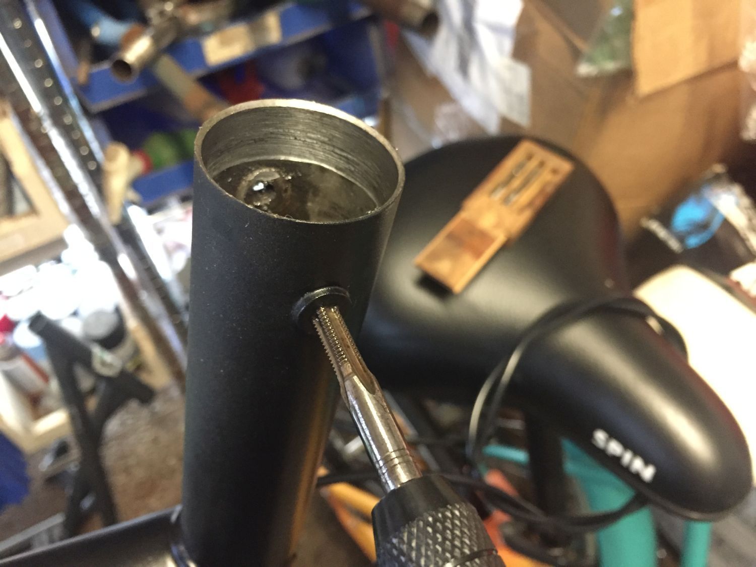

Taking a quick break from work-from-home to bring you this update: The fork is on. This is the part where I start laughing with the same stately demeanor as Professor Fate (for those of you who've seen The Great Race (1965), you'll get this joke).
Headtube angle is at 71 degrees. We'll see how it handles like this - I can still shave off 5mm or so off the bottom of the headtube if I wish to bring it up to 72 degrees. Suspension fork may settle it down to 72 just from rider weight - not sure.
I bought an IceToolz cutter to get the headtube reaming done. The inner bore of the IceToolz cutter is 18mm and the VAR shaft is 12mm, so I cobbled a temporary sleeve out of an intake manifold coolant return connector. It worked perfectly, but I've ordered some Oillite bushings just to have a better fit in future.
I also tapped out the headtube eyelets while the opportunity still presented itself.

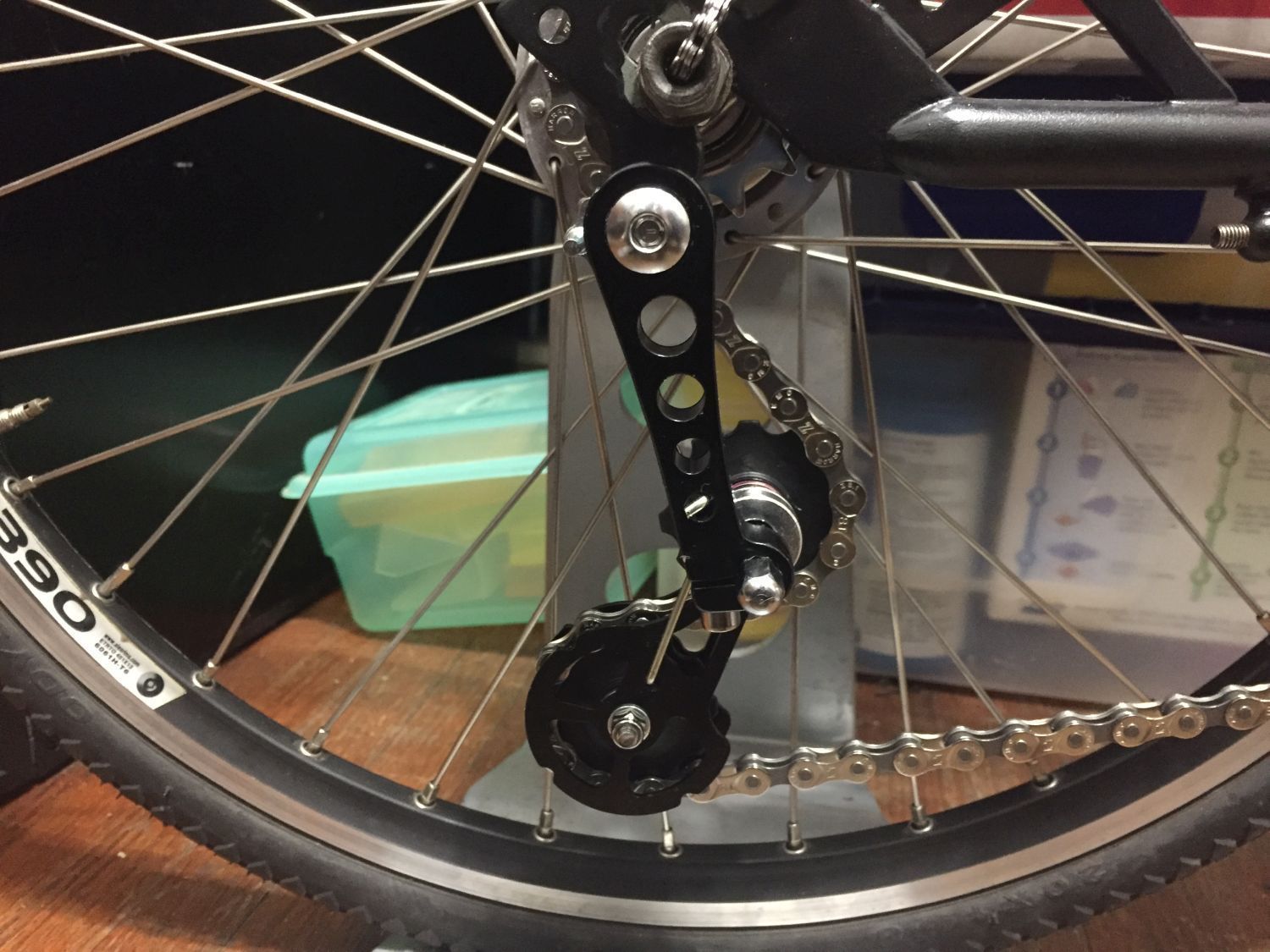

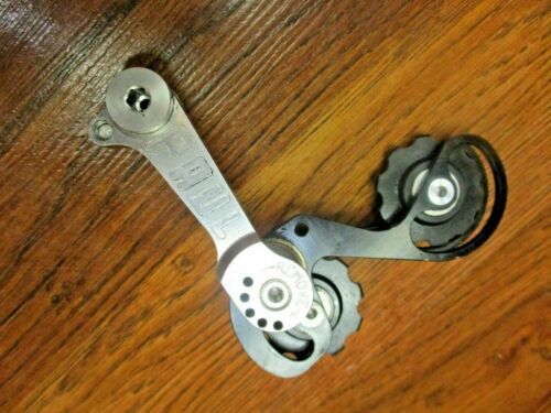

Mild update and some frustrations. Wound up buying a modern Sturmey chain tensioner, which turned out to have the same issue as the Shimano Alfines. I wrote about it here: https://www.bikeforums.net/classic-v...l#post21431537
But at least I've got another tensioner on order, and the headset spacers arrived. I also forgot that the Velo-Orange Cigne is made for 31.8 bars, so I ordered some spacers for it too.

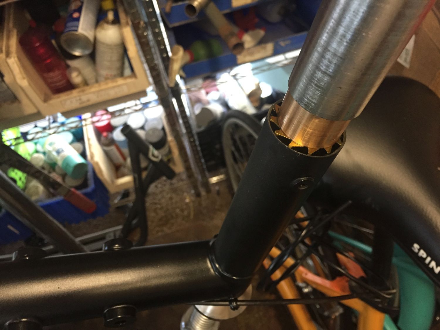

Thompson 410mm post arrived today.

The Thompson post puts double-rail saddles out of the question (I really don't want to fool with the adapter), but I was thinking along the same lines - a black Flyer or a B.67.
Funny thing, I have what is either a 1950's or 1960's sprung B.17 sitting around here - a predecessor to the current Flyer, I assume - but that monster has dual rails.
I'd rather pick one up that's been broken in just a bit - my preferred approach to a Brooks - but when I cruised eBay last night, I couldn't find any that were broken in properly. Most were either abused or barely broken in, though a number of the used women's B.17S saddles for sale were properly broken in. Quite a few sellers are asking 90% the price of a new one too, so it doesn't even make any sense to go this route.

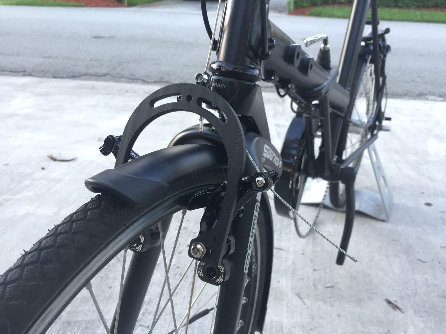

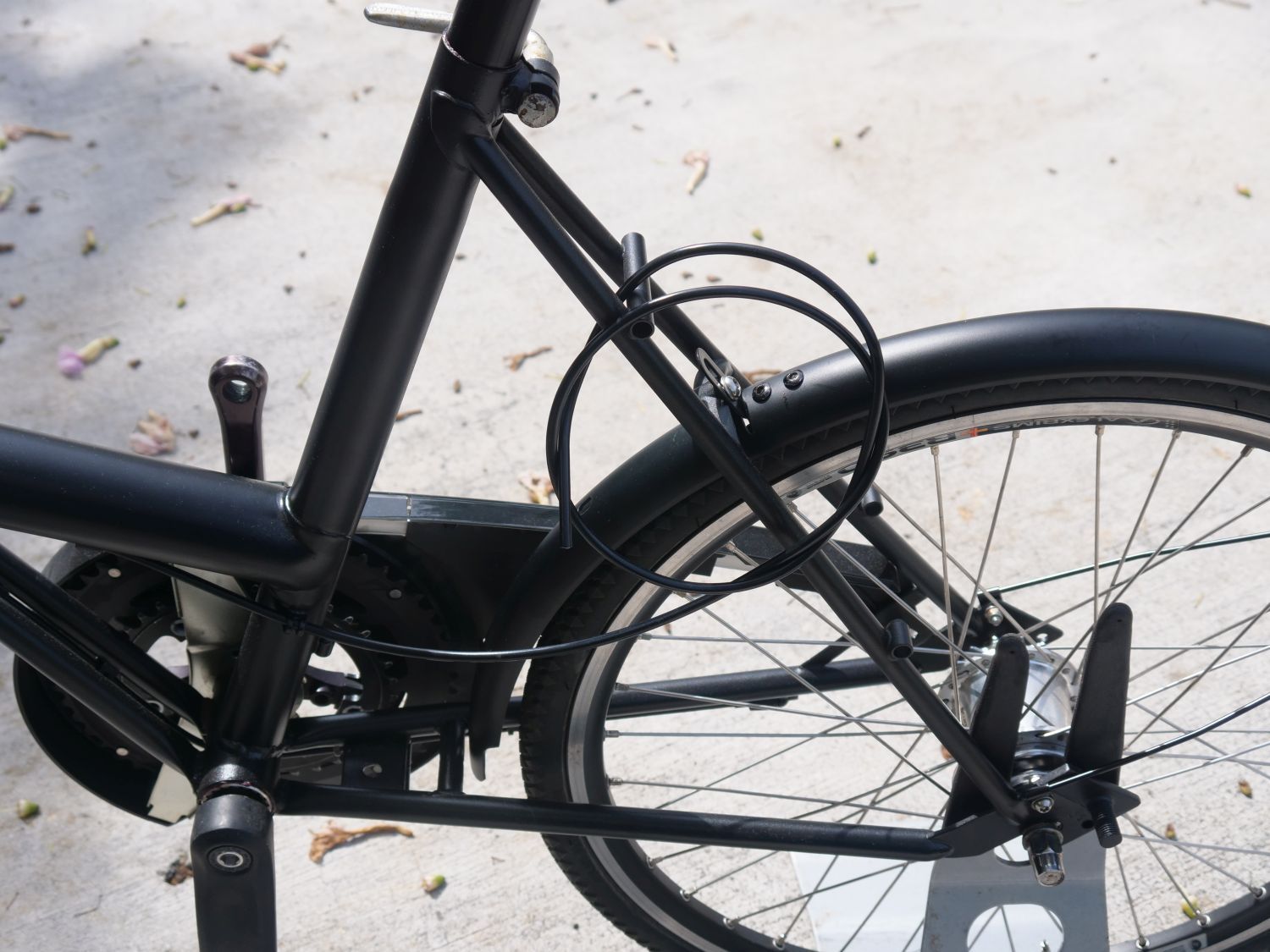

Fenders and handlebars have arrived. The handlebar shims haven't, but I couldn't resist mocking it up.
It takes a North Road to look right. I'm hoping the shorter 3-speed lever still works well with my penchant for index-finger shifting. If it doesn't, I'll replace it with an early 1950's Sturmey shifter - the kind with the longer trigger arm.
Rear fender is roughed in - I don't have the bolt or spring necessary for the chainstay bridge yet. Also considering using a Velo-Orange external-wrap rear fender stay in the back, as the stays and fixing nut fit extremely close to the tire.
The rear fender was modified to use the now-defunct front fender bracket. The rivets don't look that great, but the brake should hide them fairly well.
They're not set up yet, but the Tektro centerpulls look pretty sharp. I realized that the cable stop on the headset stack won't work with the suspension fork, but the mount on the upper half of the fork has the same problem.
Given that the adapters aren't 100% immune from shifting a few MM's, the only doable solution looks to be a V-brake or cantilever stiffener/booster with a center bolt to mount a raised cable stop.
-Kurt

FYI - the alternate tensioner arrived after an excessively long delay. It is ridiculous. The parallelogram (well, not really, since it doesn't pivot) sits far too vertical, which limits chainwrap. Equally of concern is that the B-tension spring (which appears to be a leftover from the single-pulley version of this thing) does nothing other than to cause the chain to slack up when freewheeling.
This one goes back too.
I rather like this Paul tensioner that's on eBay right now, but the seller is away with no return date set. Plus, I'm not sure if the Paul tensioners have enough L/R adjustment - and I don't even know what model this one is. It's certainly not the current Melvin.
-Kurt
