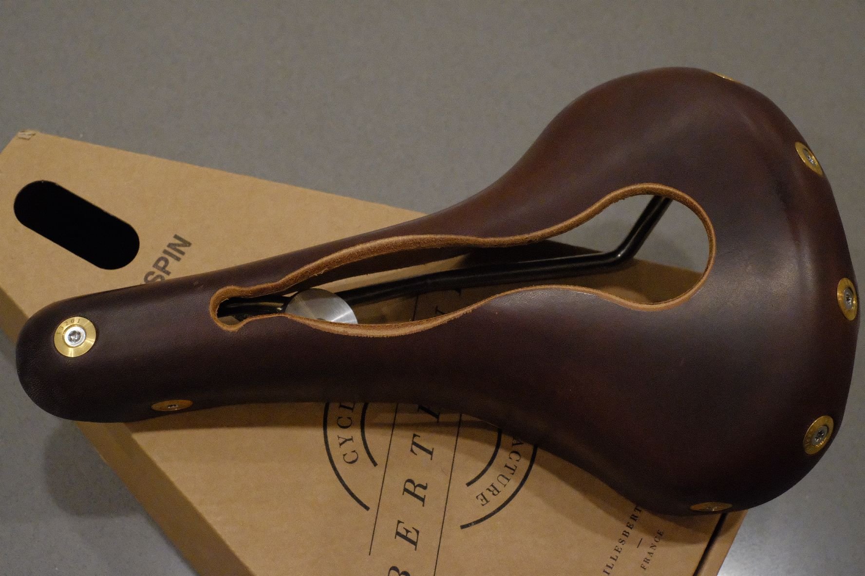

Just got home from work, so no progress on the build, but thats what the mailman dropped off:
