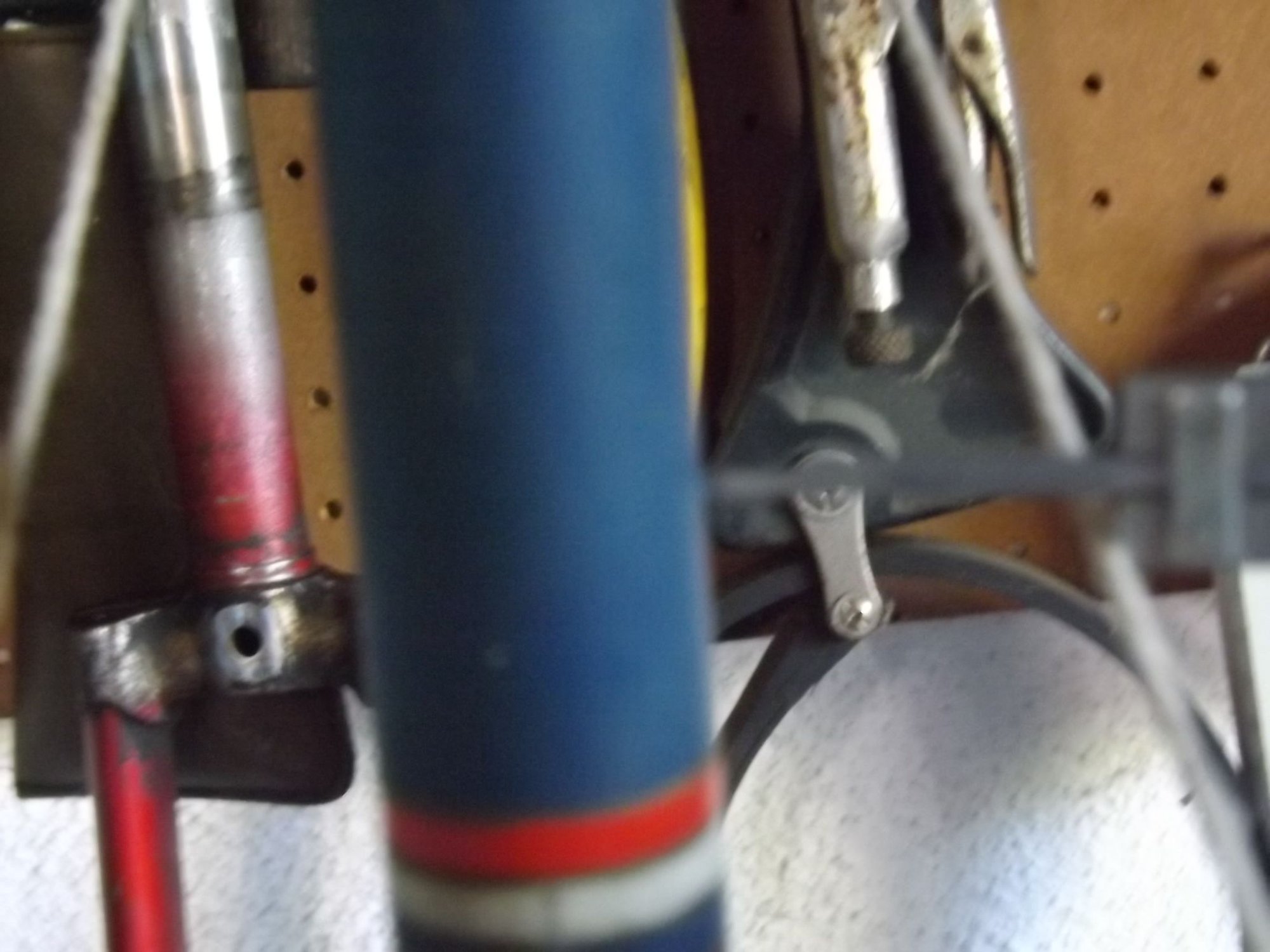

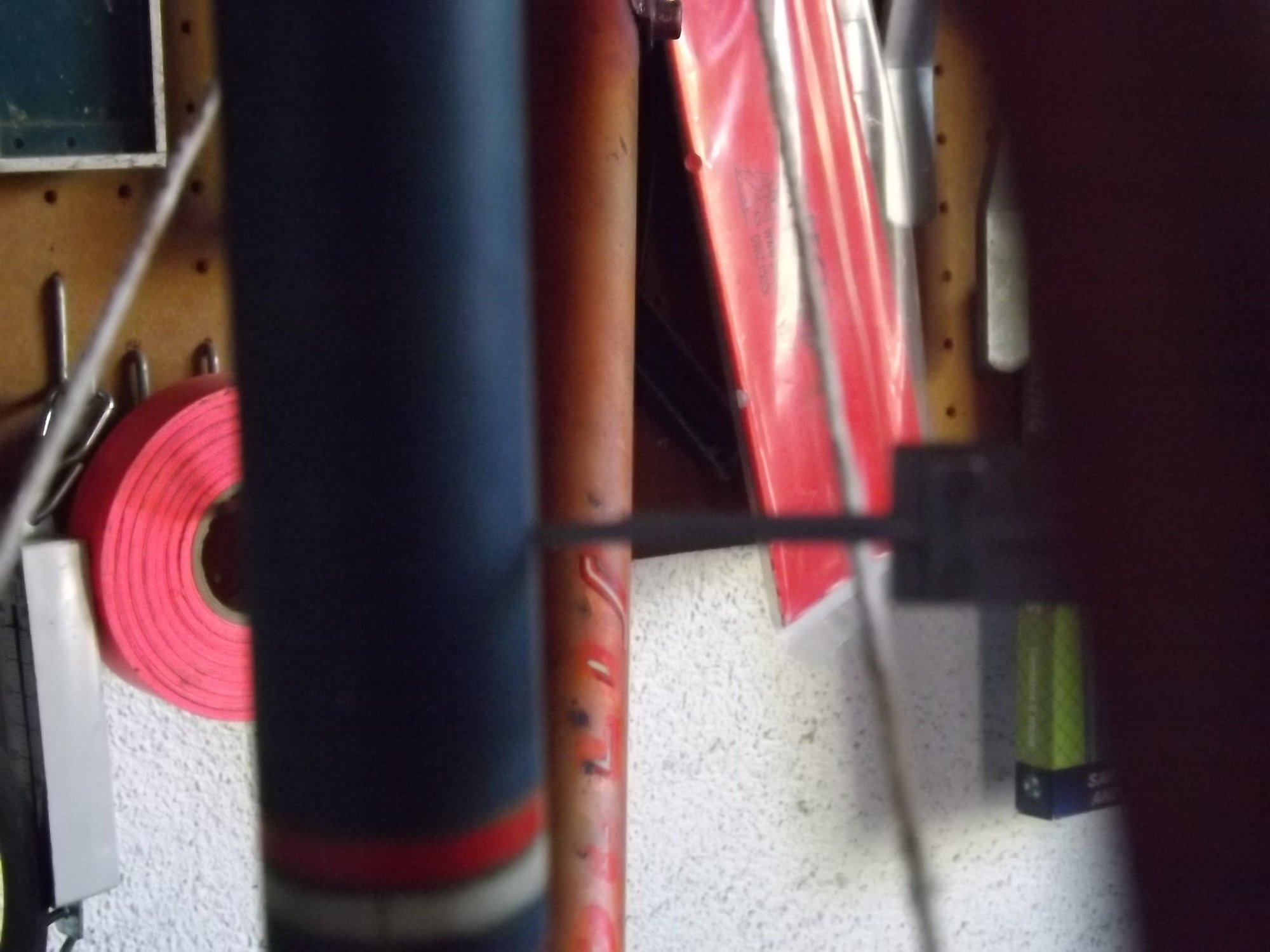

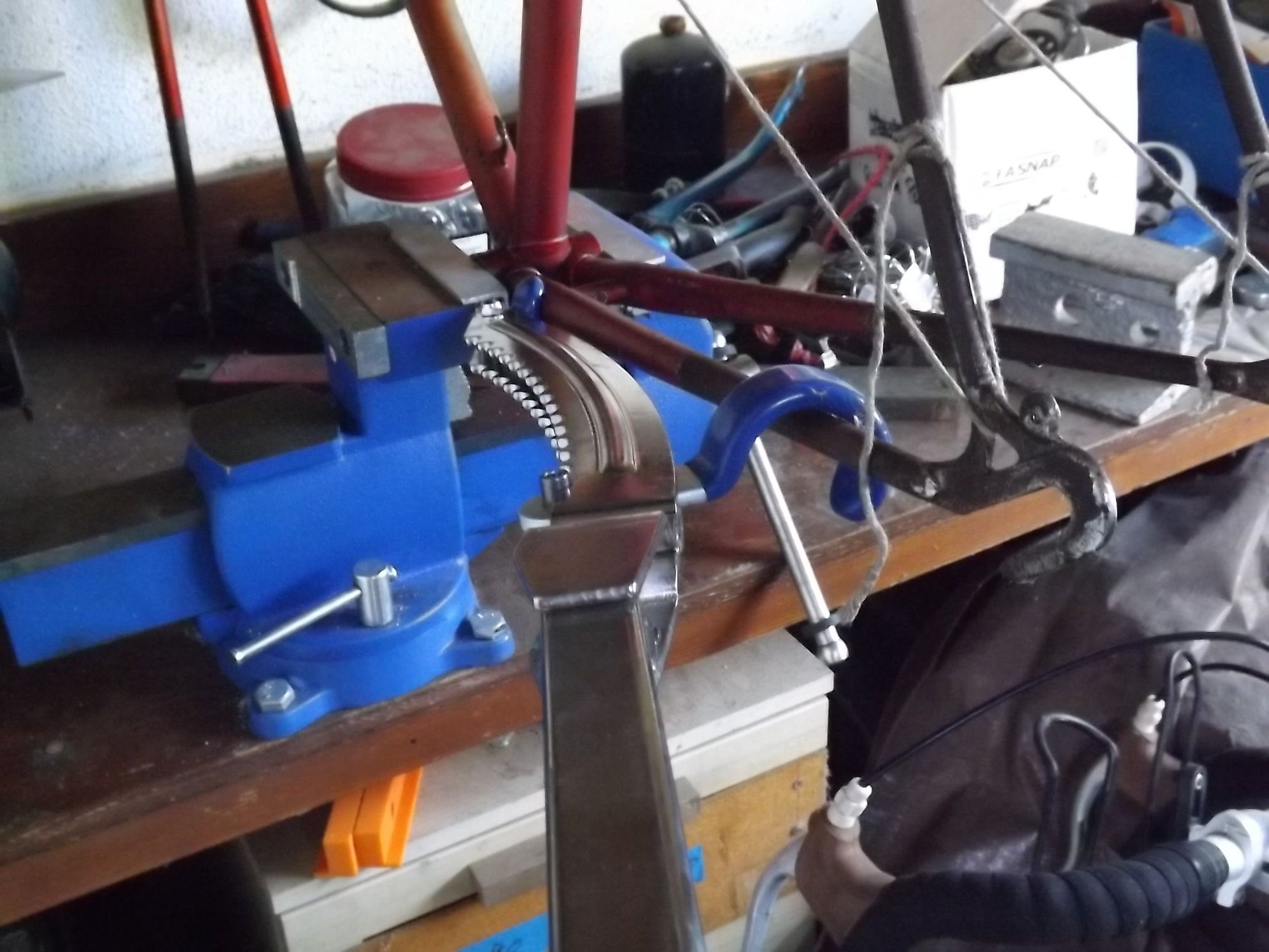

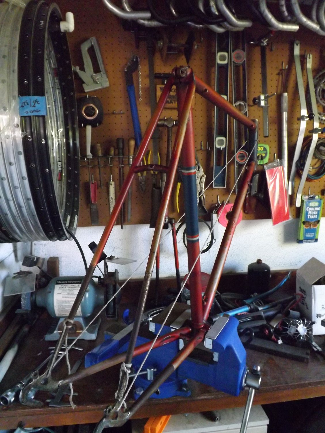

This is more or less how I do it here...
...you can improvise a lot, but you do need string, some sort of measuring device (a caliper works best, but you can get by with a ruler), some way to hold the frame while you tweak the stays (which you can often do with hand and arm strength alone on a frame like that), and some sort of homemade tool to do the final dropout alignment. You can pound them flat with a hammer on some flat steel surface, or wood blocks if that's all you have. the best way by far to flatten the dropouts is with a vise, squeezing them flat in the jaws one at a time.
My photos never seem to load in order here, but the last one is the initial setup.

That's smart, I have a good ol' workmate bench that acts as a vise but not as strong as a steel one. Should be able to maintain it in place with it with the bottom bracket.
Had trouble figuring out a couple of the shots though, is the string here so you can check the distance between it and the seat tube?
When you string it up, make sure the string comes off each dropout at the same point, or it can introduce some error.
In essence, you are at one and the same time trying to get the dropout spacing right for your new wheel OLD (120mm, 126mm. 130mm), and do it in such a way that each dropout surface is equidistant from the frame's centerline plane. Which is where you want the rear wheel to run.
