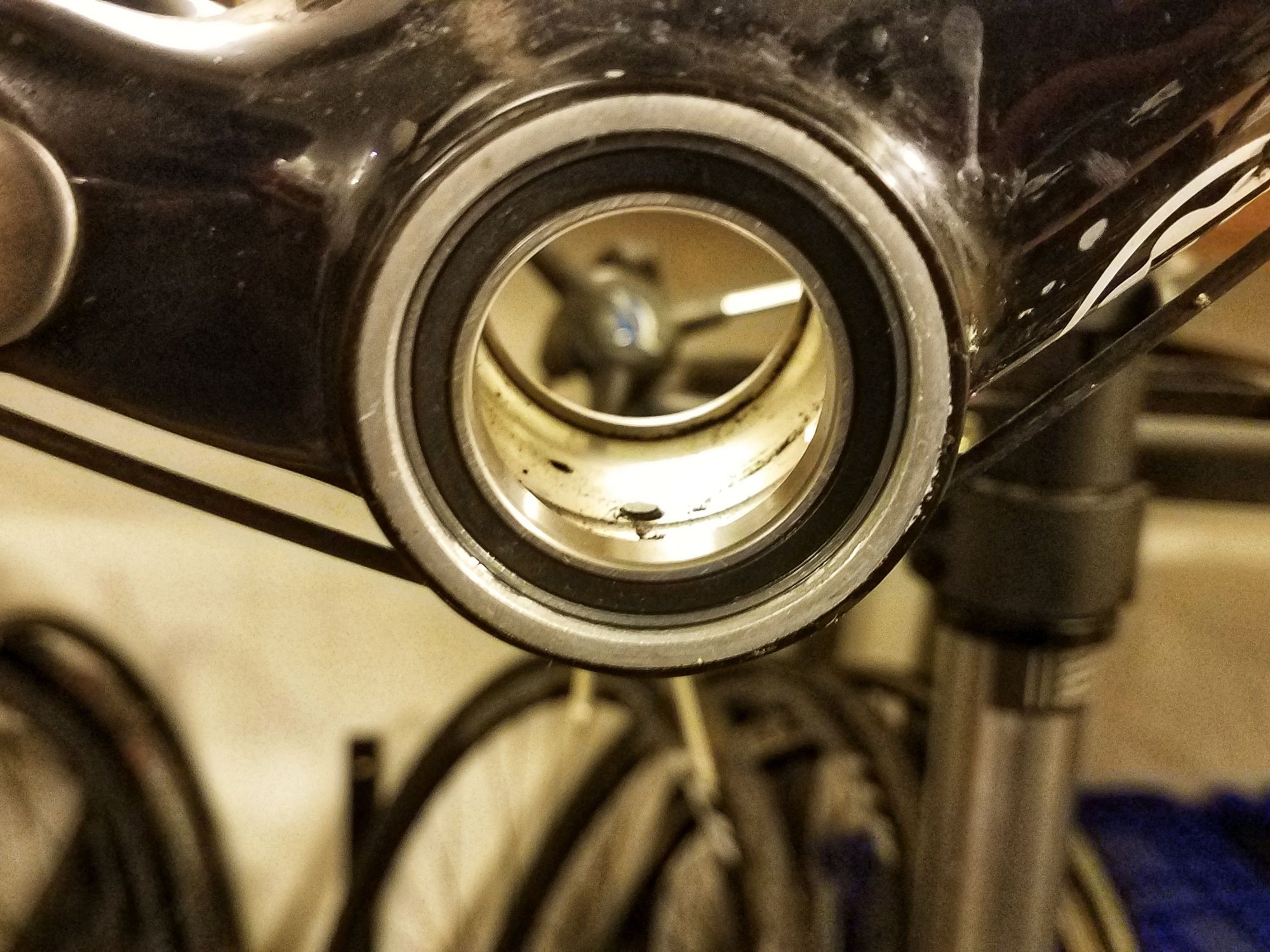

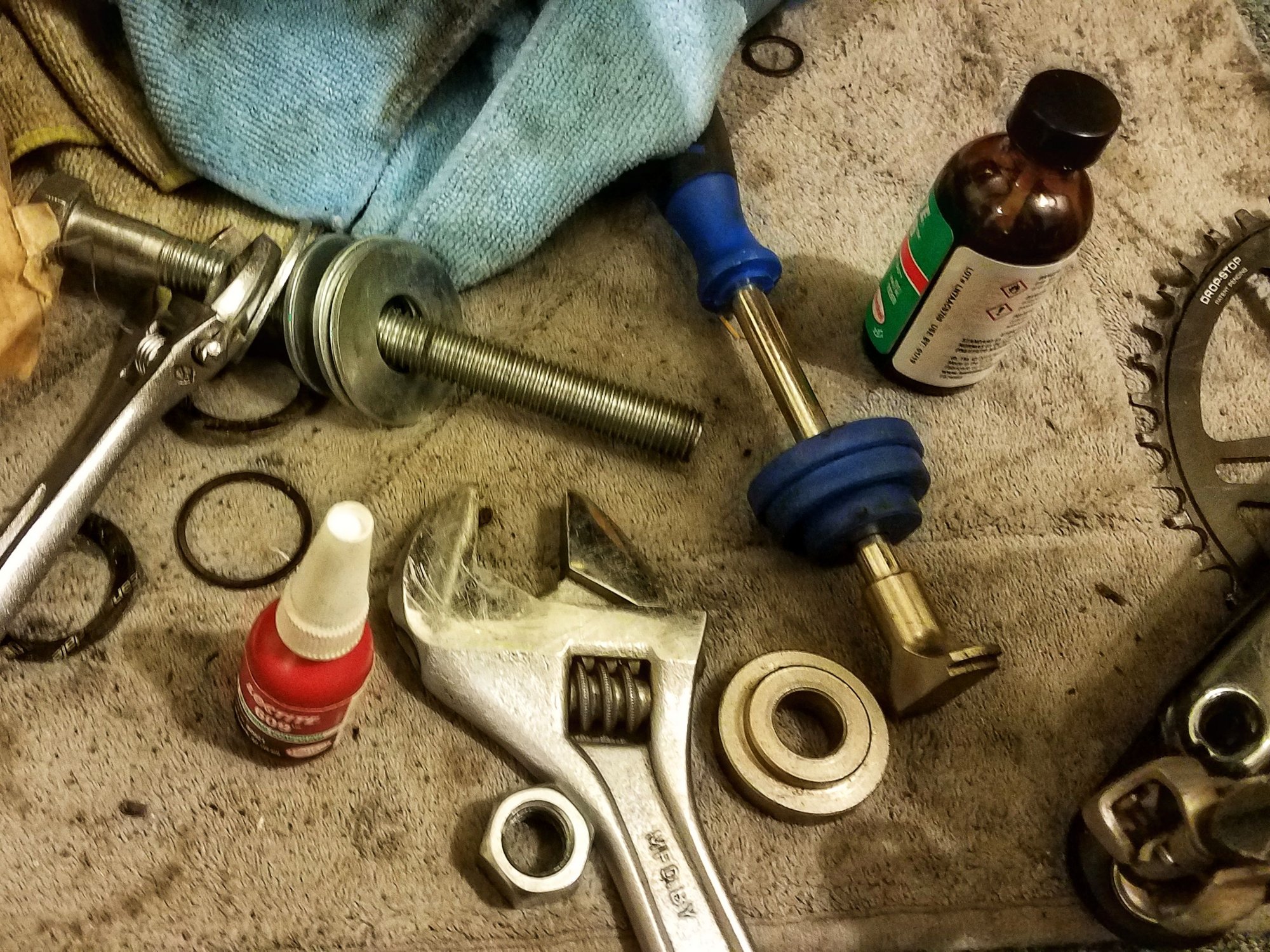

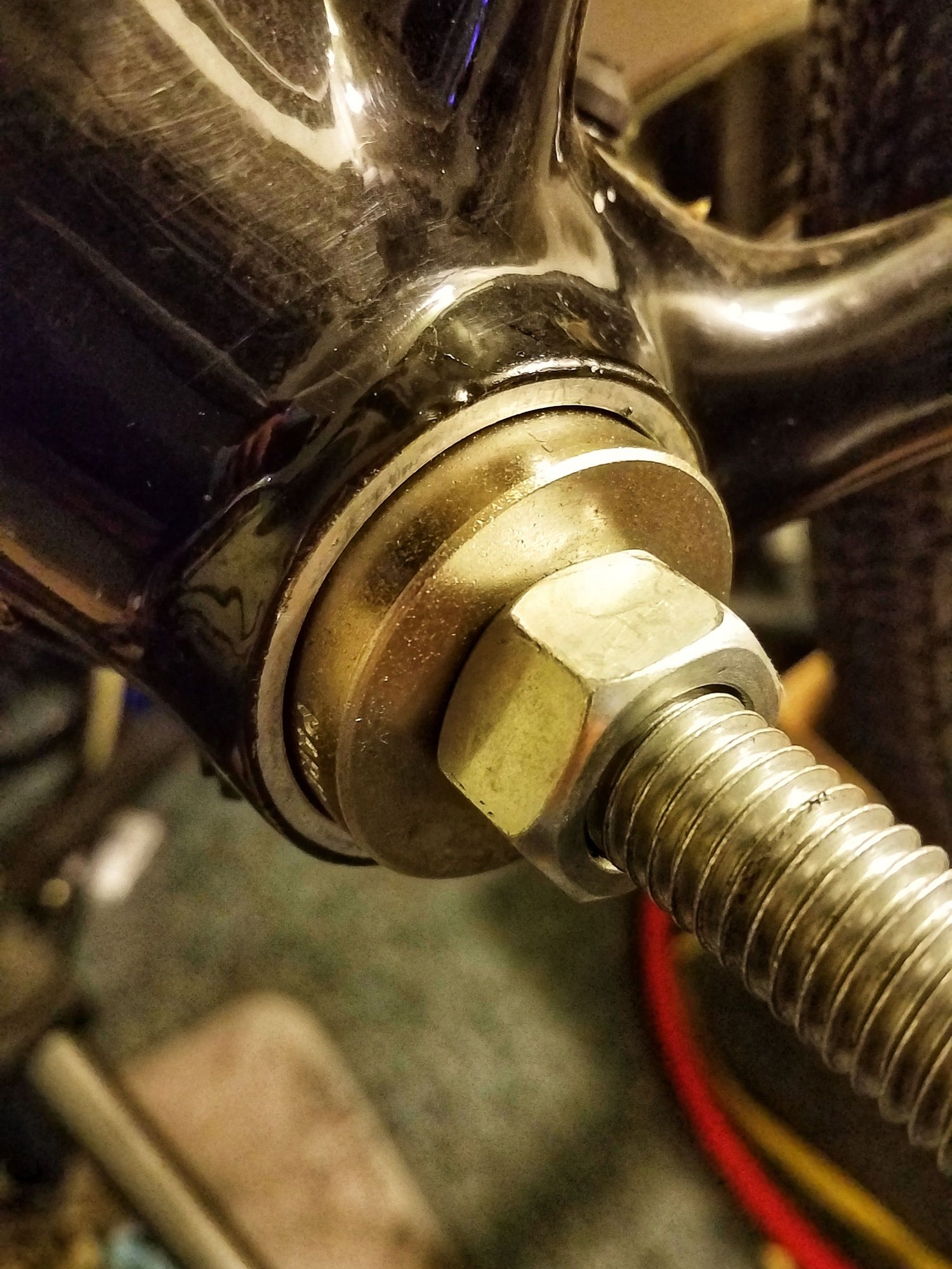

Has anyone here actually had a problem with BB30 on a cannondale? I've had 2 CAADXs and a SuperX all BB30 and they've all been fine, I replace the bearings and use loctite and they are flawless until the bearings themselves get crunch due to water ingress but that happens to just about any cyclocross bike

in what way? The same issue for cyclocross exists for both threaded and pressfit bearings due to the fact that a BB bearing cannot be truely sealed from water. The correct method to install a pressfit bearing is with loctite retaining compound or a similar product, it is specifically made for that purpose, also why shimano uses it on their cups or some other OEM retaining compound. If you ever get bored you can press one out of the cup and you'll see the config is not really all that different than what is pressed into your shell. I have multiple bikes with pressfit and threaded BBs and I guess i simply don't have a preference for one or the other, I look at all the other specs on the bike when deciding

My SuperX needed new bearings since it's been neglected ever since the end of last race season, I was able to do a full swap in the time since my last post so under an hour including finding my stupid hollowgram crank puller tools
