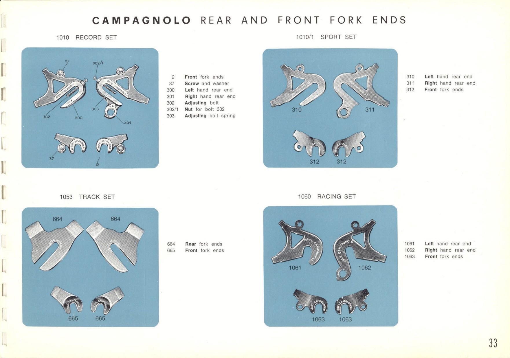

Hello Randy,
Frame -
lugset is Agrati "AMERICA"
upper head lug is item nr. 007.8505
lower head lug is item nr. 086.8053
seat lug is item nr. 086.8569
fork crown is item nr. 000.8528
dropouts are marked Campagnolo and are Sport model item 1010/1
the left is item nr. 310 and the right item nr. 311
fork ends, if present, are item nr. 312
if not marked Campag they will be Agrati item nr. 000.810
bottom bracket shell not shown in images
if it is plain, no notches/curves, then it is part of the Agrati "AMERICA" ensemble and is item nr. 022.8507
headset is Way-Assauto and is one of the very few original fittings present
into the 1960's Olmo was placing the serial on the backside of the seat lug in the format LNNN (letter number number number)
if you see the bicycle again you could check there
have sent email to Peter B to invite him to share his expertise

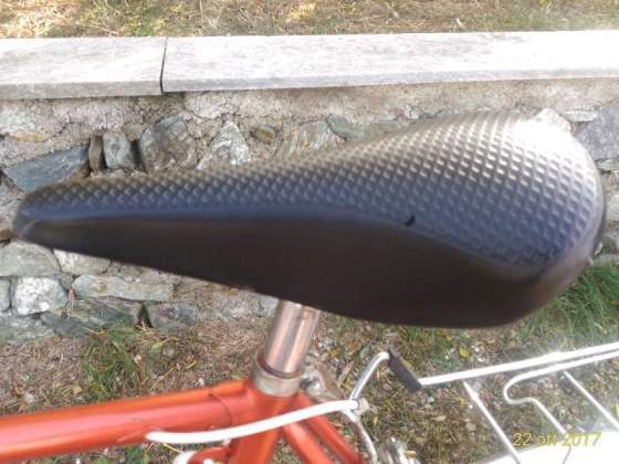

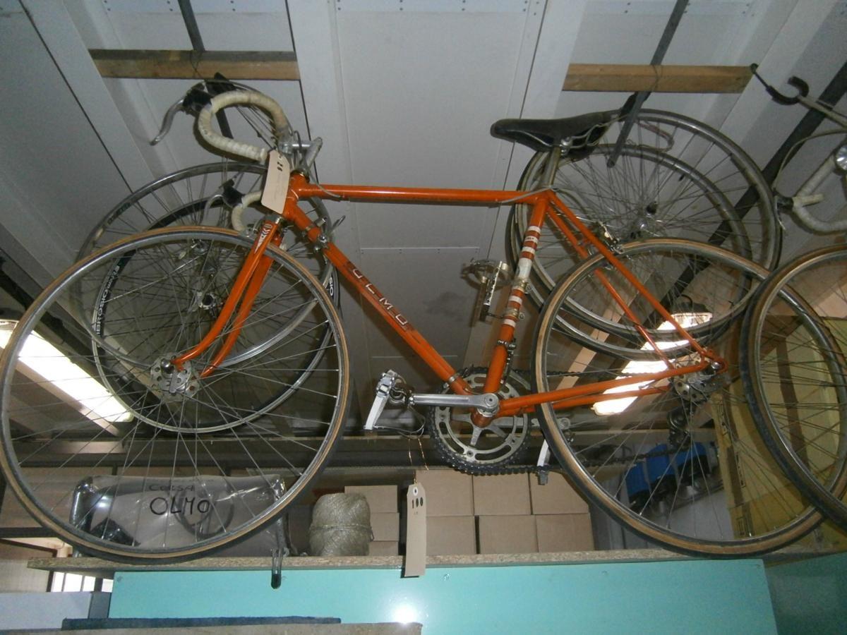

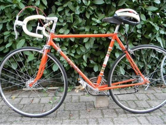

Olmo did not attach the seat stays to the seat lug in that manner. See Olmo Serial Number Dating Registry
Hello Peter,
Thanks very much for your post.

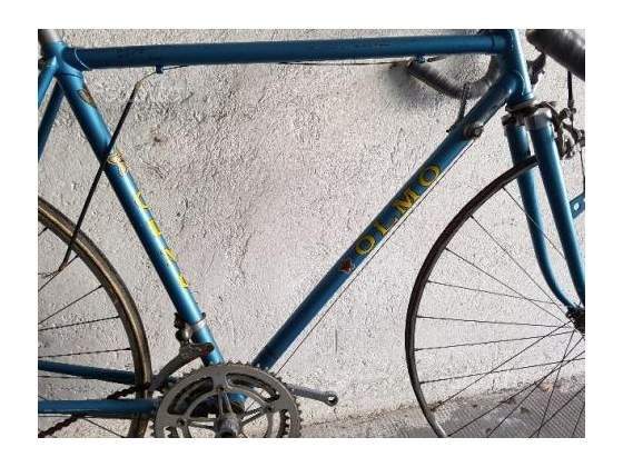

Slightly surprised by your statement as me dull olde "braine" seemed to recall seeing Olmo cycles with bullet seat stays.
Went a-gandering for a few minutes and turned up some examples.
[this machine wears a head transfer reading "SPRINT" and has Olmo downtube, seattube & fork blade transfers - SPRINT perhaps the house brand for a retailer]
found this example of the greatest interest as it wears the same ends and crown as our subject cycle -
cycle is discussed here with further images provided -
https://www.fixedforum.it/forum/topi...i-60-completa/
Reckon one might posit that all of these machines are contract builds done for Olmo by someone else. Even it this the case at least there are nominal Olmo bicycles with bullet seat stays.
Wagering me lira that Randy's find a genuine Peppino.

Peppino is the diminutive form of Giuseppe
Giuseppe was Sig. Olmo's first name
Orange bike mentioned in Randy post above is very much a midliner - a one up from the bottom sort of model. The Campag chainset is an upgrade.

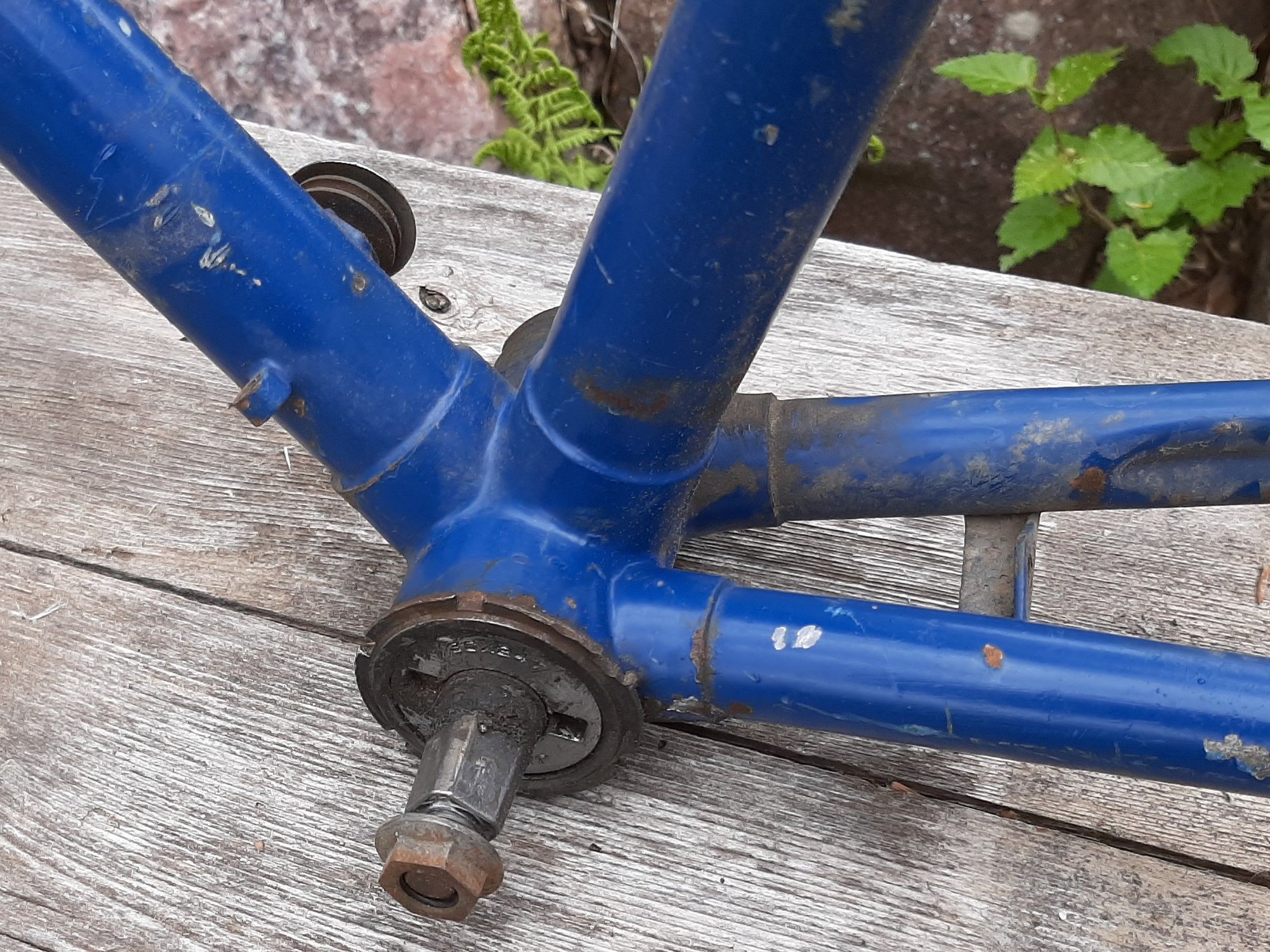

I started this thread a year or so ago. I had all but given up on buying this old Olmo, if that is what it really is. Anyway, I was responding to another thread, two or three hours ago, and the phone rings. The caller told me that he had an old Olmo and that I could have it for free. He gave me the bike in this thread.
Here is the bike with all of its upgraded stuff "as found" an hour, or so, ago...
The bike came with a nice wheel set. Shimano 105 hubs, seven speed cog set, and Campy rims...
Campy drops, front and back...
The only thing that suggests what make of bike this one is...
This little Huret derailleur cable reel might prove helpful in identifying age and model.
I still cannot find a serial number. Will have a more thorough look tomorrow. time permitting;

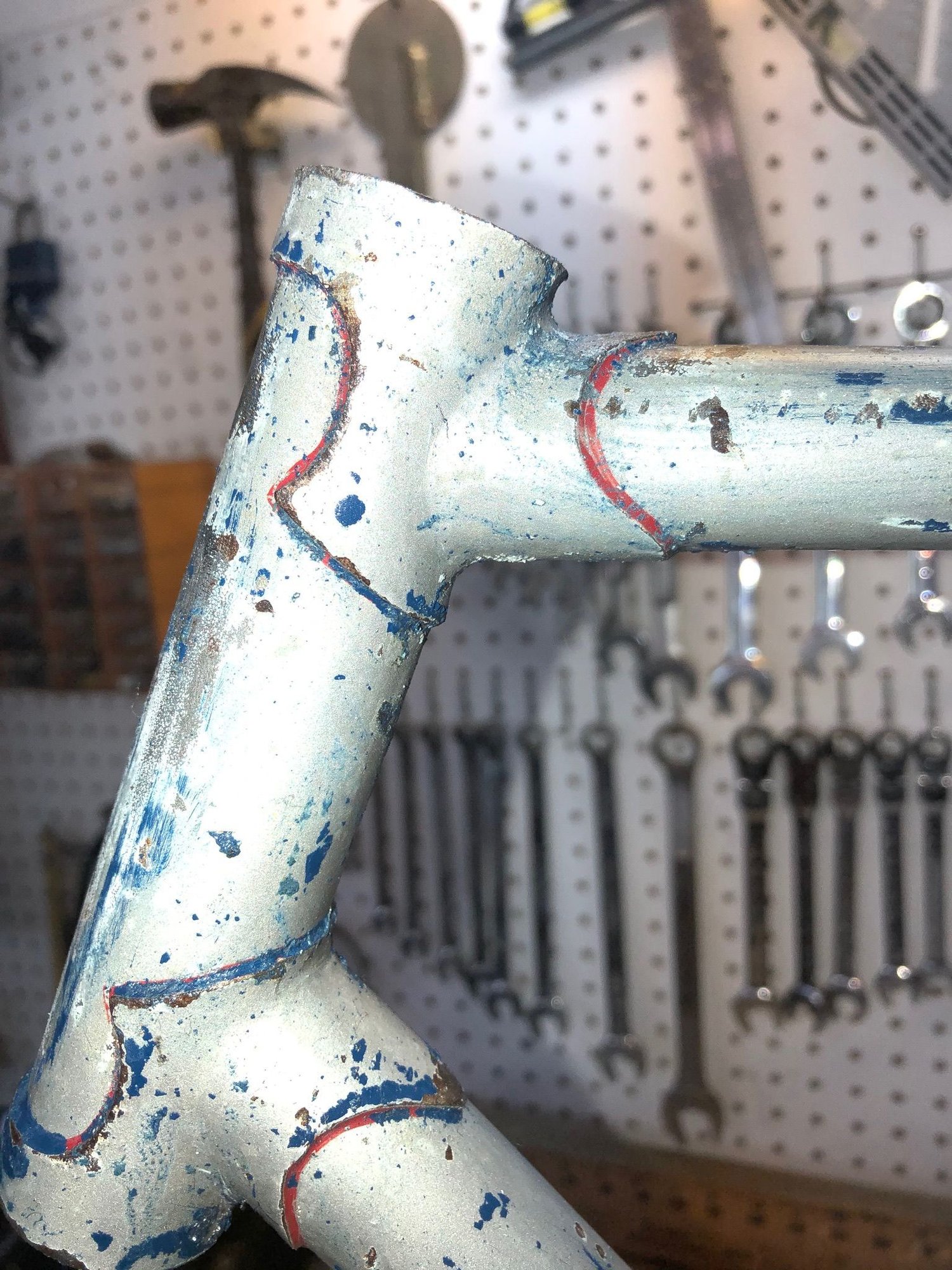

Finally found some time, steeled away from my mandatory daily focus on procrastination. Anyway, still trying to figure out what this old bike is. Italian, for sure, but what make and model? Vintage, from what I know about the bike before it was upgraded, should be mid to late fifties. Anyway, the frame and fork with hopes of learning a bit more...
This seat stay brace looks entry level to me. Any comments appreciated...
Correct bolt long gone...
Entry level Campy drops, front and back...

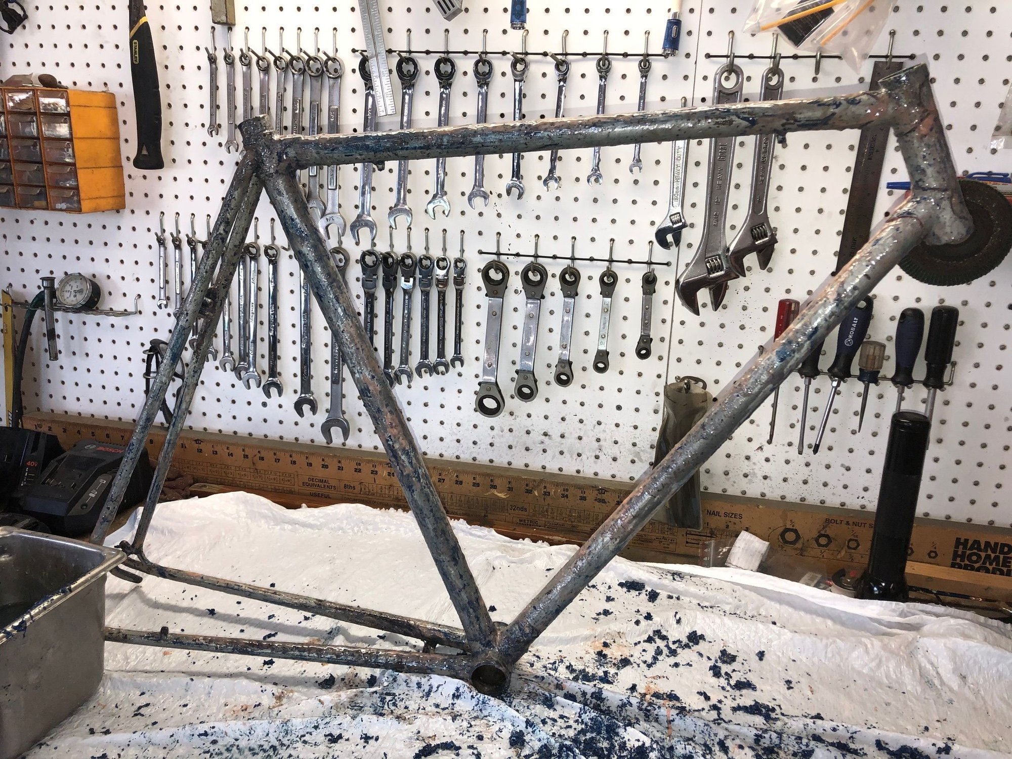

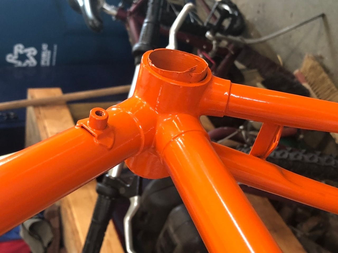

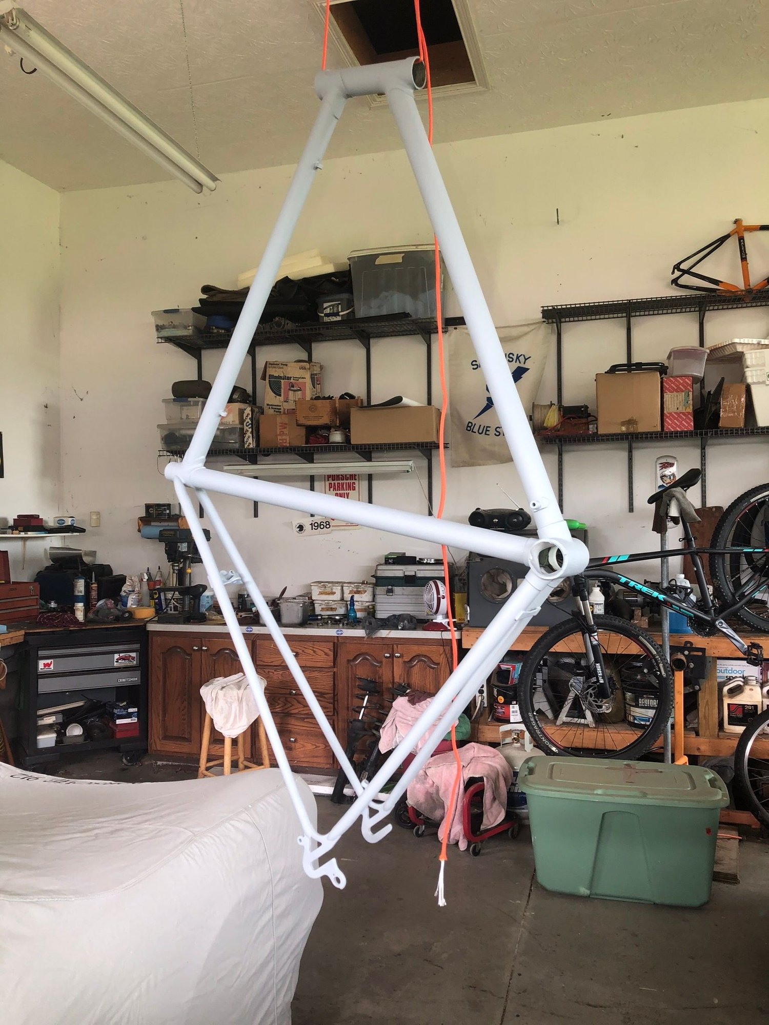

Ok, how about an update to this thread. Randy graciously turned over ownership of this old frame to me, but I cant say the mystery has been solved - and it may never get solved at this point. I’ve stripped the frame down to bare metal. In the process, I did uncover the original silver paint with red pinstriped lugs. The frame is in very good shape and has no apparent damage, no dings, nicks, gouges, nothing.
So at this point I think we have established that it isn’t a rare old racing model, and if it was an Olmo then it may have been a branded bike or a white label for another company. With that established, this bike will become something of a tribute bike. I have a 1982 Ross with lightly used but fairly good components that I am going to swap over to this frame. Being early 80’s components, this old bike will be treated like someone tried to ‘upgrade’ it in the early 80’s with new paint, period correct decals and components. So think of it as a retro restoration tribute bike - if that makes sense.
Now I just need to figure out what color.
Primered and waiting for paint

thanks very much for this update
fine work!
when you got down to the original finish were you able to see any trace of the transfers or perhaps a silouette/ghost image left thereby?
shall look forward to following along
all best to Herr Doktor Ferdinand
fine work!

I was looking closely but did not see any remnants of decals or even an outline.

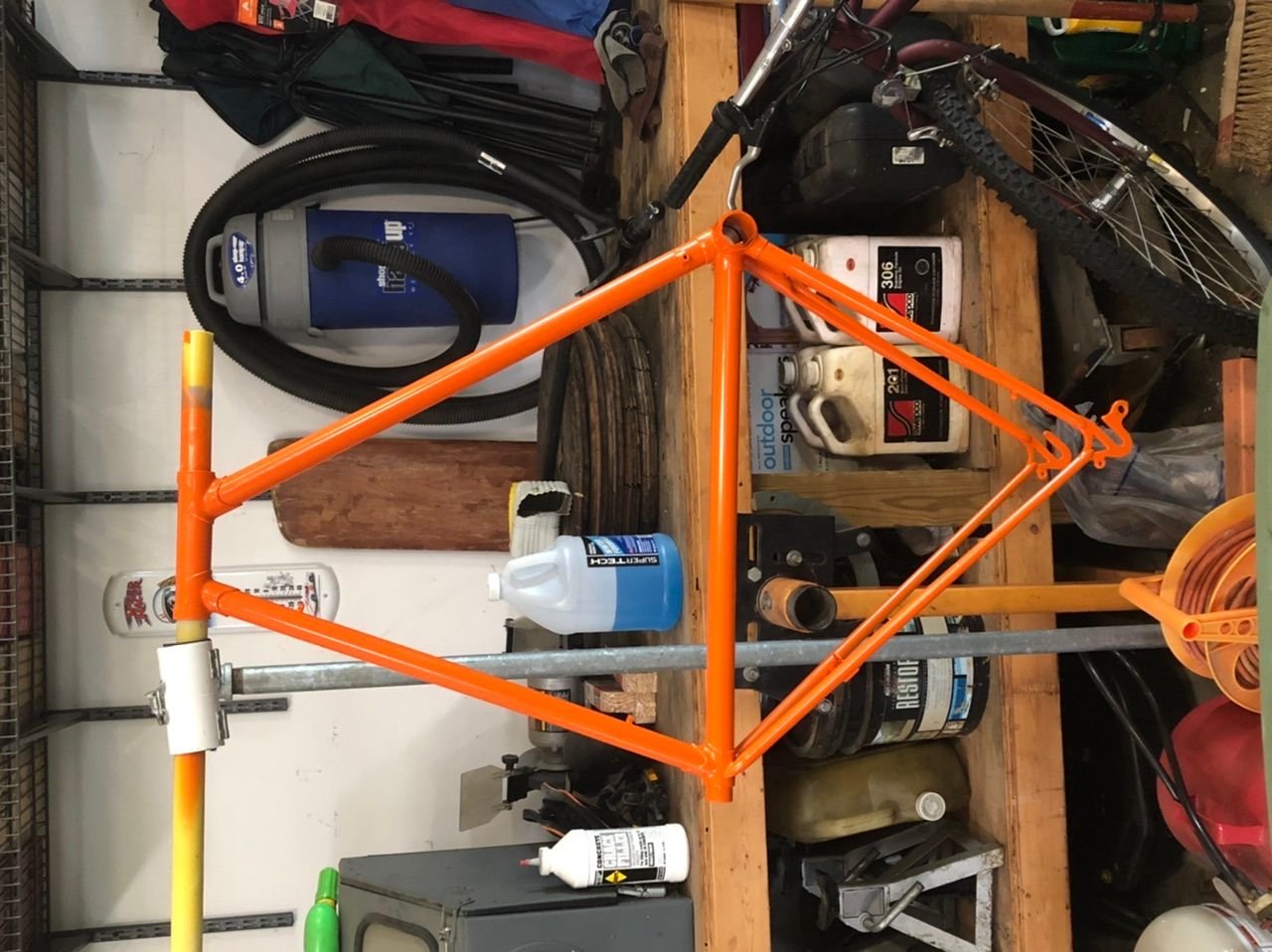

I missed this thread back when Randy started it, but this frame touches one of my current warm spots - old steel roadie, undefined tubing, decent build/brazing, long wheel base, thin rear stays and fork blades with a tight fork bend, and a laid-back seat tube. This should be a very comfortable ride!
And I learned that the steel headset on my old Cicli Rossignolo, all parts 1970 or sometimes earlier, was probably a Way-Assauto!.
a day after paint. As you can tell, I like color....

You had better be careful there!
Doing such fine work may cause nostro Don Randolfo to wish the frameset back.
Are you comtemplating fitment of Olmo transfers?
Forgot to ask earlier -
When you had things down to bare metal did you discover any additional markings? Were there any on steerer for example?
Very minor build note -
Tullio offered adjusters for these dropouts. They are part nr. 128/1 -
alternately, you could employ the similar ftting from Freres Huret or Juy, both of which were likely produced by ALGI.
that’s why I am thinking about doing the retro restoration tribute bike to bring it up to early 80s status and just use the parts I already have from the Ross mentioned earlier. I would love to go back to late 50s or early 60s campy components, but I also don’t want to go broke restoring a mystery bike. Would love additional thoughts around that, but it doesn’t feel like I am messing with a piece of history at this point.
Now the pretty little German car in the previous picture is all original right down to the original spare tire Still in the front trunk. That car is a survivor through and through and will only receive original equipment parts.

Nothing remotely off-base with your thought processes here!
Am sure you have plenty more of Monsieur Poirot's "leetle grey cells" than meself possesseth.
I would suggest to keep open the idea of some sort of vintage build which is "period plausible."
Many of the fittings for such are sure to be snoozing in members' parts bins awaiting appropriate use.
ebay values are fun for entertainment purposes and levity but for the most part not very "real world."
Here is one possible "road ensemble" for the bicycle which glided in from the aether -
since frame is Italian and fitted with Campag ends it is reasonable to think of it coming with a Campag gear ensemble. one idea would be a Sportman rear mech paired with a Gran Sport front mech and Gran Sport levers. the Sportman theme could be continued by using Campag Sportman hubs. a fun companion chainset would be the Campag Sport. several headsets would be plausible such as Campag Gran Sport, Way-Assauto or a Magistroni. for a stem & bar set an obvious choice would be Ambrosio. if you wanted to go all alloy you could fit an I-beam stem and companion alloy bar. more interesting would be to fit an Ambrosio steel stem with alloy bar. NITOR would be a natural pillar choice. for brakes would go with Balilla, either sidepull or centrepull just so long as the Corsa 61 lever with all-metal QR was part of the set. if you wished to keep things all Italian you would likely want some Sheffield or Wa pedals. an alternate might be the Lyotard Berthet. clips and straps could be Balilla, Cornez or Allara (AL-E).
would think that all or most of these bits are currently reposing in member parts boxes. when you explain your project to fellow members and why you wish to employ a particular fitting its delightlfully surprising how quickly it can make an appearance...
if any of the bits mentioned are unfamiliar to you they are all illustrated at VB.
