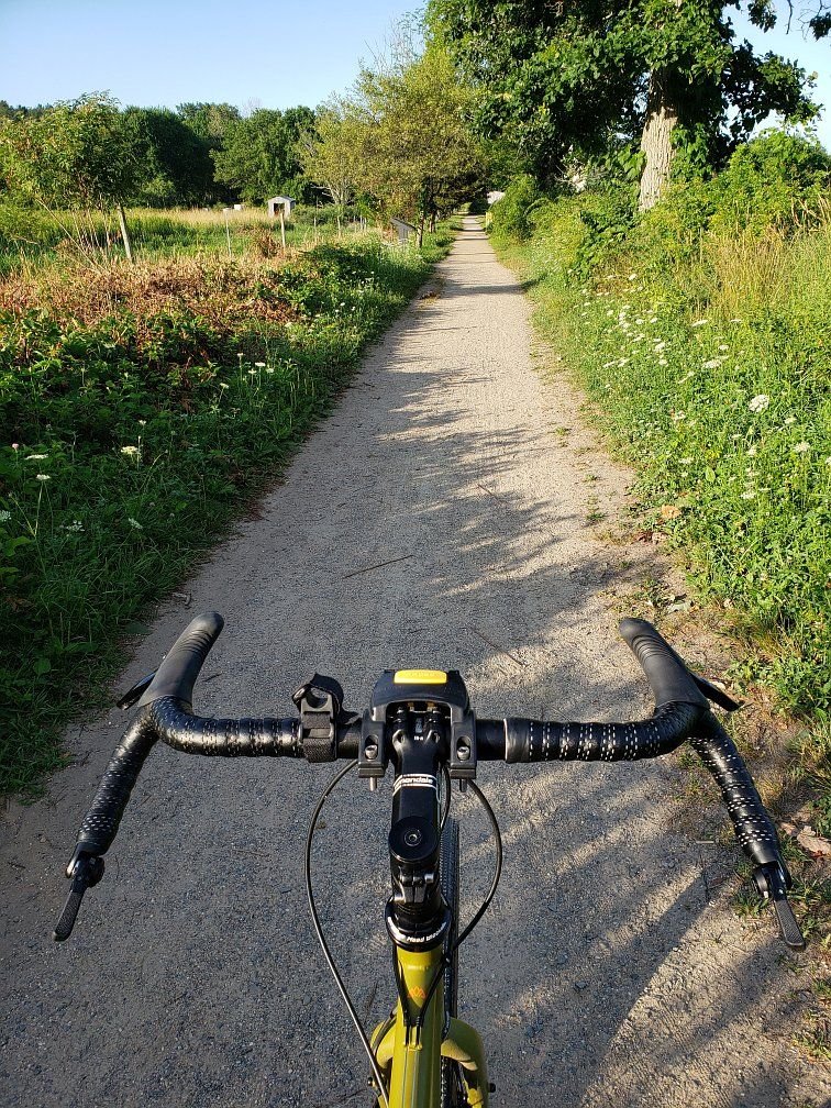

So, I've done 165 miles on the big 50mm GK SK+s and the verdict is... I love them.
They feel slower, but at 40-50PSI I have had no trouble beating Strava records I've set on this same bike with 40mm XPLOR MSO tires @80PSI, or - get this - getting very close to records set on pavement on my road bike on 28mm slicks @ 100PSI. I am running with tubes.
I usually average 15+ MPH on the road bike over 20+ miles (sure, might be slow for some), 13-14 MPH on the gravel bike. These tires didn't really change my avg gravel speed. I did a 20mi all-pavement ride averaging 14mph.
Now, on the straightaways they kind of feel slower, but they really shine in curves. Whatever marginal speed losses there might be are completely eclipsed by the huge amount of confidence and comfort these provide, which is exactly what I was looking for - I got them for mostly single-tracky trails. Not sure whether it's the low PSI (run them at 30 on hardpack) or the large contact patch, but I could just point the bike straight and roll over everything in the path, even sandy or rooty areas where with the MSOs I had to slow down a bit and carefully pick my line. Traction was about the same as the MSOs - plenty for my needs.
Had the bike with me on vacation and did an impromptu 50mi daytour with my wife; I was carrying all our stuff in panniers. Had no problem keeping up with her and didn't feel beaten up by the rough pavement at the end of the ride like she reported she did (25mm slicks at 100PSI).
If you do more pavement or smooth/packed gravel riding, then 40-42 and a slimmer tread is probably enough. I might go for a lower PSI tire maybe - the MSOs are a bit harsh even at the lowest end of 50PSI. I was looking for comfort here, but if you want speed, maybe the GOne or Ramblers are the way to go - I have not tried them.
When you've got nice hardpack, you can handle it even on 28mm tires, GKs don't offer much here
On loose sandy terrain, or coarser/rougher gravel/dirt you'll be more comfortable and can perhaps corner better than on narrower tires
This is the kind of stuff I got the 50mm for, where I would not want to go with the MSOs and if I did, I would have to pick my lines very carefully. The low-PSI GKs just rull over this stuff like nobody's business and soften the bumps.

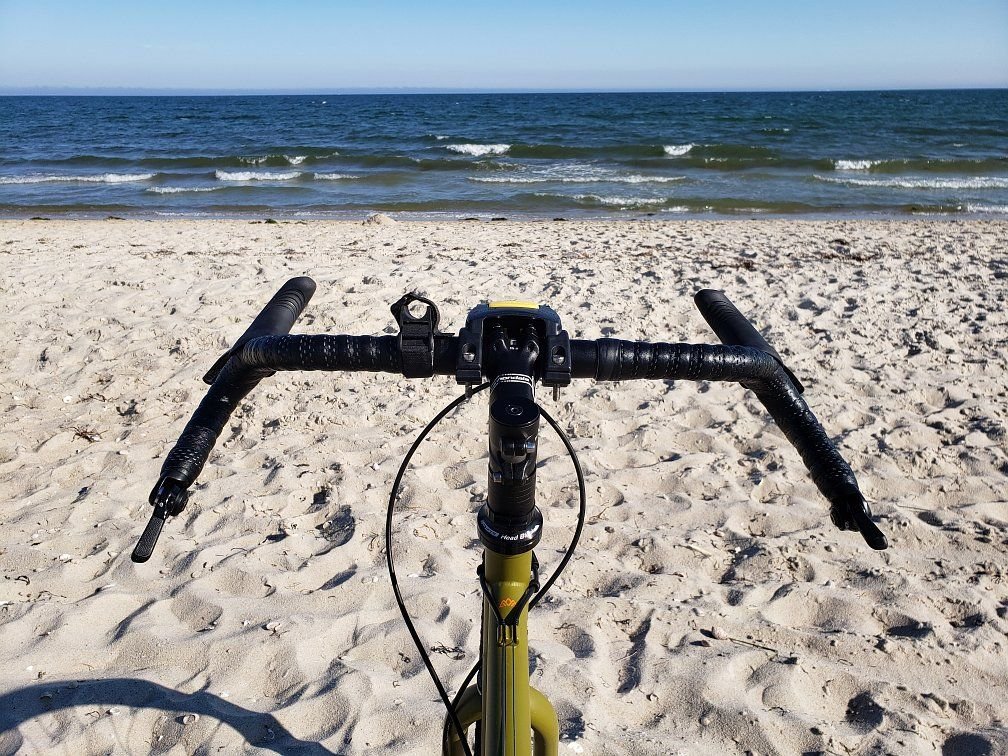

Nope, bring a fatbike. I didn't feel like dropping the pressure wicked low to test riding at the tide line, but at 30PSI the contact patch didn't seem wide enough, the tires would slide sideways in the wet sand.
