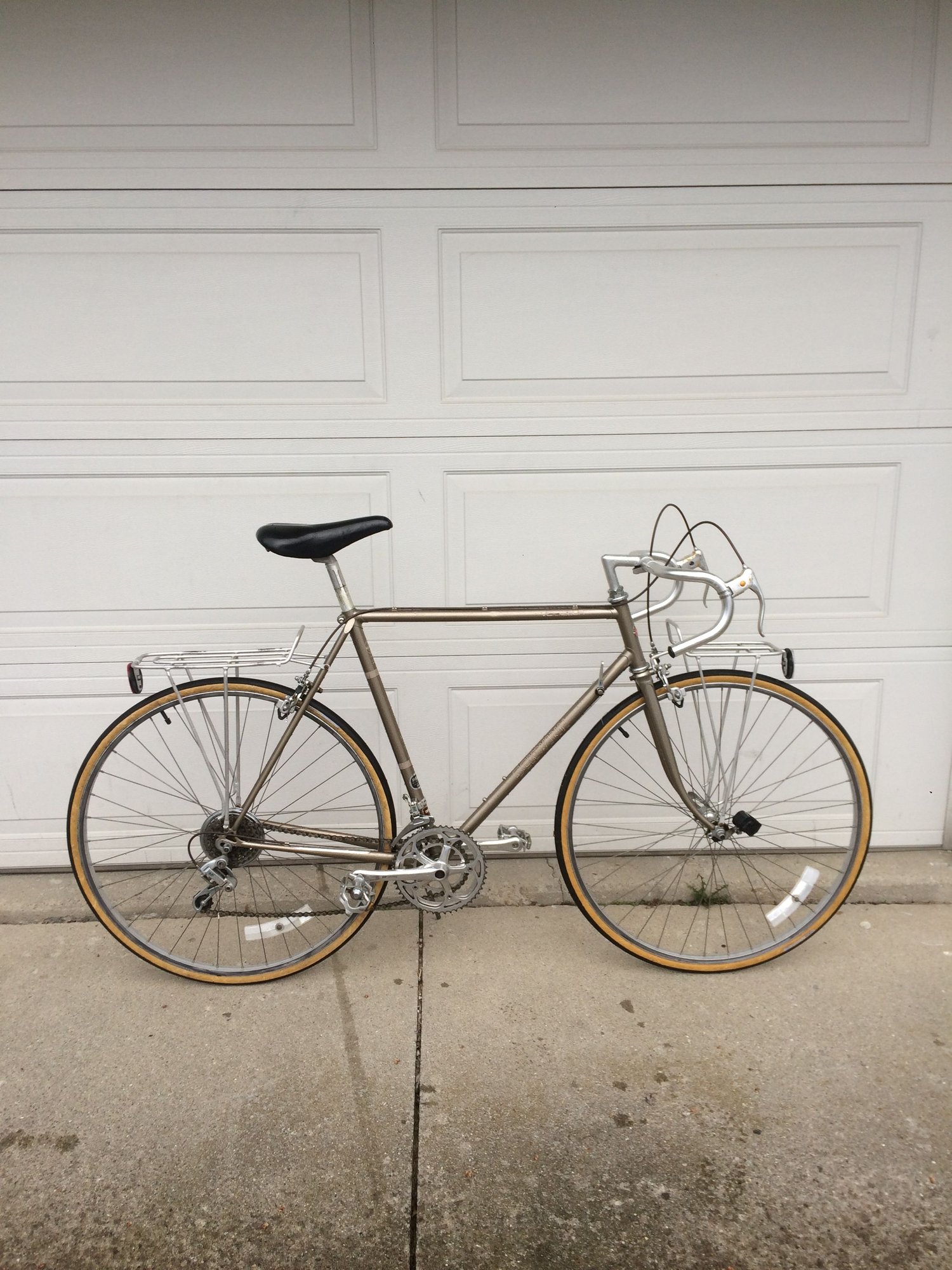

I'd keep your wheels, 36/ 40 spokes, sealed hubs, nice rims, made for touring. So what if they're a little heavy? How many lighter, modern wheels will still be in good shape 35
years from now? Maybe even add a dork disk for extra protection.

Take advantage of the fork! It has the brazons for mid-mount rack and lowriders. I suggest the majority weight bias forward. You'll notice a difference on steel frames. (For touring on aluminum frame, I prefer to balance front and rear.)
Can live with the simple down tube shifters. If the Brooks feels right, keep it.
Sealant in tubes. That's all.
Enjoy the adventure~

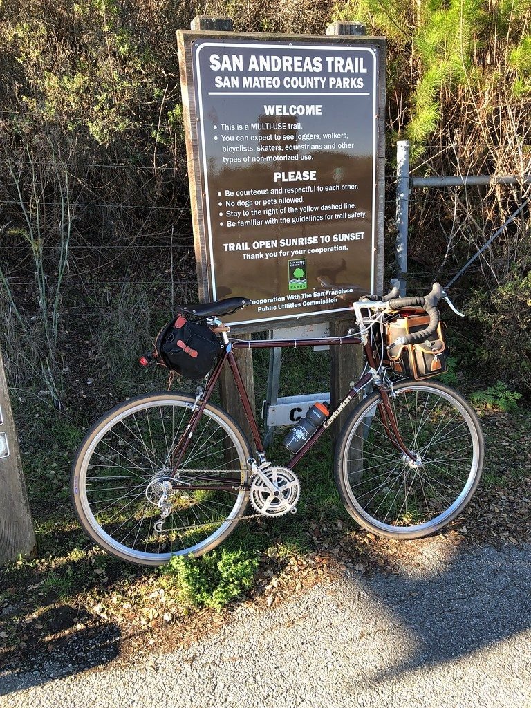

Here's my Pro Tour set up for "well packed" credit card touring.
Mine is a couple of years older than yours. Some OEM equipment, mostly just the frame is reused. First gen SunTour Cyclone, new wheels. I see nothing wrong with your wheels, and although I don't have any experience with the Mountechs, if you were doing long distance touring, I'd change it out. 5-6 days, maybe not. Like others I like the bar end shifters.
The geometry on the Pro Tour handles front loading pretty well. I would consider a Nitto Mark's rack with a good sized handlebar bag. If you're camping, I'd prefer lowriders up front before starting to load down the back end for optimal handling.
I run Compass 700c x 35's. That's too big for decent fender clearance, 32-33 might be the most I'd use with fenders.

Nice Centurion OP lost out on one like that a few years ago but came up with a Nishiki Cresta GT, I might suggest doing a shorter tour first as a shake down which should help you figure out what works and what you might want to change before going on an epic ride. I would agree with @Lascauxcaveman that wet doesn't have to be the death of a leather saddle. Care for it (proofide etc), fenders, saddle cover or plastic bag for the occasional downpour and you should be fine. I don't see cows running for cover every time it rains .

Like some have mentioned before me, add a front lowrider and shift most of the weight to the front.
Bring a backup pair of cantilever brakes or at the very least some Koolstop thinlines for the front.
Have the wheels checked and carry some extra spokes and mostly nipples.
I went touring on this bike last year and going down one of the very first mountains in Switserland I hit a pothole at speed, broke a few spokes in the rear. Had to remove the fender because the wheel was dragging so much and when I tried to adjust the front brakes to grab a little more one of the old brass bolts snapped off. Meaning I only had a badly working rear brake and 15 km left going down a hill. And of course a shop specializing in road bikes does not have canti's, let alone narrow-post ones, so I had it switched to long-reach caliper brakes for the rest of the tour.
But maybe I did have a bit of Murphy's law going on that day.

Looks like you have 36H front and 40H rear wheels. That 40 might be problematic in the event of a trashed wheel but, on the other hand, it might be strong enough to resist trashing. That's why it was specified for a touring bike.
I approve of the stem setup.
I 'toured' for years with a V-GT Luxe rear and Compe-V front on my old Fuji S-10S with SunTour barcons. Never had any problems.
My current 'touring bike' is a '84 Univega Gran Tourismo, pretty much outfitted like the OP's Centurion with Mountech, cantis, etc. Although I've never had an issue with the Mountechs, I'll probably put one of my spare V-GTs on the rear just because they are pretty much bomb-proof. Oh, and it now also wear SunTour barcons like all of my bikes that are ridden on roads...
Like his Centurion, my Uni has the original Araya 36/36 27" wheels with Sansin sealed hubs, and I've been running 1-1/4" Paselas on it for a close to a thousand miles so far.
I agree with 'upgrading' your brake pads to fresh KoolStops -- I'm using the dual-compounds.
Pedals? I'm still using the originals with toe clips and straps, but I might change them out for pinned platforms at some later date. I still use my old-but serviceable Specialized touring shoes...
Pump? I prefer a full-size frame pump, and have several vintage aluminum-body Zefal HPs that I've acquired over the years...
The most important thing is NOT to overthink things, and just Enjoy The Ride!!!

I'd rebuild the rear wheel with new spokes. Breaking those was the only mechanical problem I had on a ~600 mile tour on my '76 Raleigh with original parts.

First mechanical change I'd make: Replace the downtube shifters with barcons. Keeping a hand on the handlebar as I shift is important when I start carrying any kind of load up front. Helps steady the load, and I know exactly where the shifter is without looking for it.
If you're not carrying much up front other than a handlebar bag and a light load, might not make much of a difference.

What a gorgeous looking classic bicycle!
I too like low-rider front racks for two reasons. One is to balance the load and take a fair bit of weight off the rear wheel. The other reason? I use a 3 person dome tent and with the low-rider front rack I can remove the front wheel and park the bicycle INSIDE my tent at night. I'm quite hard of hearing and I like the security of the bike inside my tent. The low-rider front rack holds the bicycle pretty steady when the front wheel is off.
One other thing. I'd cut off those hose clamps where they protrude past the screw mechanism so that there's no chance of one of those protruding ends cutting your leg.
Cheers
Cheers

Hose clamps were temps until the correct clamps came in.
Cheers[/QUOTE]
