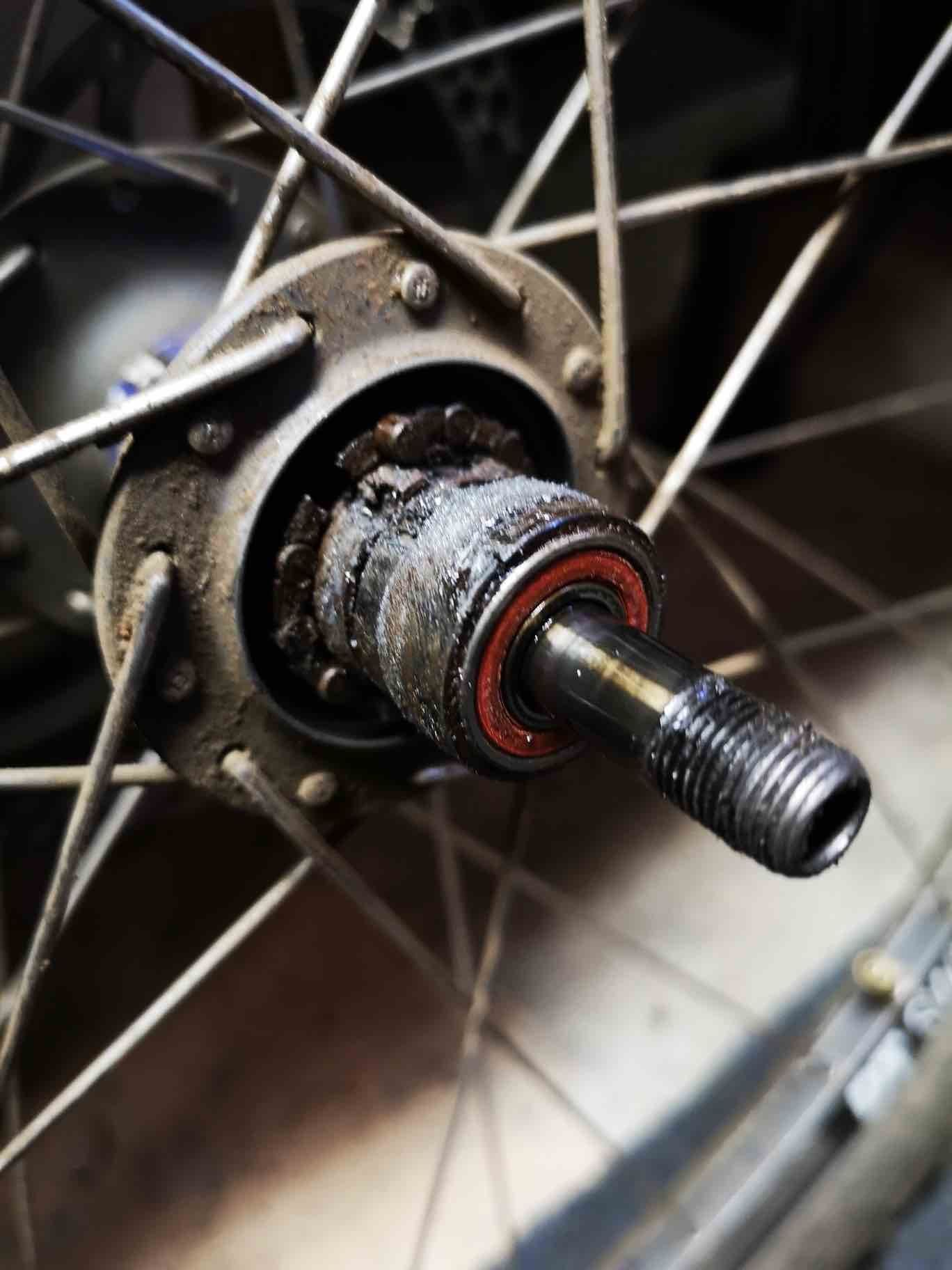

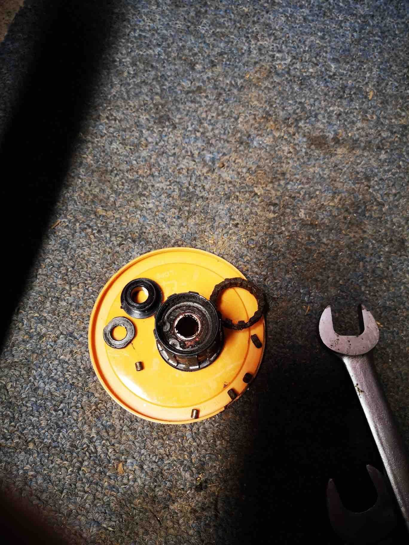

here is my progress 3 pics
pics of hub when off
on the hub
parts of the hub off
Hi there attached are 3 pics. i was able to get part of the free hub off, does this mean i should replace, what part should i just buy? the round metal part?
From the specs that I find you have a shimano freehub. You are going to need to overhaul the hub and flush out the freehub body and hope that it frees up. If not they are easy to find.
3 pictures above yes i should be able to do this job for sure, just i think i should just order a part as things are quite used
what would i be buying though for this fix? what else do i need to take off and replace from these photos? Thanks

No pawl springs will cause those issues , buy a new driver assembly..

Maybe find a discarded freehub body (not necessary for it to be the same number of "speeds"/ sprockets/gears but must be same brand and preferably same year/vintage), and remove the pawls spring to reuse on yours.

freehub parts generally do not transfer from one hub model to another. there are dozens hundreds of freehub designs. you might be able to rebuild the existing freehub with new parts to make it work again, but you'll need the parts made specifically for that hub model. if you need to replace the whole freehub, you'll need to find one that is made specifically for that DT Swiss hub. is that a X1800 hub? I can't read that sticker.
also: holy smokes, that is the dirtiest hub insides I have ever seen! preventative maintenance would have helped, but now you've hopefully learned that lesson.

If you value your teeth and your testicles I would replace that freehub. I had a freewheel let loose on power stroke and ended up on the side of the road. I had no idea what happened. Two weeks later it let loose a second time when I tried to pull out in traffic. I trashed the entire wheel after that.
All that residue in your first picture was metal particles that ground away from the inside of the hub. There appears to be a good bit of rust as well. Seals must have failed and the lube washed out over time. Or maybe it has been underwater more than once? At any rate I would break out the jam cause that is completely toast
DT swiss replacement free hubs are available on line.
https://www.jensonusa.com/Freehub-Bodies?brand=DT+Swiss
Contact DT swiss product support and figure out what model you need for your particular hub. They have an excellent reputation, they will help.
Not sure what sort of preventative maintenance people are talking about. I have some pretty old freehubs that have never been apart. At the same time none of them have ever been submerged. That thing had to have been making some noise before it failed.
