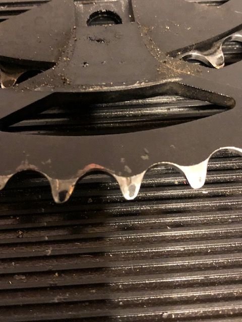

Are these chainrings too worn? Shifting has been less than great, chain is new and FD has been adjusted so the only thing I can think of next is the rings are getting too far worn?
Opinions would be helpful..

If those were some chainrings from the 50ies i would say yes since the teeth don‘t seem to be symetrical. On modern chainrings however that shape might be a design feature.

More importantly, does the chain sit at the bottom of the teeth without slop?

yes, no issues, no chain suck either. Just getting not as crisp shifting as I think it should be. Might just be in my head too....rings are from 2015 so not even that old really.

Slower shifting troubleshooting
Is the question about chainring shifting, or rear cog shifting?
On the chainring shifts, is it shifting to the large ring that's lagging? The shift to the small ring should drop right in.
It might need just a small derailleur adjustment, even though you recently had it done. (Fine tuning a derailleur cable is a good skill to have. You don't need to take it in to get it perfect. It's not hard to learn. Setting up a new derailleur from scratch is more complicated, with limit screws, etc.)
Or a new shifter cable with new housing. But I think it's rare for a front cable to need replacing. The rear cable is shifted way more often, and wears out, and frays from bending within the shifter.
Chainring wear
They look fine. The anodizing wears off quickly, and the teeth are machined in different profiles for quick shifting.
I posted this in a previous thread:
My Ultegra 11 speed chainrings after about 5000 miles. This is minimal wear. (I'm now well over 20,000 miles, and the rings are still good.)
Note, this is a photo of the inward side of the chainrings. The chain is pulled against the left side of the teeth, and the chain is traveling counter clockwise. An outside photo, like yours, is the opposite.

I am thinking I am now crazy. I am going to re-adjust my FD and see if I have that off. Mike look like that...nothing really majorly different.

Whenever my chainrings become super-worn I start to drop chains like crazy. That's when I know it's time to replace them.

Maybe your cables or shifter are getting worn. (Shifters last a long time, cables not so much and they're cheap to replace.)

Cables are 2 years old but that doesn't mean they don't need replacing. I do get lots of miles in so that is my next step probably. I adjusted the FD and went over everything again. If this doesn't remedy it I will put new cables on the complete bike.
then if all else fails I will go big with chainrings.

Easy way to check: take that little piece of chain you took off when you shortened the chain to install. Put it on the teeth of the big chainring, and try to slide the chain back and forth. It should only move a tiny bit, if at all. If you can slide it back and forth, or it doesn't want to sit all the way down onto the teeth, the chainring is worn. Note: even with alloy rings, this can take a whole lot of miles. Tens of thousands-- so long as you didn't use a chain far longer than you should have. I have two chainrings that have a bit of slop to them, both well byond 15k miles, and both who have lived through at least one chain used longer than it should have.
thank you for that tip/trick.

I went for a quick 5 miles tonight after some re adjusting and had no issues. Put it through the paces hard and did a couple of high wattage intervals with hard shifting and it was ok. I must have just not had it right. I am going to still recable the bike this winter though.
