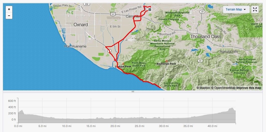

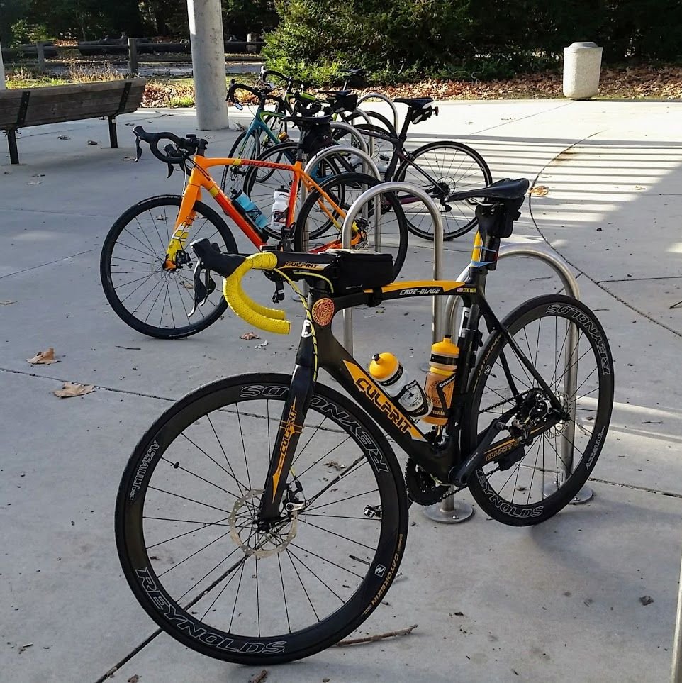

I rode this course today, as I often do. I had a personal best 17.4 mph average on my '73 Raleigh Super Course. I also have a fancy carbon everything, 2013 Culprit, Di2, disc brakes, and my personal best on it was 17.3, the same time I set on my '64 Legnano, with old school Campy six speed. Its not always about the bike. This is a fairly flat course, but I also set a personal best climbing Santa Susana Pass near my house on the same Super Course, when I couldn't get into the granny gear, and was forced to ride up in the middle 40t chain ring. Don't over think it, or overspend, just love what you ride and ride what you love.
Today's ride, Camarillo to Malibu and back, 44 miles.
'73 Raleigh Super Course, mostly Sun Tour and Sugino swap meet drivetrain, 26 lb. old school steel.
My 2013 Culprit, all the bells and whistles, under 20 lbs.
My 64 Legnano, had since new, my old race bike, 23ish lbs.
