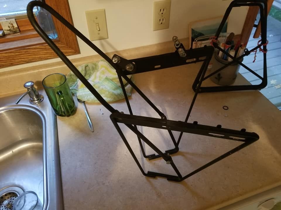

I have some Blackburn racks that have accumulated over the years. I can also get this Ibera dirt cheap
Close to purchasing a Miyata 1000 or may just use my Cannondale ST.
I assume all the new clip in bags are not universal ? I assume if using a Blackburn, bungee cords or diy nylon straps are used for most everything? If I purchase the Ibera then I assume only Ibera bags will work perfectly and others will require some MacGyver skills ? Light touring is what I am expecting to do as a start. Hope that gives you a better idea where I'm at. Ground zero basically. Just want to know whats down the road with the decisions I may make today. I don't want to choose racks today and regret it when looking for bags tomorrow. Or maybe the cantilever seat post bags and bar mounted bags are the way to go and forget the racks ? Hence the what's hot what's not

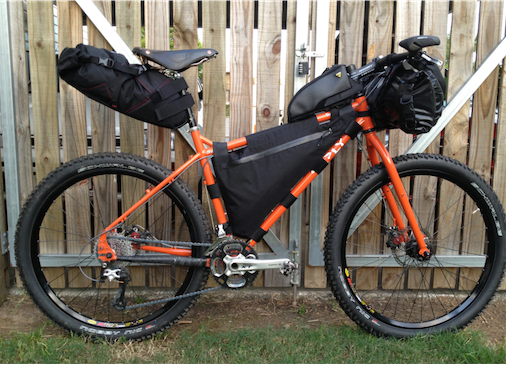

What 's hot?
Bike packing, frame bags, 1X drive systems, disc brakes, plus tires, tubeless.
What's not?
Racks and Panniers, rim brakes, skinny tires.
The old stuff worked, so does the new stuff. Use what works for you.

For racks, Tubus is certainly at or very close to the top, high quality, steel (or titanium) lightweight racks that are tour proven. Blackburn and Topeak make some decent stuff but I don't care for aluminum racks while touring, Surly Nice racks are excellent quality but very heavy and Nitto quite the same. Plenty of lower quality cheap racks out there but heavy or poor weight capacity rules them out. If I was to go with a modular type system, it would be Racktime for sure, tons of awesome bag and basket options and they are owned by Tubus so the quality is there and loads of great testing but again not a huge fan of aluminum for touring. Weight capacity tends to be lower for aluminum and I cannot easily repair it then again most of my touring is in the U.S. so it is not a huge concern.
Bikepacking stuff can be great but you have to be good at packing and pack really compact and light to make it work. I just bought an Oveja Negra frame bag and am quite happy with it quality wise and the size is small but does the job I need it to do. I also like my Topeak BackLoader but I maybe would have liked something fully waterproof rather than have a dry sack in it (which they provide) but so far no real complaints on it. I haven't yet tried any front loading roll type stuff but I do have a Swift Industries Rando bag which I love and recommend if you go the rando rack route.
All that being said I like my more traditional pannier set up, I like having pockets and more space and while I still strive to carry lightweight stuff I can more easily carry some stuff less awkwardly then with some of the bikepacking stuff

When you say "building a tourer", do you mean building a bike from the frame up or adding racks to an existing bike?
I built up an LHT this past winter and going with what is "hot" was more complicated than I thought. Compatibility between derailleurs, shifters, brake sets, frame and of course component colors, took a lot of research. In the end, I went withe tried and true 3x9 . A big challenge was the little things.
For racks, I settled for 2nd best, I went with Tubus, They are nice, but not much better than the other brands. Panniers are usually "one fits all", but it's always good to make sure

I hear ya. I saw the Tubus' once at a bike show, so really did not check them out, but the way people on the net rave about them, I thought they would help me conquer the world.
In the end, they were twice as much as other brands and half as much as Surlys, so I compromised.
I think they are well made, they state that their weight capacity is much higher than what is declared but they don't want people using it to mount child carriers, thus the standard 25 kg limit.
The front racks do not fit perfectly on my LHT, so had to figure out a different mounting
I found the paint chips easily. I have not done any "rough" tours yet, but I suspect they will not look good at the end of one

for sure they are well made, for me the main reason I got them was that I figured it was worth getting really good ones, and I knew that they have a real solid reputation for being solid and all that. The price was rather shocking, but I was able to find the front rack on sale during the winter, and paid more or less full price for the rear, but at that point just wanted to have them both. Oh, also the rear I got is the two level one, with the panniers lower--but I got it specifically because I knew that it would work on my frame due to the long attachment arms, my frame is more of a mountain bike type frame shape, so it needs a rack with longer horizontal attachment arms, and I had seen evidence that many people had successfully used this rack on the Troll, my bike.
re the paint, I put tape and even some rubber tubing on my racks, to thicken them up and I have to use my panniers without the small inserts that go in them, the inserts of diff sizes for diff rack rail thicknesses. So as well as stopping the paint rubbing off, the main reason was to reduce any pannier movement on the rails, to avoid or lessen things loosening up over time from all the vibrations.
I also put some tape on the other contact points, but one has to accept that some paint will come off, and paint touchups will have to done at some point--but I always have some black metal paint I use to touch up metal railings at my house, and also my steel winter car tire rims.

Originally Posted by tcs
Pretty much what I was thinking as far as what was hot. I probably won't do any of that - LOL. Looks cool though.
Do frame bags automatically mean paint wear ??
think of it this way, any time that anything rubs constantly against something, wear occurs.
Look at how brake or shifter housings up near headtubes end up wearing away paint over time from turning the bars back and forth.
Our shoes often rub off paint off our crankset arms......etc
common sense is that frame bags used on gravel and whatnot are going to mean bikes with more dirt and dust on them, so more abrasive getting inbetween frame bag straps and frame ---rub rub rub, three men in a tub, so at least some tape will help reduce this at the key contact points.

Going to take a look at these this weekend. All from the same seller. I didn't get the brand name of the racks but if anyone has some advice it would be appreciated. I asked to make sure all of the brackets are gathered up as I don't really want to have to fabricate a bunch of stuff. The prices are certainly right.

the top rack is probably a Blackburn, I have a 1990 lowrider by them, and they remained unchanged for ages, and then knockoffs started being made. Simple, light, work alright, I always had light front panniers so it worked out.
in the bottom photo, the rear rack could be an old blackburn also, but it could be a newer one by whatever brand--I have numerous identical ones and they work fine too--maybe just look and make sure there arent any obvious cracks or whatever.
oh, the lowrider with the hoop is the type that ortlieb front panniers dont work on because of the top rail design, the "enclosing" doohicky parts of ortliebs cannot encircle the top part of the rack, because of that welded on vertical part.
panniers--the old cannondales. I had an identical set made my another company, but there were loads of similar zippered panniers like ths back then. Hey, they work, not waterproof at all so you have to wrap your stuff in bags. but hey, all this stuff will work and you'll see if yoiu like this activity.
