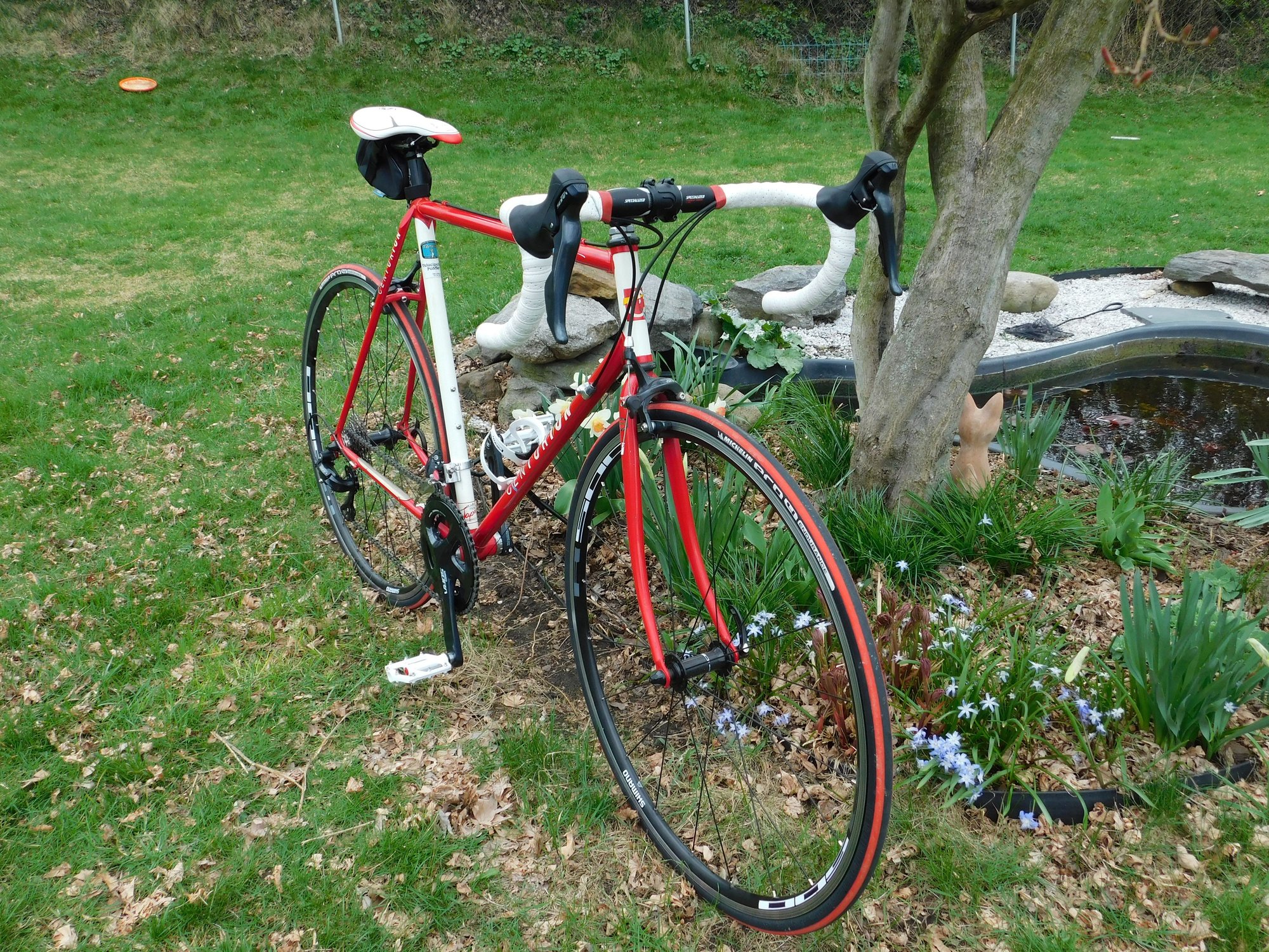

Here's my 87 Expert. Only original parts are the headset and the seat post binder bolt.
The upgrade to modern components was 100% worth it. I love riding this thing.
