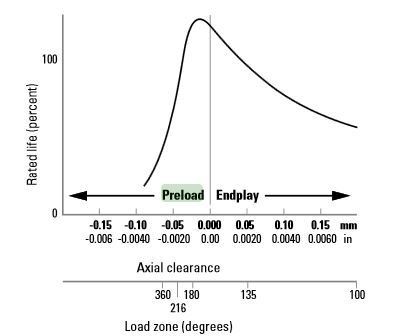

On the other hand, endplay means your hub is not contacting all the balls, with too much load on too few balls. It's not hard to achieve zero endplay with good technique.
And it's easy enough to avoid excessive preload. Hitting that sweet spot on the curve just to the left of zero is the goal.
