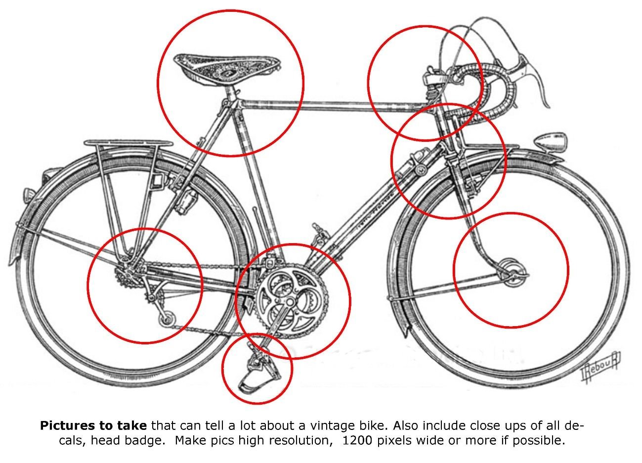

1986 Peugeot Triathlon vs 1988 Peugeot Biarritz
@mtarrant05 Your 1986 Triathlon probably has pretty mush the same frame as my 1988 Peugeot Biarritz except for the internally clamped seatpost and some cosmetic differences.
FIRST question, does the bike fit you? Is the frame size right for you?
FIRST word of advice, make some MINOR changes like cables, brake pads and tires, then ride the bike for awhile to see how you like it before sinking a lot of time and money into it. I recommend 700c x 25 tires at 90-100 psi for a real cushy ride.
SECOND thing, use this as a guideline for posting bike pictures online. It shows the most important points to photograph plus most importantly post photos of the DRIVE SIDE - the cranks and derailleurs as they are the most important features for discussing on a bike or to get help with.

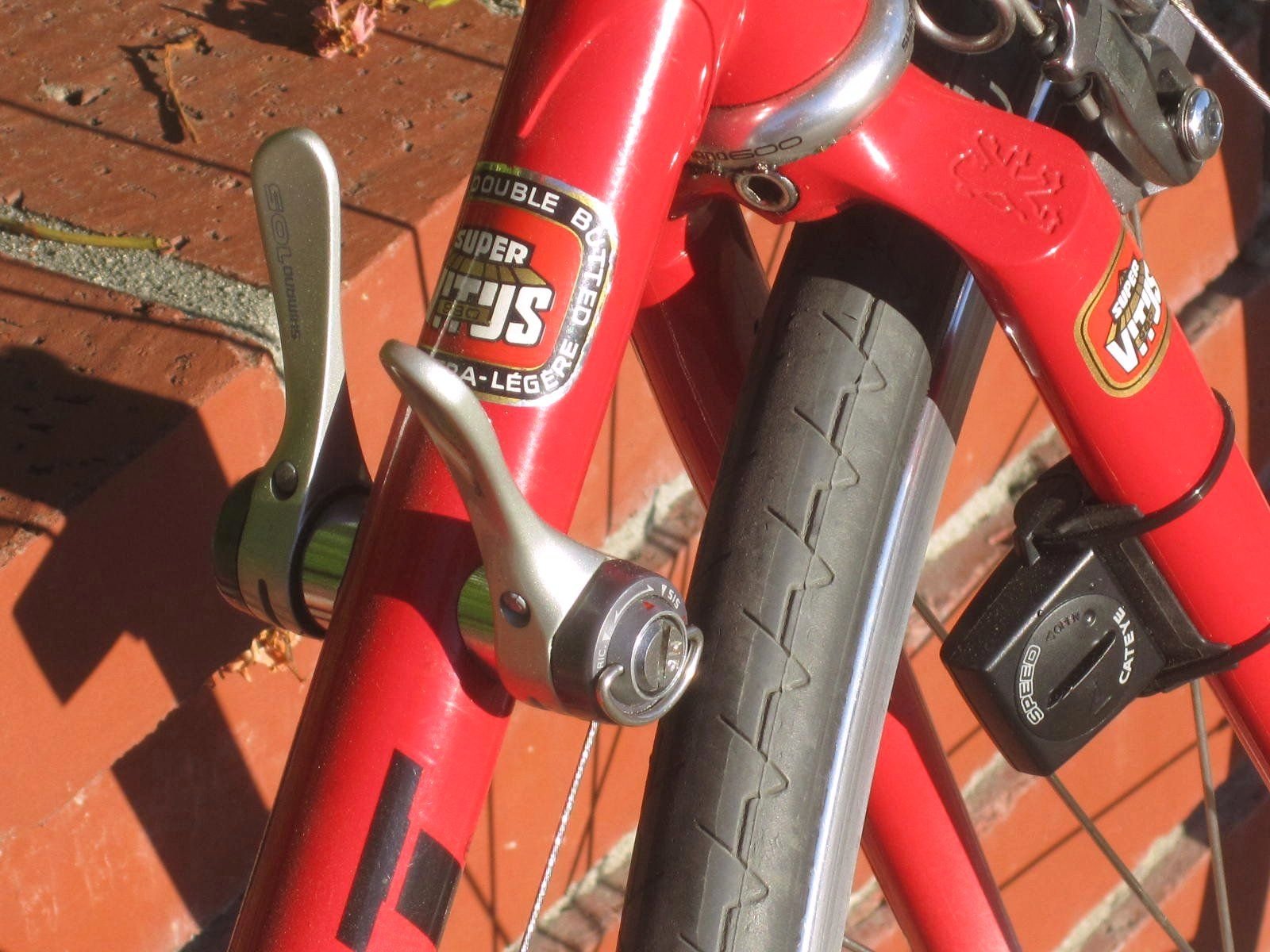

Old 08-31-19, 03:58 PM
mtarrant05
Join Date: Oct 2007
Posts: 52
Quoted: 12 Post(s)
Liked 3 Times in 3 Posts
Finally ready to roll!
New cables. Tires. Bar tape. Seat. Hoods.

Old 08-31-19, 05:21 PM
bertinjim
bertinjim's Avatar
Join Date: Mar 2012
Posts: 1,455
Bikes: 1970s Alex Singer, 1960s Peugeot PX 10, 1960s Bertin C37, 1973 Carre Bertin C 37, 1972 Carlton Kermesse, 1981 Peugeot PX 14 Super Competition
Mentioned: 65 Post(s)
Quoted: 346 Post(s)
Liked 266 Times in 157 Posts
mtarrant05-
Very pretty! Are those Campy lever hoods on Modolo levers? If so, how well do they fit?
bertinjim is offline
Old 08-31-19, 06:44 PM
mtarrant05
Join Date: Oct 2007
Posts: 52
Quoted: 12 Post(s)
Originally Posted by bertinjim
mtarrant05-
Yes! Fits great. Got them off eBay. Rustines.
