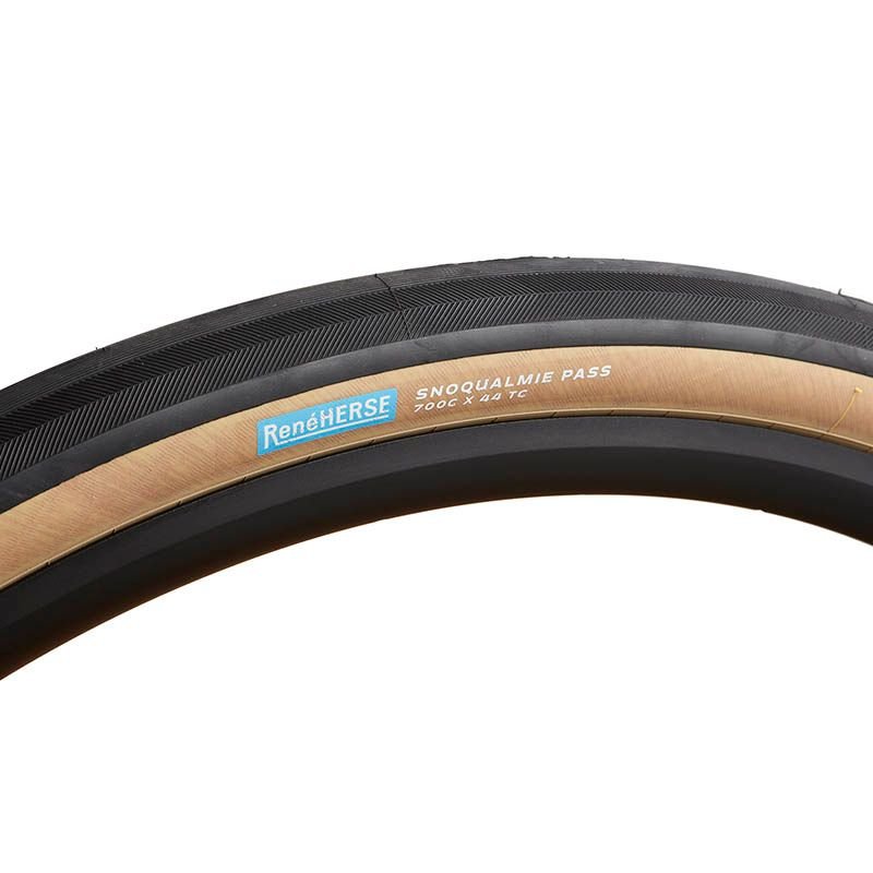

Yeah I am rolling on higher volume, softer tires. Currently have smooth 44mm but have ordered some 42mm knobbies that I have on my other bike and found they roll adequately on smooth pavement.
Current tires are 44mm, extra soft wall
This is what I run on my Trek FX, and have ordered a set for the 520 as well (42 mm wide)

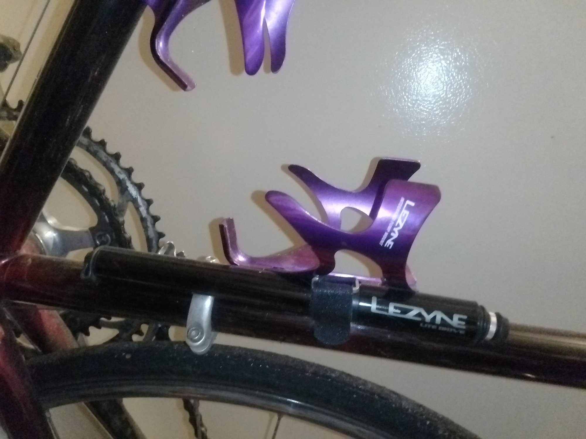

I picked up a Leyzene Road Drive cage at a huge discount from Sierra Trading Post and picked up a Leyzene pump online. I really like how the pump bracket is an integrated part of the cage and how the pump is set up to do presta or schrader. The small diameter of the pump is good for high pressure tires, but would slow down the amount of time it takes to pump up large volume tires.
Leyzene cage and pump

Some time back I wrote up a comparison of the Road Morph G and the similar Lezyne pump. These are the most popular for touring.
https://www.bikeforums.net/touring/1...l#post18521373
Without braze-ons, the best way to carry it may be in a pannier. I have carried either a Lezyne or Road Morph G on every one of my bike tours.
And if you are not carrying a pannier, an older style frame pump may work best. I have some older frame pumps and carry one of those on my road bike and sometimes on my rando bike. These pumps don't have gauges, often you just pump it up as much as you can and then use a better pump later when you have access to one.
In this photo, I have an old frame fit Zefal pump parallel to and below my top tube. That bike does not have a pump peg on the head tube, but I use a velcro strap near the front of the bike that keeps the pump from slipping down the headtube. I am not saying this pump is the best option, just saying it is one of many options.
If you do not have a water bottle cage on your seat tube, a pump like that easily fits parallel to and in front of the seat tube, that was the most common way to carry these pumps decades ago before people started putting bottle cages on seat tubes.
With frame pumps, the pump length is specific to a frame, the pumps are sold in different lengths to fit different size bikes.
Your question on CO2, I can't answer that because I have never used CO2.
Excellent solution! I like. Those Zephals are workhorses. Carry one of those and you don't need anything else. (Edit: for inflation. You still need the spare tubes and/or patches and probably tire irons. Those pumps are good but they don't do magic.) I lived car free riding sewups for a decade and used nothing but their predecessors.
I use the plastic clamp-on pegs Zephal makes (and I believe comes with the pump) on my bikes without HT pegs. Go one pump size shorter if you go that route. One Velcro pump strap for each of my bikes, run under the brake housing.
