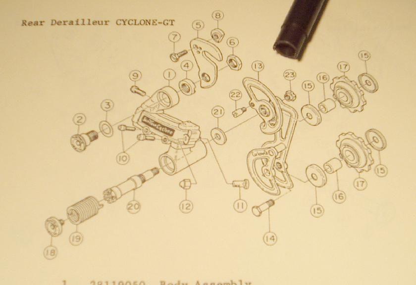

When I took apart this new to me Cyclone to clean it up I found two little black washers (shown in pic). I'm pretty sure they were sitting inside the pulley bushing cover, like the left one is set up. However when I put it together, it didn't spin well. Upon disassembly, I noticed the cover on the right had the washer imprinted. Do I need those washers (I also cleaned up a Cyclone Mk-II which didn't have those washers)? Where should they go?

Are the pulleys Suntour branded? If so, the small washers shouldn't be there. If not, then maybe they were an attempt to make something else fit.

I wonder if someone put those washers in there to spread the cage a bit?

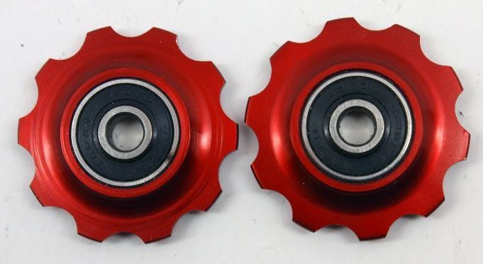

One possibility is that a previous owner may have had Bullseye Sealed Bearing Pulleys on that derailleur. The bearing width was about 8mm and they came with a bunch of extra washers to put on both sides of the pulleys to fit in 9mm or 10mm wide pulley cages.
When they removed the crazy expensive Bullseye pulleys they put some washers in the wrong place, inside the dust shields???
Real Bullseye pulleys are currently going for $75.00 on eBay!!! BITD we thought that they were exorbitant at $12 a set!
I have them on several old Suntour and Shimano RDs. Been using them since the mid 70's.
The reason why I spent the $12 was not the bullpucky crap about reduced friction but because they ran smoother than the original hard plastic Japanese pulleys which had sharp edges and took forever to wear in.
The aluminum Bullseye pulleys wore in quickly and transmitted less vibrations into the pedals (the Princess and the Pea).

...or perhaps trying to make the pulley into a floating pulley? This would be more likely if the washer is slightly smaller on the OD than the pulley bushing.
I did the same thing after upgrading a Suntour drivetrain with HG chain and cassette, and which helped accommodate the over-generous amount of overshift freeplay in the Command Accushift levers. I later discovered that simply using a narrower Shimano chain worked better overall.
I removed the cage and took out the washers, everything seems to be running well again - even the messed up dust shield seems not to cause any issues although I think I'll try to find a replacement before I install it on my '89 Voyageur.

The Cyclone I have is the GT long cage version. The Disreali Gears page shows a maximum cog of 32T, so I think I'd be fine.
I also have the Mk-II which is listed as being capable of 34T and which also might suit the era of my '89 Voyageur better.
I didn't catch the long arm pulley cage in your first picture or the parts breakdown.
That's a Cyclone GT model which came out in late 1975. My descriptions of capacities refer to the short arm original version. I'm going to leave them posted because the info may help someone else.
