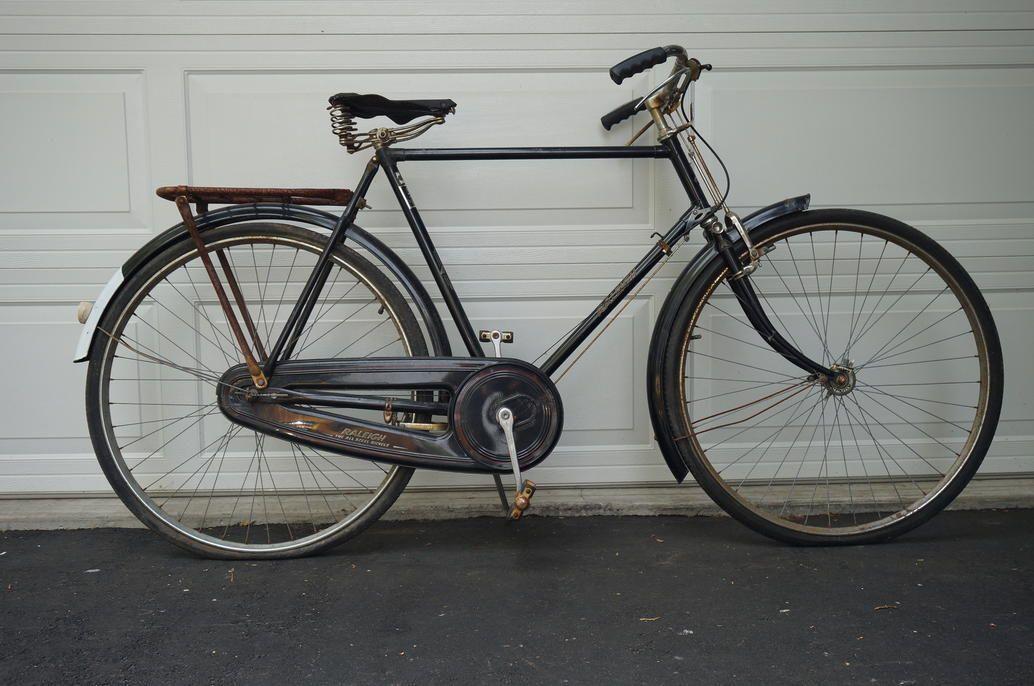

Yeah, I think you're right. Weird how the girl and the bike seem to occupy the same space, huh?
Also, if you look really close at an enlarged image, the tires do NOT appear to be even touching the ground.

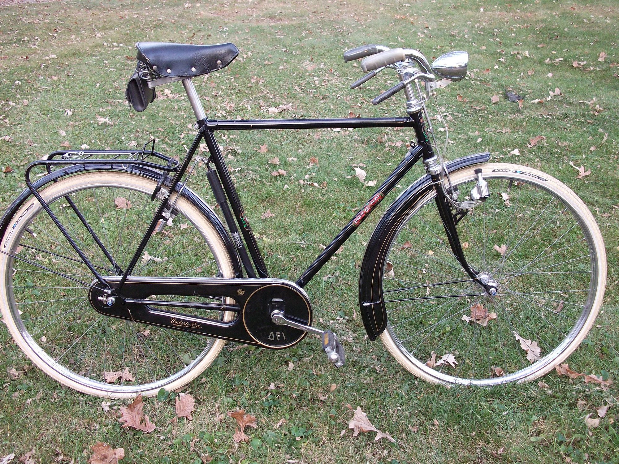

Beautifully set up Tourist! Could you give the details of the headlight, rear rack, and panniers?
I think some people get it, and some don't. Whenever I go for a spin on the Tourist I have a blast, but there is a definite mindset to it. I often take it for a spin around a local lake, but I also go on longer trips on nearby bike paths. A favorite ride was taking it to the woods about a half mile from my house. The guy on the fat bike I rode by gave me a pretty odd look!
In the two years I've had mine I've never had an issue with braking even having it up to 30mph going downhill. Proper set up, just like any brake.

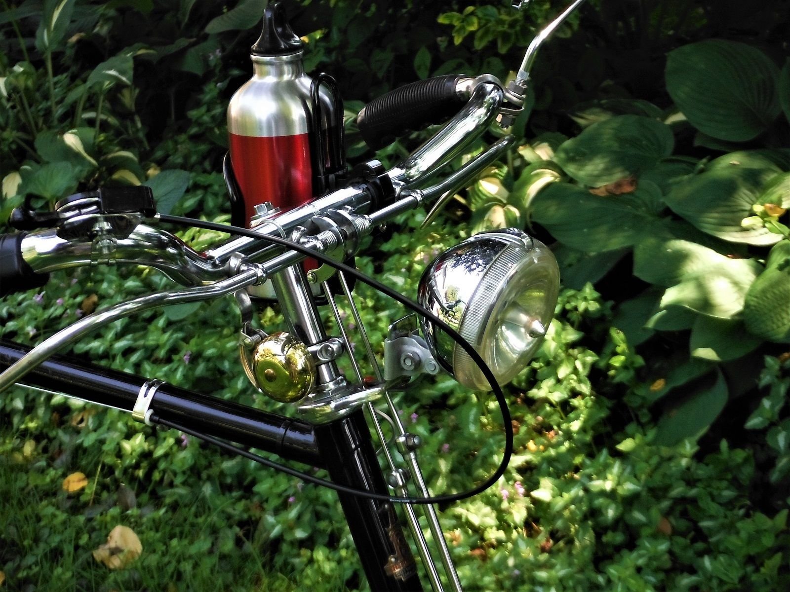

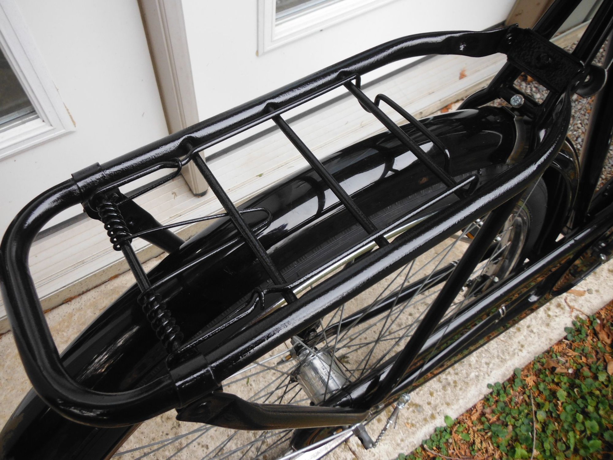

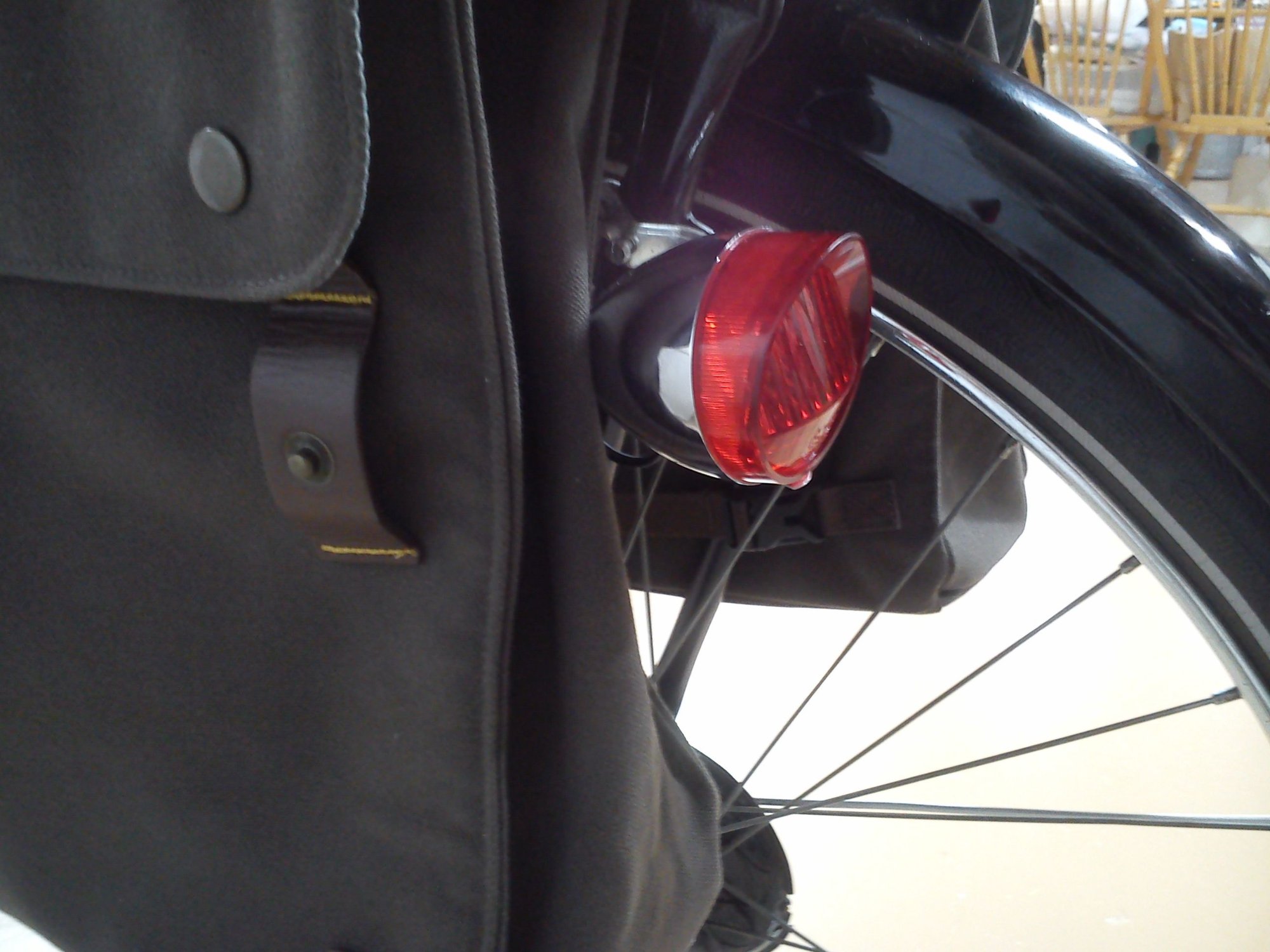

Thanks for the kind words. The rear rack was on the bike when I got it. Originally chrome, it was so rusty it could only be cleaned and painted I thought about painting it red, but settled on black. I assume it was dealer installed when sold in Hamilton ON in 1979. The headlamp is a Lucas unit a friend picked up for me at a flea market. A similar era taillight is installed on the rack. Both have been converted to LED and are powered by a homemade battery pack nestled in the newer Brooks B68. The panniers were a lucky find at MEC Sporting Goods Store. They are heavy canvas and store branded. There were matching tool and saddle bags as well. To bad they were discontinued as they were all priced below $70.
My next project is to replicate a Raleigh style battery holder on the seat tube. Since the photo I removed the bar mounted bottle holder and changed the mirror. Lots of room for a bottle in the panniers.
As found and purchased.
Rack was in poor shape
After vinegar soak , sanding and painting
Lucas lamp.
