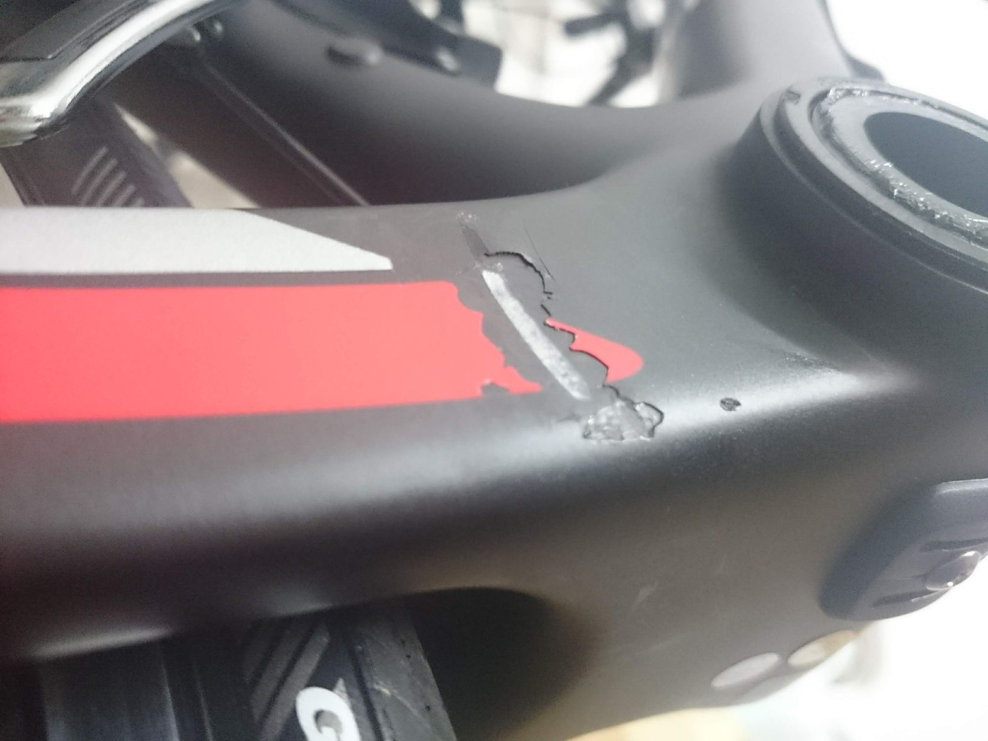

I bought a Giant TCR Advanced nine days ago and right on the 2nd ride I dropped the chain. It did not ring any alarm bells for me, since I did not pedal or force it (or so I thought).
Couple of days later, while inspecting the FD (it needs adjusting), I accidentally saw the damage hiding behind the chainring.
I own steel and alluminum road bikes, but this is my first carbon frame.
I'd like some of your opinions from experience. I assume it is not catastrophic, but should it be taken care of by a professional, or could I, maybe mask it and keep riding. (and buy a damn chain catcher). It is a very nice frame, but fortunatelly it did not cost a fortune.
Apparently, posting images is not allowed for new members, so If there is any other possibility, I'd be happy to share them.
Cheers!

Are you sure it was caused by the chain drop? That seems unlikely to cause damage.

The damage was not there when I got the bike, and since the winter arriving, and some cold I caught in the meantime, I did only 2 rides.
The dropped chain on the 2nd ride was the only memorable issue I had.
I'll try to post a photo URL without the prefix. You need to copy-paste it into your browser: imgur.com/m8aBUBE

Looks like the leading edge of the damage is on the lower edge of the chain stay....dropped chain, then sucked up into the chain stay on the next half turn?
Unless the chainrings were/are bent, what, besides the chain, would make that radiused mark?

Ouch. My first impression is it's probably fine, but I would have it checked out. That area tends to be built up pretty stout.

You are correct to be concerned. A friend destroyed a frame through multiple chain drops. Yes, he should have figured it out sooner Get a chain catcher and ask the shop if you should cover the damage to protect against future deterioration.

Most of the damage is just paint. There's a tiny spot at the bottom corner of the chain stay that may be a bit deeper, but I would not worry about it. I did something similar to my Colnago.

As someone who works with carbon fiber for a living, I'd clean up the divot-looking area to the bottom of the stay and then paint over it so that I forget it's there. In my experience, most carbon fiber things are fairly overbuilt. The chain drop mostly just abraded the stay which is far better than damage caused by impact.
YMMV.

Seems mostly cosmetic / paint damage to me. Except for that little deeper chipped area.
You could have it professionally inspected to be sure, but I imagine it is fine. They build some engineering tolerances into these frames.

Definitely get a carbon guru to look it over. The last thing you need is a catastrophic frame failure going 37 mph.

I already contacted 2 carbon repair places in my area (Germany) and asked for their rough opinion and a quote, based on the pictures.
Both agree that it is "probably" fine and could be treated by just sealing and painting the damage, but of course cannot give a definitve opinion based on the photographs alone.
Costs would be up to 250€ in case the carbon fiber itself needs repair.

Your bike is fine.
A "repair" for something like that is a joke. You can't repair carbon fiber without layering on new cloth, which isn't going to happen on such minor damage.
What you're going to get instead is a glorified bondo job. PASS.

What would you suggest for sealing the mark myself? It is in a well hidden area, but is also exposed to the elements. I considered removing any loose paint left, and applying some clear coating so I can keep an eye on it. After it dries maybe wrap some protective material in case I decide to drop a chain again.

Well, my Supersixes both came with one of these little metallic things stuck on the frame in that spot. I've never sucked the chain into there (knock on wood) but I imagine you could find something similar (if not this exact item) and stick it there to both hide the damage and protect the area...
Here's a random online picture where you can see it through the chain rings:
I might suggest painting a bit of black nail polish over all the paint irregularities and then (after a day to dry) swabbing with an alcohol pad before placing the protector...

Carbon fiber, like titanium, is inert.
It does not care about the elements.
Metal directly in contact with carbon is a different story, where the metal (not the carbon) is susceptible to galvanic corrosion due to the conductivity of carbon, but that's not the case here.
