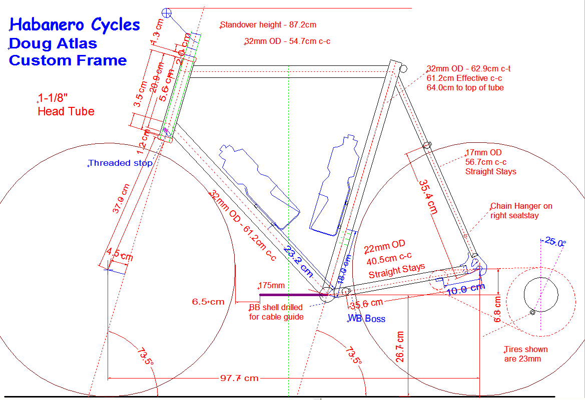

If you are really looking for used, see if you can find a classic Italian or Italian style steel road bike. They typically run short top tubes.

BTW you can go nuts with fit and geometry charts, so realize you will have to compromise and use your comfort as a guide. In case you, or anyone else with wacky body types like ours is interested, I am posting the schematic of my custom Habanero. Even this is a compromise, the head tube and seat tube should be slightly longer, but a longer HT would have severely limited my choices of forks as the streerer tube would be too short.

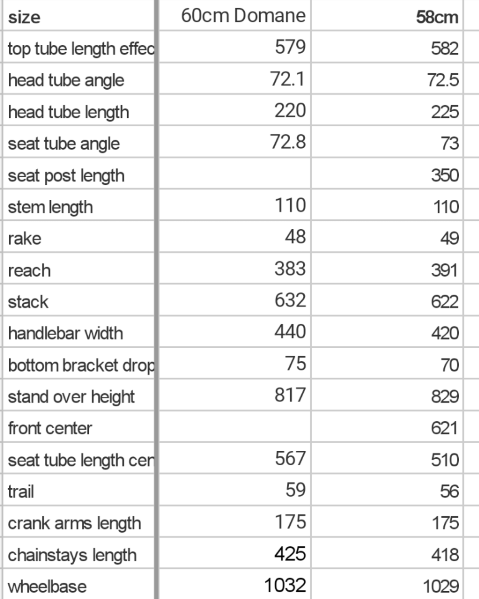

Took some measurements of my hybrid. Some eyeballing involved, but this was just to get a rough feel.
BB to ST top: 21 inches (53.3 cm)
BB to Saddle Top: 31.625 inches (80.3 cm, pretty much what the calculator said)
ST top to Saddle Top: 10.625 inches (27 cm)
I estimated the thickness from top of saddle to top of seat post was about 2 inches, leaving the seat post extending about 8.625 inches (21.9 cm)
Assuming that's not too far off, and the Secteur is indeed only 51 cm ST on the 58 cm size and to get the same height (both cranks are 17.5), I'd need an extra 2.3 cm to the seat post for a total of about 24.2 cm. If the post is indeed 35 cm, would leave about 10.8 cm on the tube, which seems fine? Only source I found said 15 cm or at least 9 cm as long as you are 2.5 cm below the bottom of the top tube.
Also tried to measure some of the reach dimensions, but since this is a hybrid not sure it is very applicable.
23.375 inch ETT (59.4 cm)
3.5 inch Stem (9 cm)
3.75 inch BB to Saddle setback (9.4 cm)
22 inch Saddle to Handlebar (55.9 cm)
Only, those dimensions aren't far off (recommended 2 cm longer stem and 1.5 cm longer setback, but that'd reduce the ETT by 3.5 cm to 56 which is almost spot on) even the Saddle to Handlebar is only off by about 1 cm.
Obviously, though, hoods on a drop bar are going to stretch me more. Roughly how much will the hoods stretch me out over flat bars?
am0n is offline

@am0n, have you tried a 60cm Domane yet?
We have very similar measurements(though flexibility might differ), so I understand what might work well for you.
noodle soup is offline
I was waiting for you to come yell at me. I have not. I was going to tomorrow, but they are closed. I did do a side by side on the 60 cm domane with the other bike over been taking about and it seems comparable. The smart move would be to wait and try out the 60 cm domane.
Edit: quick check of both bike shops websites and they don't have any 60 cm in stock.

Old 09-01-19, 10:32 PM
am0n
Join Date: Aug 2019
Posts: 149
Quoted: 98 Post(s)
Liked 13 Times in 12 Posts
Here is the side by side. What in particular would be concerning different between the two, besides the seat tube length.
am0n is offline
Old 09-01-19, 11:13 PM
noodle soup
noodle soup's Avatar
Posts: 8,851
Quoted: 4650 Post(s)
Liked 1,766 Times in 954 Posts
add 5mm to the Trek's stack to compensate for the lower BB.
Go ride a 58 cm Secteur, and a 60cm Domane. Then tell us what you think fits better ,taking into account that the fit can be adjusted slightly
I thought stack was measured from BB? Wouldn't that take into account the difference in the drop already?
my mistake
