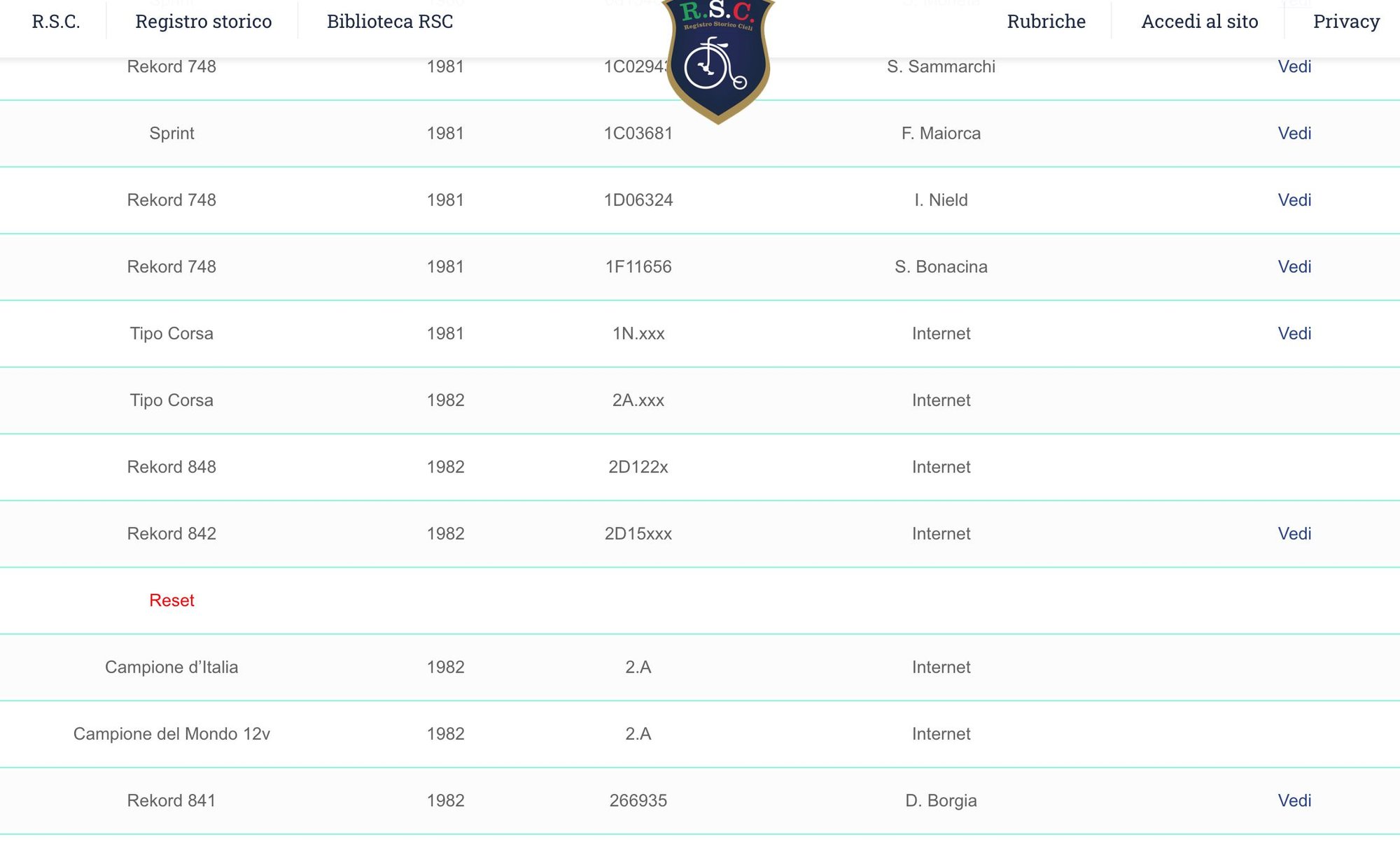

UPDATE: So, according to the Registro Storico Cicli, serial numbers beginning with 2A , as mine does, correspond to a 1982 Tipo Corsa. Any reason to doubt this?
Bianchi did not incorporate model identification into their serial numbers. The 2.A only means that it is a 1982 model, manufactured during January 1982. Your bicycle is definitely not a 1982 Bianchi Tipo Corsa
Grazie, as always, T-Mar.
In that case, is it possible that mine is a 1982 Rekord 842? I know — I keep going back to that. But the one listed above (2D15xx) links to a photo (https://www.flickr.com/photos/115217...n/photostream/.) A close look at the seat post indicates a diameter of 26.6 mm — just like mine. Same frame, then?
Yes, they are the same year and seat post size (26.2mm), so they would appear to be the same frame, though that doesn't necessarily mean they are the same model. It was quite common to use the same frame for two or three models and just change some of the components. I notice in this case that the the cranksets are different, The only major components that appears to be the same are derailleurs and Binchi could also have spread them over two models. The differences could still indicate a different model. I've said all along that it could be a Sprint or one of the lower Rekord variants. I'm just not sure which one, due to the fact that it appears to a European market model.
