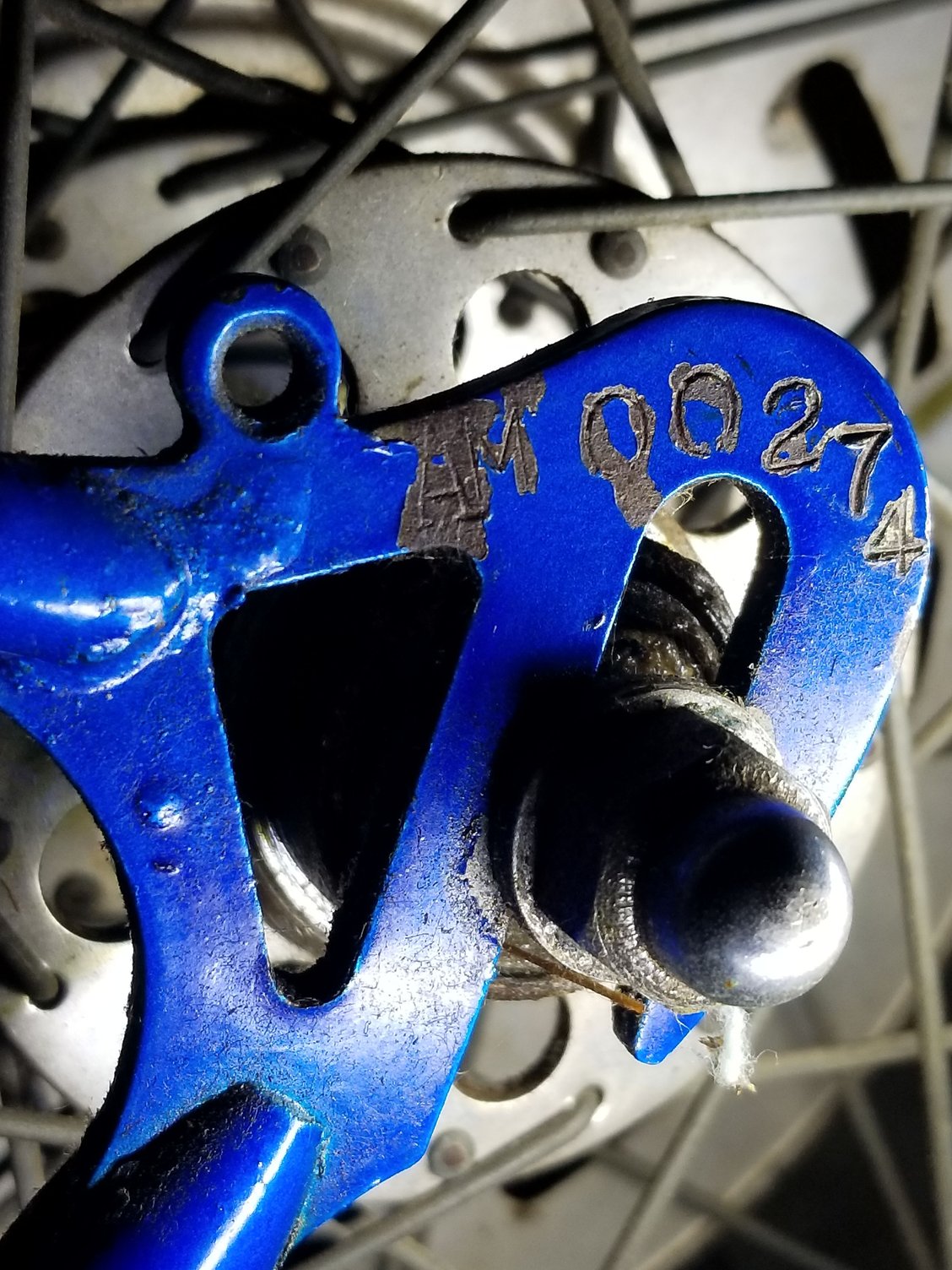

If this is illegible let me know and I'll post another.
myz34 is offline
There wouldn't happen to be another serial on the BB or any of the lugs, by chance?
-Kurt

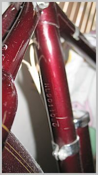

That's the only number I see on the frame. I found this on the Sheldon Brown website. Maybe I'm overthinking this?
Serial numbers are great when they answer all your questions, but sometimes they don't. Let the color scheme, decals, and components be your guide.
Color scheme, decals, and components, indeed everything, points to your bike being a Record, which was Raleigh's basic entry level "ten speed" bike from the late 60's through the 70's. The above quotes refer to much more expensive bikes.
There may be a date code on the underside of your saddle, typically one letter and two digits, such as C 73 which would mean July-September 1973. I think the Record came with a cheaper saddle, so this was an upgrade; but its date may tell us something.
The picture came up as Base64 code, but I was able to see the crop you pulled from the Retro Raleigh site. I'd avoid the serial charts up they have. They're old, outdated, and part of the reason I created my own charts (which are now old, outdated, and incorrect in some regards in their own right). The Nottinghamshire documents that these serials were based on have never aligned with actual production examples.
That said, your dropout serial may or may not be original, but the simple fact is that it doesn't fit within any existing system. Given that there's very little research on the Irish-built Raleighs of the time, I'd simply accept that there isn't enough information about them out there yet. In the meantime, you can rest assured that it's a Raleigh Record from 1973, 1974, or 1975.
-Kurt
-Kurt
Thank you. Now I know I can't do screenshots like that any more.
