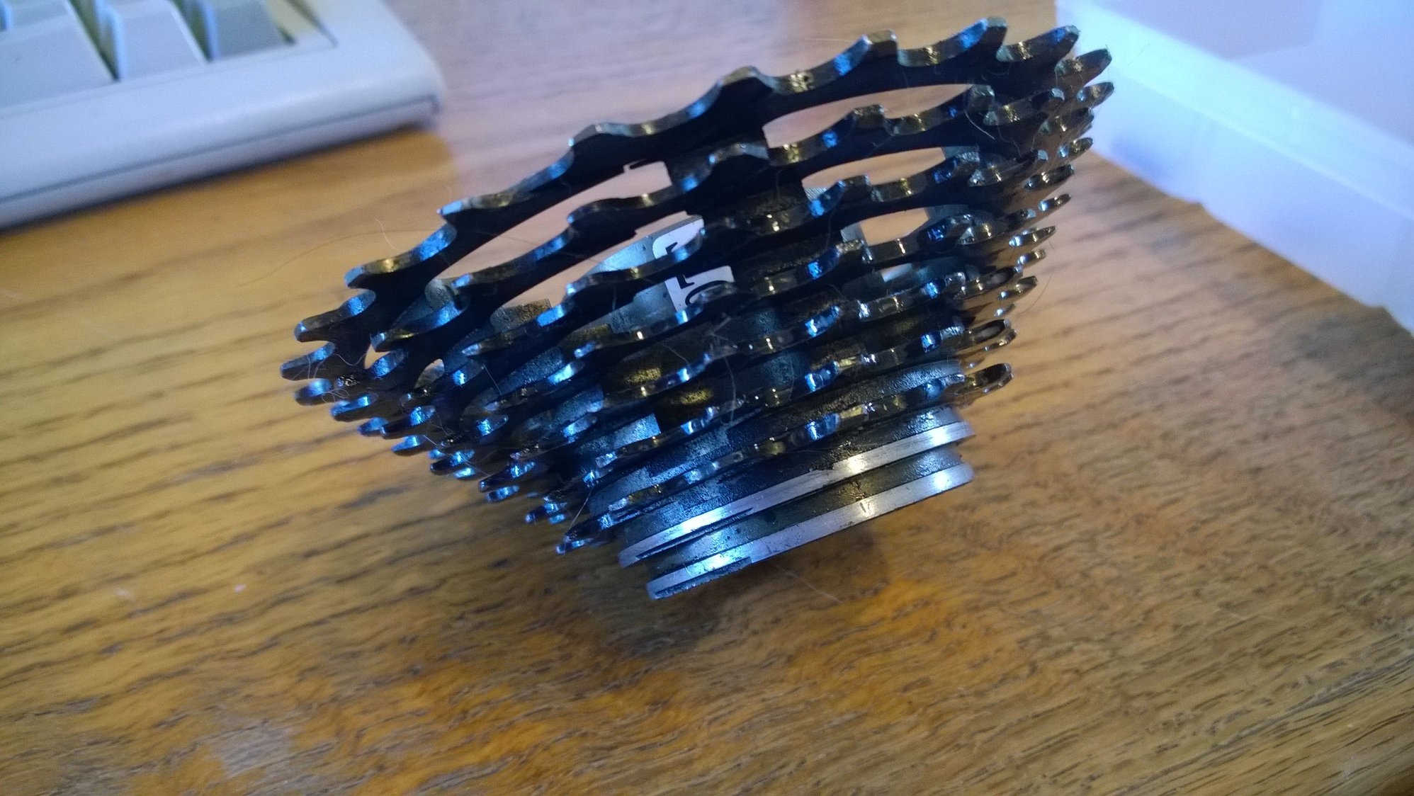

There are silly restrictions. More restrictions now.
The gear is going to generally be a 26' roll-out 52X14 or 53X14 or 45X12 which is fine for most on flats. The strong get spun out a bit, and some are better at 110RPM than others. That gear really hurts going down, and that is where coasting is better than spinning 130+RPM.
So they would take an 11-25, block RD and put spacers for the 12, 13 and just use the 14 on the normal front. That was 4th cog in. On my kids TT bike we could move the single ring closer to the stays.
The crazy types (me) would just grind the small cogs off for nationals and UCI events where you could not block the RD.
